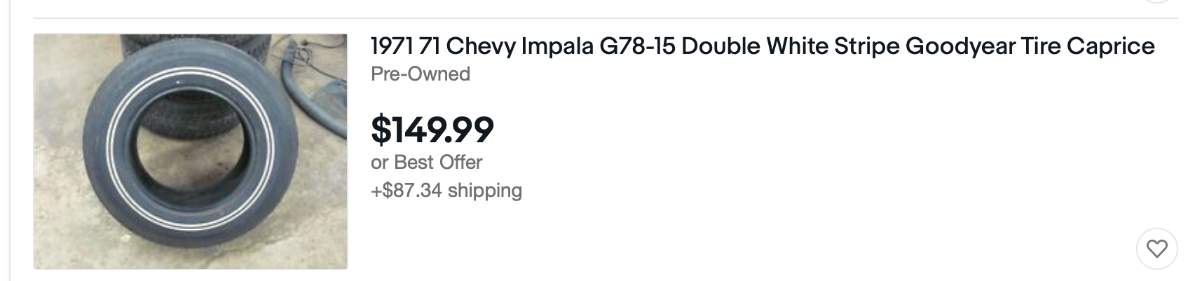

EVC Posted May 5, 2022 Posted May 5, 2022 9 hours ago, Searsman said: I have all the rally wheels including the spare for my 71.. but they need tires and I am interested in replacing the tires on them now with something that is close to the original . I may be wrong but I’m not sure they were radials back inthe day and this build sheet says they had a stripe. I’ve included a picture of that section. We’re they white or red stripped ? And what would be the best brand and type to get now? These would be a second set of tires and rims for the car. American racing wheels on there now..Thanks really appreciate input.. These are the tires that came on my original Monte Carlo.. I don't recall a big selection of tires… The SS came with the G70's … My car came with G78's double white lines… Back then tires weren't a big selling feature for the Monte.. I do recall when I switched to radials in the mid to late 70's,,, I held out in making the switch. I didn't like the feel of the ride and road noise… I felt like my Monte was on ATV tires.. The old bias tire I always felt was smoother on the open road to me,, but the life expectancy was 30,000 miles… Ed C Quote

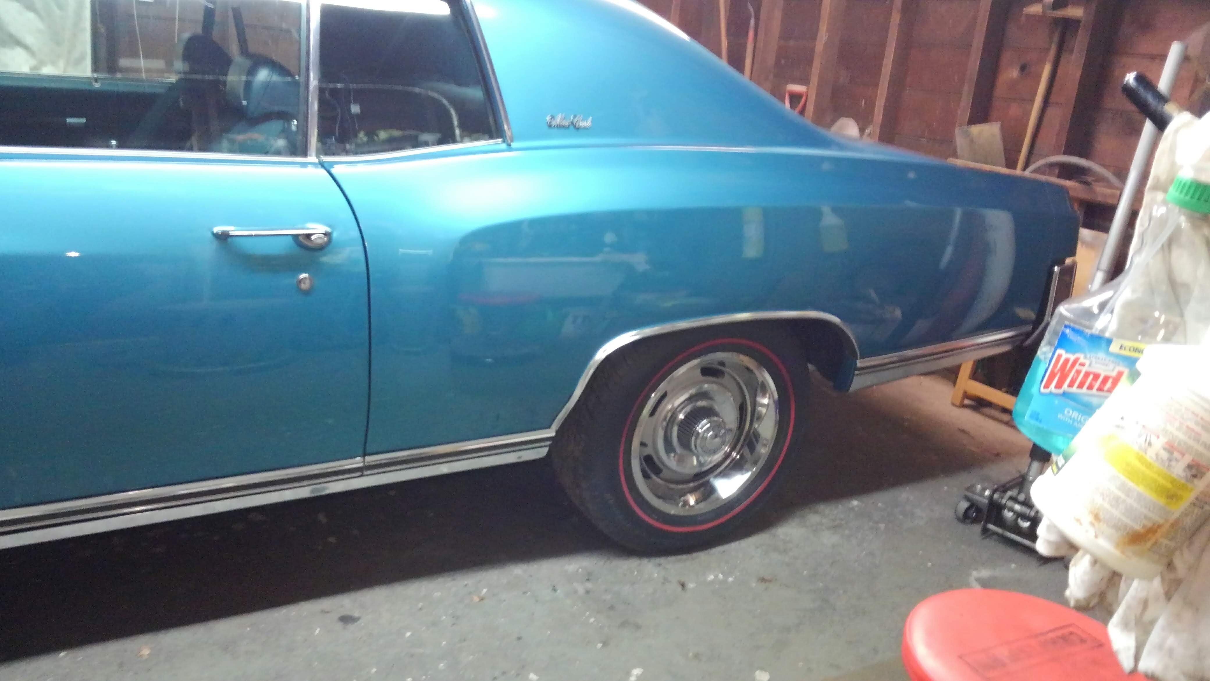

stangeba Posted May 5, 2022 Posted May 5, 2022 I ordered the rally wheels on my 71 (NON SS) and got Goodyear G70x15 small single WSW. Later I replaced them with GR70x15 Uni-Royal small single WSW. Since April 19, 2007 I have had COOPER 225/70R15 small single WSW. I didn't like the large black letters and found that I could purchase them from DiamondBack tire. We talked on the phone and they said they would grind / sand / polish them all off. Still got them 15 years later! $89.00 each plus $60.00 shipping. This picture is of my original spare. 3 Quote

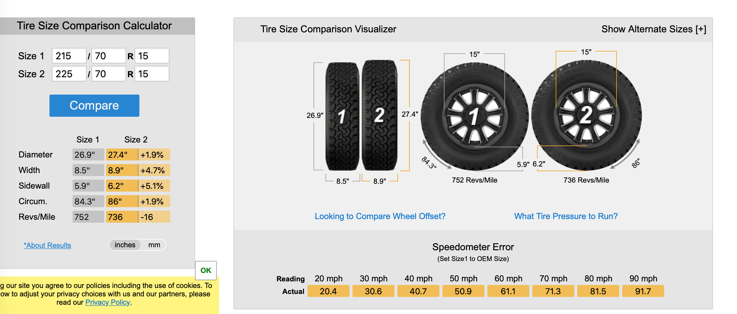

jft69z Posted May 6, 2022 Posted May 6, 2022 39 minutes ago, Searsman said: is the 215r70 much smaller than the 225?… 225 is about .5" taller and about .4" wider. This site is real good when trying to figure out tire sizes, comparisons, etc: https://tiresize.com/calculator/ 1 Quote

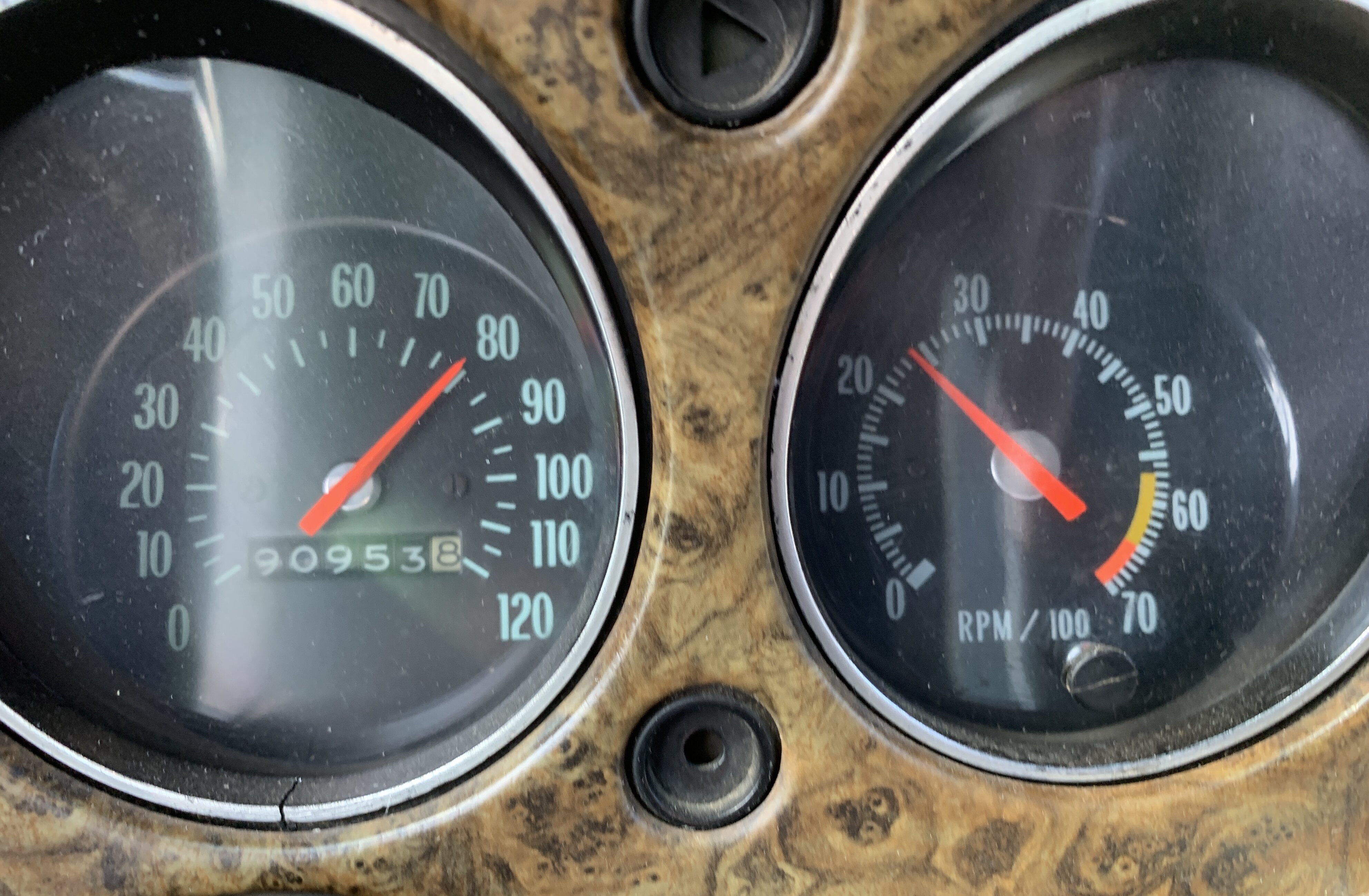

EVC Posted May 6, 2022 Posted May 6, 2022 3 hours ago, Searsman said: Ed, is the 215r70 much smaller than the 225?… no listings for 225 thin line Uniroyal. Thanks Ron . There isn't much at all… Maybe a half inch… the 215r70 and 225 are both almost identical to the G70… In fact, one article I read said the same thing …. Either one can be considered a replacement for the G70.. It's sort of a split between the two … I realized that and opted to go with the 215 because I have the taller gearing in my car anyway. It actually brought my speedometer back to being dead accurate… With the 225's it was a couple of mile off…. White walls in a quality tire are becoming difficult to find.. I've ran the 235s , 225s and I personally like the 215s better.. I have the 700r4 and at 80 I'm doing about 2400rpm… Quote
EVC Posted May 6, 2022 Posted May 6, 2022 3 hours ago, Searsman said: Ed, is the 215r70 much smaller than the 225?… no listings for 225 thin line Uniroyal. Thanks Ron . Ron here is a screen shot that shows the two tires side by side… Hope this will help… Ed .. Quote
