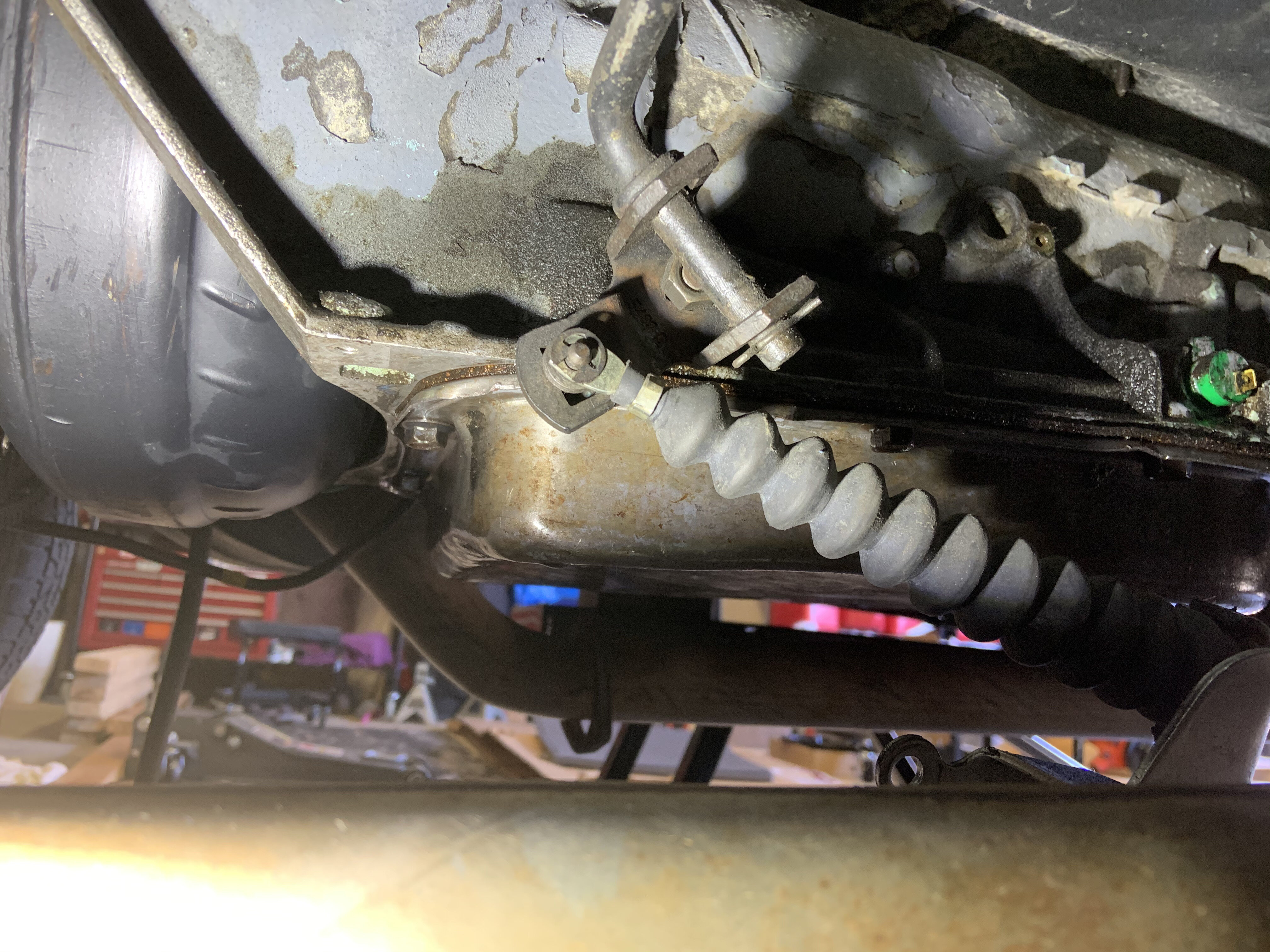

Would somebody be so kind to post a picture of how the automatic floor shift linkage looks under the car?
Thank you!

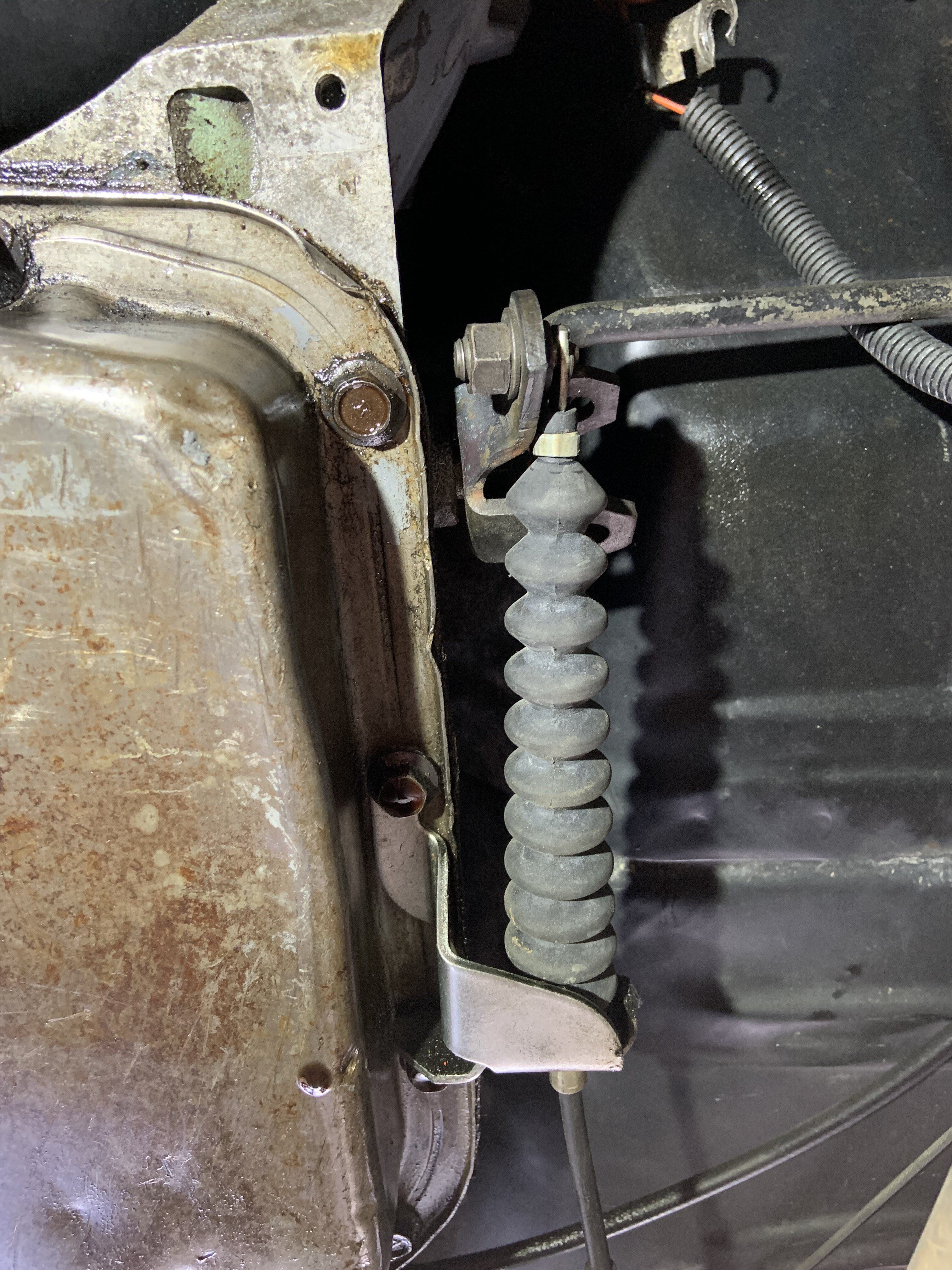

Thank you sir! I took mine apart two years ago and can't find my linkage. I ended up buying some factory replica parts and am trying to figure out how it all comes together. Does that rod  that comes off of the gear selector just stub into the bracket on the frame?
The "rod" in the 2nd (bottom picture) is the steering column lockout. I hope that's what you were asking.
Yes. I think there’s a spring on it, to keep tension on it.
