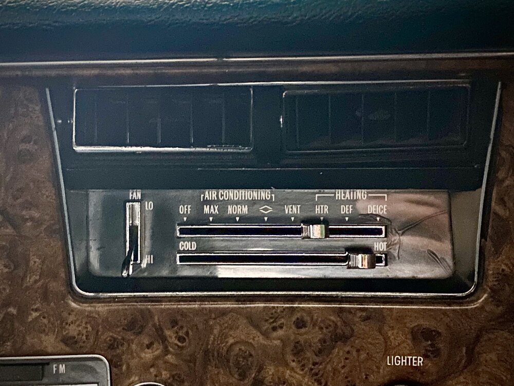

Crom Cruach Posted May 21, 2022 Author Posted May 21, 2022 Ok Haynes says 195° thermostat. What brand thermostat are you guys using, and what sealant? do you use a chemical flush? The old coolant is pretty black. dumb bonus question - should the fan be on heater / hi / hot like in this photo? Quote
