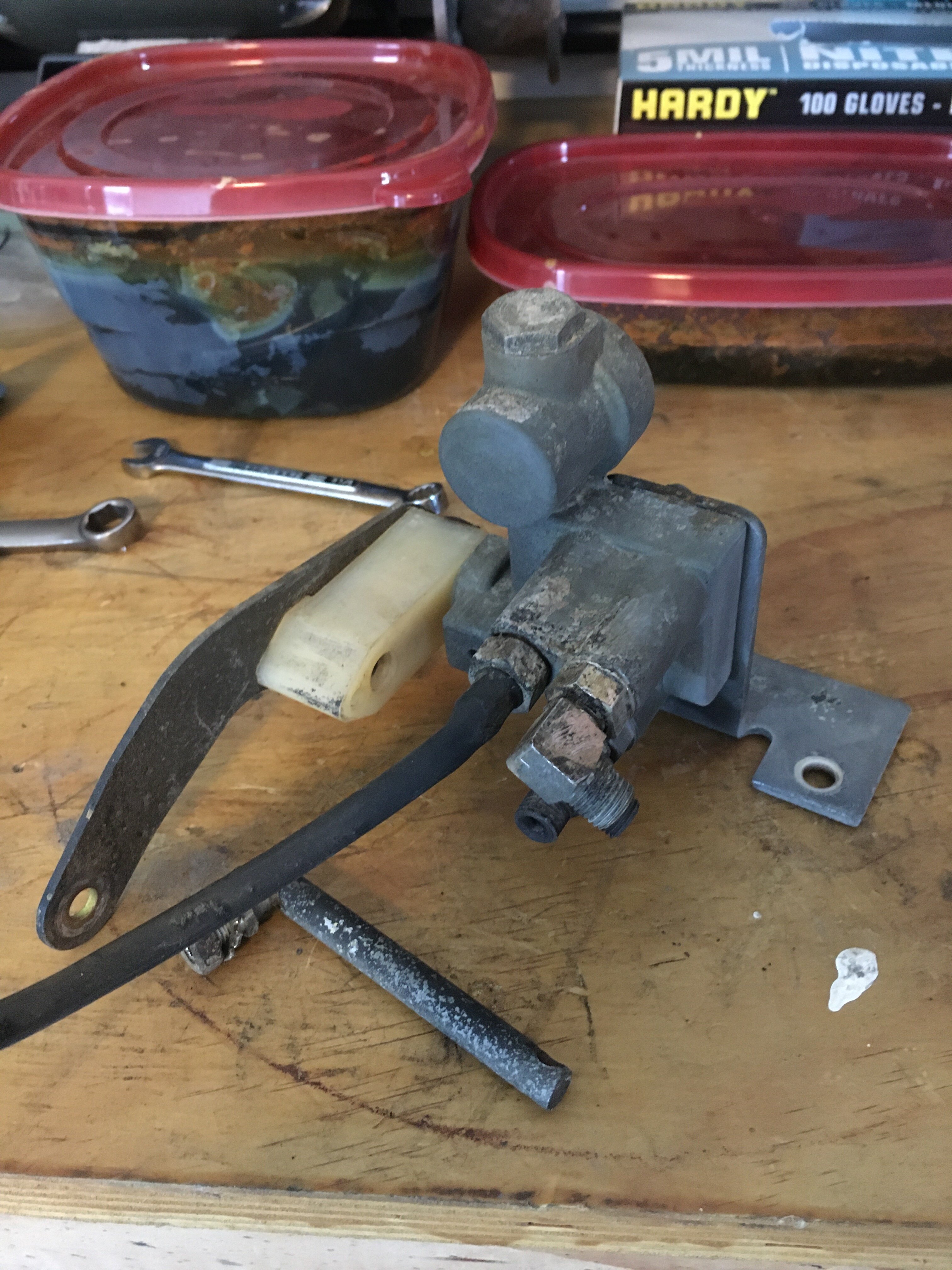

1Bad454 Posted June 1, 2022 Posted June 1, 2022 I am in need of the rod assembly for the air leveling valve. I will purchase the entire part if needed. Thank you Quote

overdrive Posted June 7, 2022 Posted June 7, 2022 The long, hex shaped nuts are called coupling nuts. The company I was getting the ball swivels from had shutdown when Covid hit, but I got more from them recently. When I restored our SS, I used new coil springs. Once the car was completely together again, the original ball swivel linkage was 1" too short. The back of the car must have been slightly higher than original, and with the original linkage connected, the valve was held in the exhaust position. The shock absorbers need a minimum of 25 psi, so I removed the linkage and operated the valve by hand, with the car sitting on all 4 tires, and put just a little air in the shocks. The bumper probably raised maybe an inch. I then measured and made a 4" linkage to replace the original 3" linkage. Since springs vary, anyone that's wanting to connect the valve to the linkage should do the same as I did and find out what length you need for the linkage. Keep in mind that the actuating arm on the valve has a slot for adjustment, but it's not alot of adjustment. Try it to see if your original linkage will work. Dan 3 Quote
