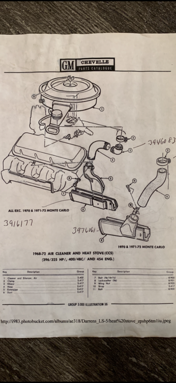

Glen Posted June 12, 2022 Posted June 12, 2022 9 hours ago, Rob Peters said: Yes they are. I think the Big Block is a flexible type tube and the Small Block is a metal tube rob Sounds right from what I’ve seen and read regarding the big blocks having the flexible tubing. What I recently learned is that our Montes use just a clamp to hold the tubing on the snorkel, whereas Chevelles have a 90 degree plastic elbow between the tubing and snorkel… 1 Quote
Glen Posted June 12, 2022 Posted June 12, 2022 Hell, upon looking at the diagram again it says that “ALL EXCEPT MONTE CARLO” use the plastic elbow 🤷🏼♂️ 1 Quote
