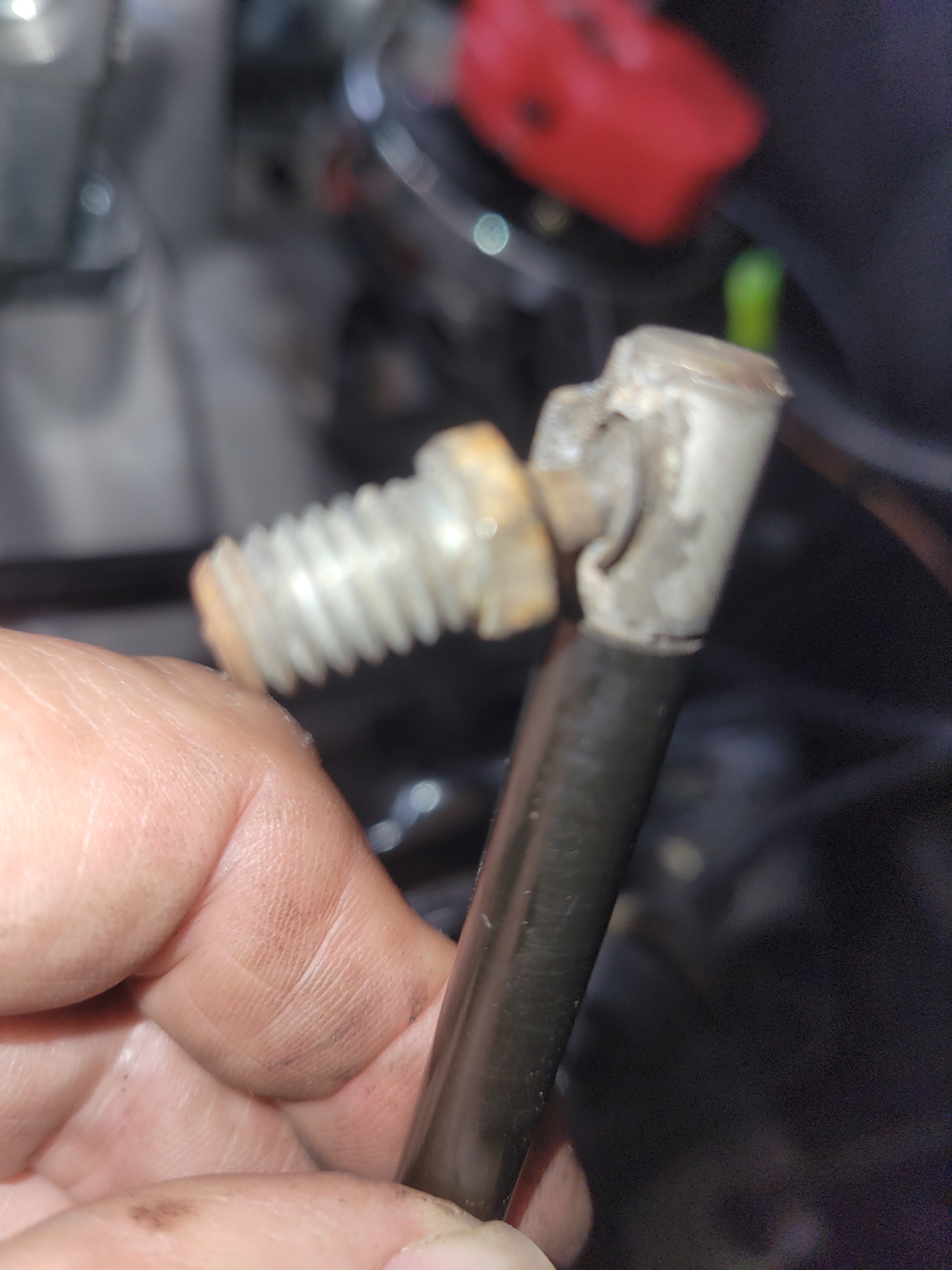

BobW Posted November 30, 2022 Posted November 30, 2022 OK, I've ditched the spreadbore manifold and Holley in favor of a dual plane manifold originally sold by JEGS and a rebuilt Edelbrock 600 cfm. I have 2 questions on hooking up the carb. First, does the throttle cable just unsnap from the swivel ball? I have a new ball that bolts on the edelbrock, or do I have to drill the linkage to use the old ball? Second, I see where the kickdown cable adjusts, does it get set so it's at full travel with the throttle at full travel? This is where it was adjusted on the 2bbl carb. The new setup, almost done! Quote
MC1of80 Posted November 30, 2022 Posted November 30, 2022 Yes. The Ball pops out of the cable. Transmission cable gets adjusted the same way. You may need to make an extension for the cable to work. 2 Quote
BobW Posted November 30, 2022 Posted November 30, 2022 7 minutes ago, MC1of80 said: Yes. The Ball pops out of the cable. Transmission cable gets adjusted the same way. You may need to make an extension for the cable to work. Thank you! 👍 I suspected as much, didn't want to start ripping and tearing indiscriminatly! 😉 1 Quote
