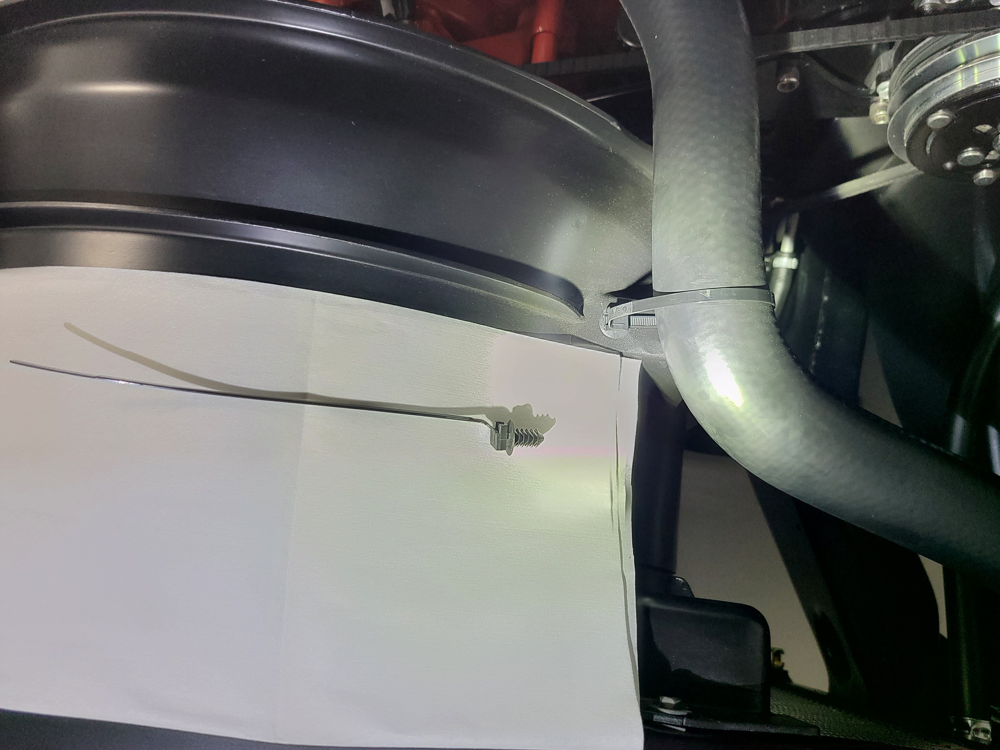

jft69z Posted March 5, 2023 Posted March 5, 2023 10 hours ago, TheBMan said: I realize this is an old thread but I stumbled across it while looking for something else. I could not find a source for the upper hose tie down strap but I did use these on my 72, which worked very nicely. They have a built-in push pin that fits the hole in the shroud and then you just use it as any other cable tie. Slick! https://www.amazon.com/gp/product/B0936L1ZFF/ref=ppx_yo_dt_b_search_asin_title?ie=UTF8&psc=1 I actually have those in stock, and tried it at the time this post came out. Wasn't perfect, but they're better than nothing? In my case the Amazon one was a little short, so I added a regular zip tie (hidden underneath) to extend the reach & make it work. If they made them 10" long, it would have been perfect. These were the ones I ordered, and were also 8.3" (210 mm) and unfortunately, the longest offered: https://www.amazon.com/gp/product/B07CBNZTNB/ref=ppx_yo_dt_b_search_asin_title?ie=UTF8&th=1 I haven't decided if I'm going to keep it on there yet... 1 Quote

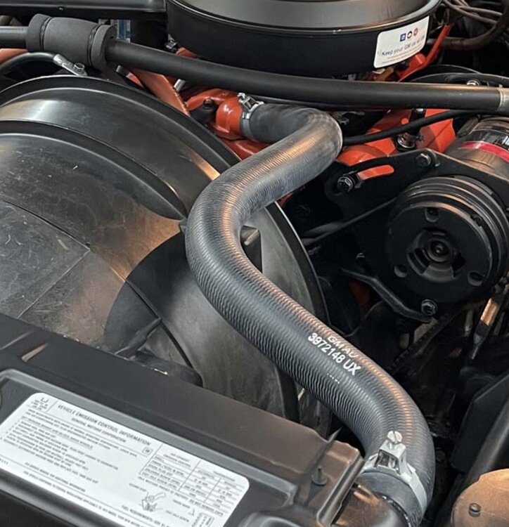

TheBMan Posted March 5, 2023 Posted March 5, 2023 27 minutes ago, jft69z said: I actually have those in stock, and tried it at the time this post came out. Wasn't perfect, but they're better than nothing? In my case the Amazon one was a little short, so I added a regular zip tie (hidden underneath) to extend the reach & make it work. If they made them 10" long, it would have been perfect. These were the ones I ordered, and were also 8.3" (210 mm) and unfortunately, the longest offered: https://www.amazon.com/gp/product/B07CBNZTNB/ref=ppx_yo_dt_b_search_asin_title?ie=UTF8&th=1 I haven't decided if I'm going to keep it on there yet... I wonder if there are slight variations in hose manufacturing. The hose on my 72 sat in perfect position for the zip tie to wrap around the hose and push into the hole without the gap like yours; it was a perfectly snug fit. Here's a picture before I installed the zip tie (the only picture of the hose I could find). It looks like the hose sits a little more 'left' than yours. Quote
