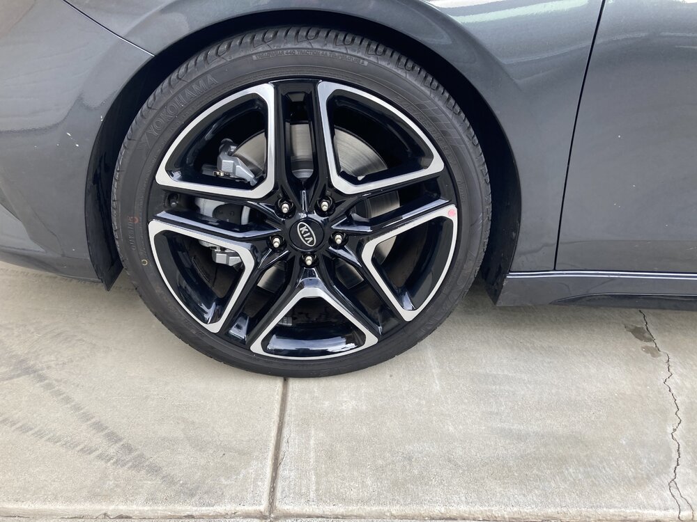

I’m not sure yet. Every brake upgrade I have done used OEM components. I’m just concerned about issues and overall function. I worked in a street rod shop for a few years that did a lot of willwood kits and none of the cars stopped good after they were done. I know the majority of the problems had to be installer error.  I just finished the front brake setup on my commuter KIA 2022 Forte GT using all OEM parts and it works perfect. 2022 Hyundai Sonata calipers, Veloster N 13.6” rotors and Kia k5 brake lines.  3C2780A1-BAF3-435C-90B6-75D4184C74FA.thumb.jpeg.292084f3d70f27e95dd0a1629250ac98.jpeg
