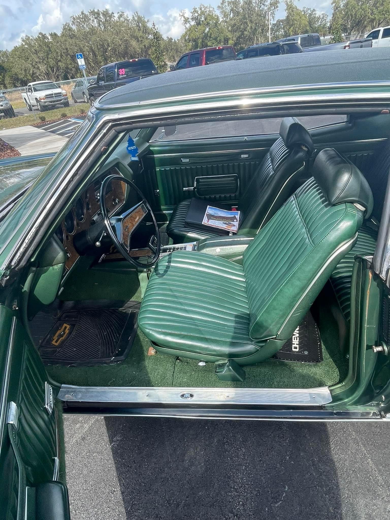

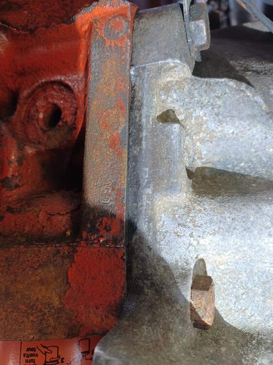

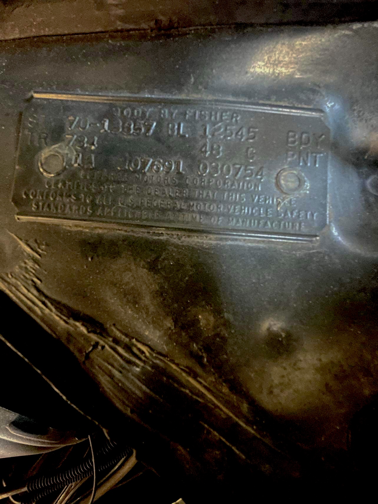

Some pictures….hard to tell what first digit is on build date….owner says he thinks it 11a. With an engine build date of 1025 that seems reasonable.
I agree. That’s a first week of November build with a 25 Oct dated motor.
Does she still wear her Forest Green paint and have Dark Green vinyl buckets per the trim tag?
Also, she was Van Nuys built, so see if the seller has a Build Sheet to corroborate everything.  And like Dennis said, take as many pictures as you can and we’ll do what we can to dissect what’s presented versus what the seller might be saying.
That “CRN” is correct for a ‘70 SS 454/360. If you can get under the car, see if the partial VIN is stamped on the pad near the oil filter and if so, if it matches the VIN plate. Check for the trans tag and date stamp on the differential, also.
And DEFINITELY check out the “How to tell if it’s an SS” section here within.  It’s a treasure trove of facts which will help you authenticate the car.
Good luck and keep us posted!
Gary the blue sticker on the drivers door also has the build date on it. Like Glen said Good Luck and keep us informed we Love this stuff!!!

Picture of VIN at oil filter location is hard to see but can see the last 4…7060
Car is Forest Green with green bucket interior. Green v/top

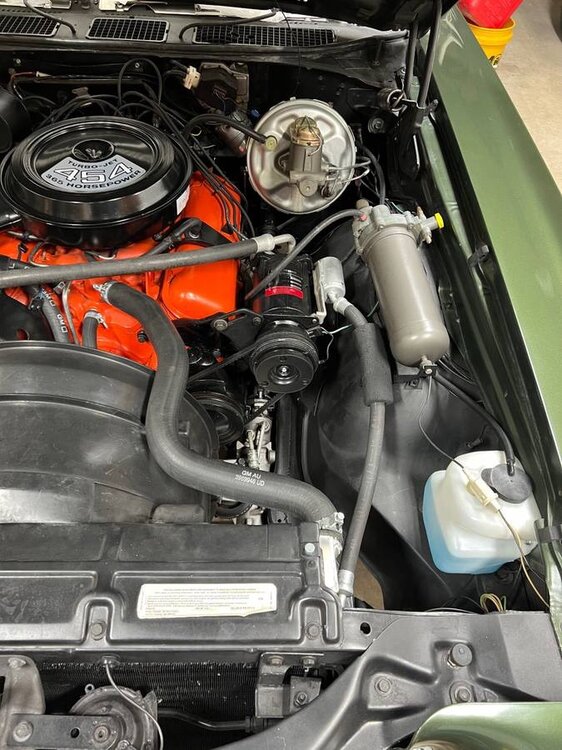

Nice lookin car. 454, air cleaner, and fan shroud look to be correct. I don’t see the air ride compressor. Or the holes for it. More pictures please.

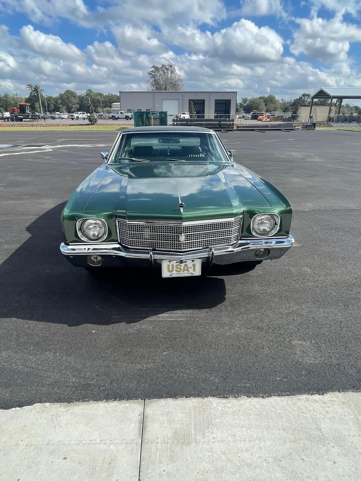

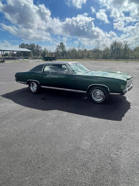

3 - it’s an early build Van Nuys car as evidenced by the halo vinyl top.  Does she have the chrome moldings under the headlight bezels?
4 - if you wind up buying her, the first thing you need to do is drive to a gas station. Not to fill the tank, but to buy a PINE air freshener… it’ll match the interior - hell, it’ll match the entire car - perfectly as opposed to that blue one currently oozing smell good all over the cabin 🤣🤣
  • Haha 1
Also… am I seeing things?  Is that a ‘71 hood ornament?  Or is it just pixelation?  Not a deal breaker if everything else checks out. But like Dennis mentioned… no air ride tank present nor indication of it being mounted on drivers side inner wheel well (could have been replaced).  Does she have the boxed control arms?  Shock protector plates?  Yes… lots more pix are necessary.
Posted (edited)
Yes VIN ends in 7060. Boxed control arms are present.  Yes it has 71 hood sphere. Owner didn’t look for build sheet.  Chrome molding under headlights I think I see in picture.

The engine picture doesn’t belong here….it’s a different car…. I was looking at the difference in the AC compressor brackets.

Woulda loved to see that hood open with the engine purring in that video.  Is the seller including those aftermarket wheels and tires?  Always good to have a spare set. And why did he change out the air cleaner? Kinda weird.  Was also nice of him to locate and install the air tank for you. Very cool that he’s including the windshield fluid monitor in the sale!  Glad he removed the caution sticker from the fan shroud - very unsightly IMHO. Paint looks to be a different shade of green… must be the angle/sun/time of day 😉
Obviously I was being sarcastic regarding the extra engine pic. Looks like you're about to score a very nice car. Good luck with the sale negotiations and keep us posted when it’s a done deal (and more pix!).

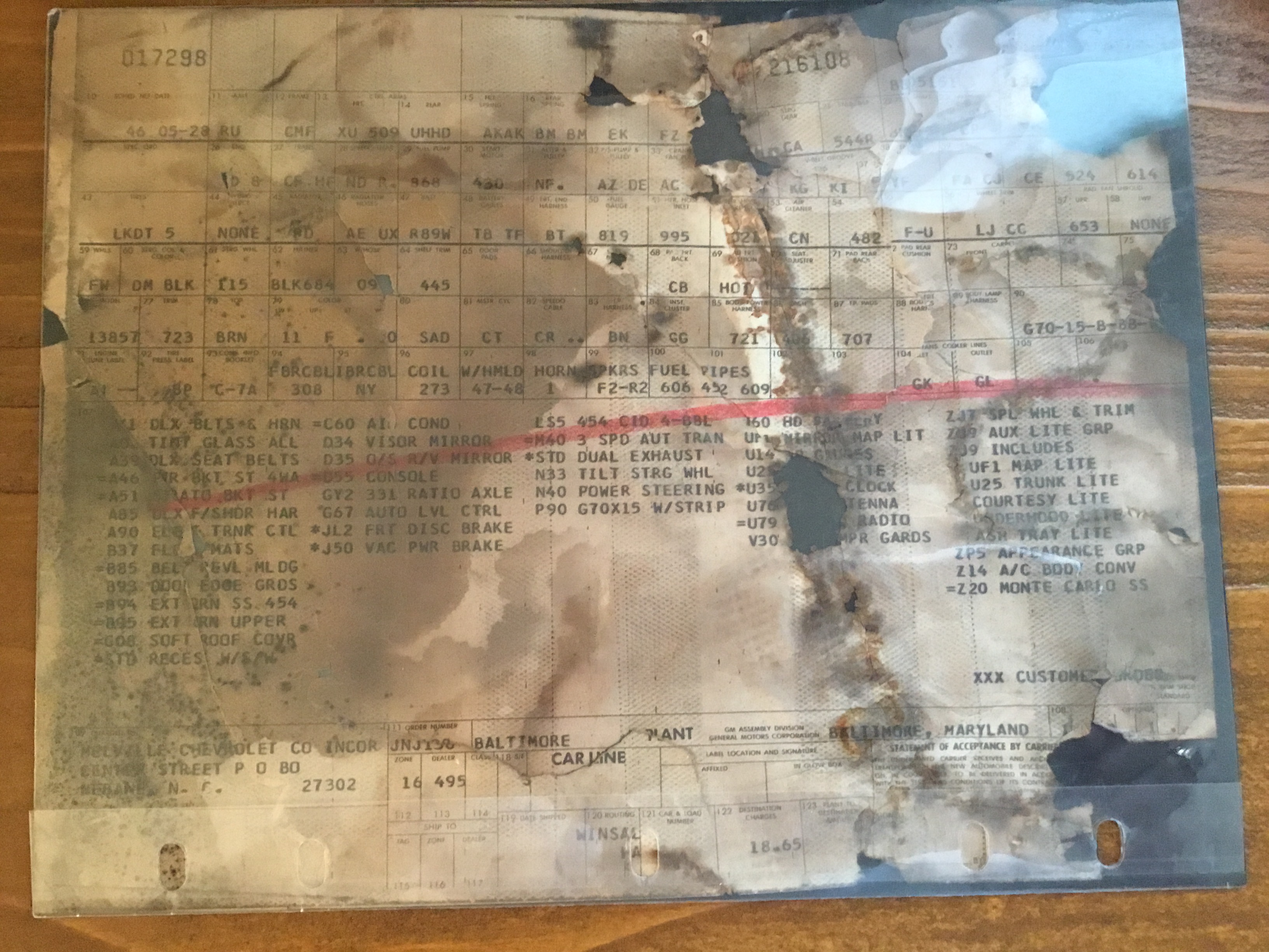

Hi Lyle,
This is a build sheet from a 71 SS I had many years ago. Thanks for putting this registry together.
Sammy
They sure didn't miss many boxes when to ordered that one.
Wish you still had it?
you happen to know the VIN on it. Hard to see part is missings. Colors?
Thanks; Lyle
