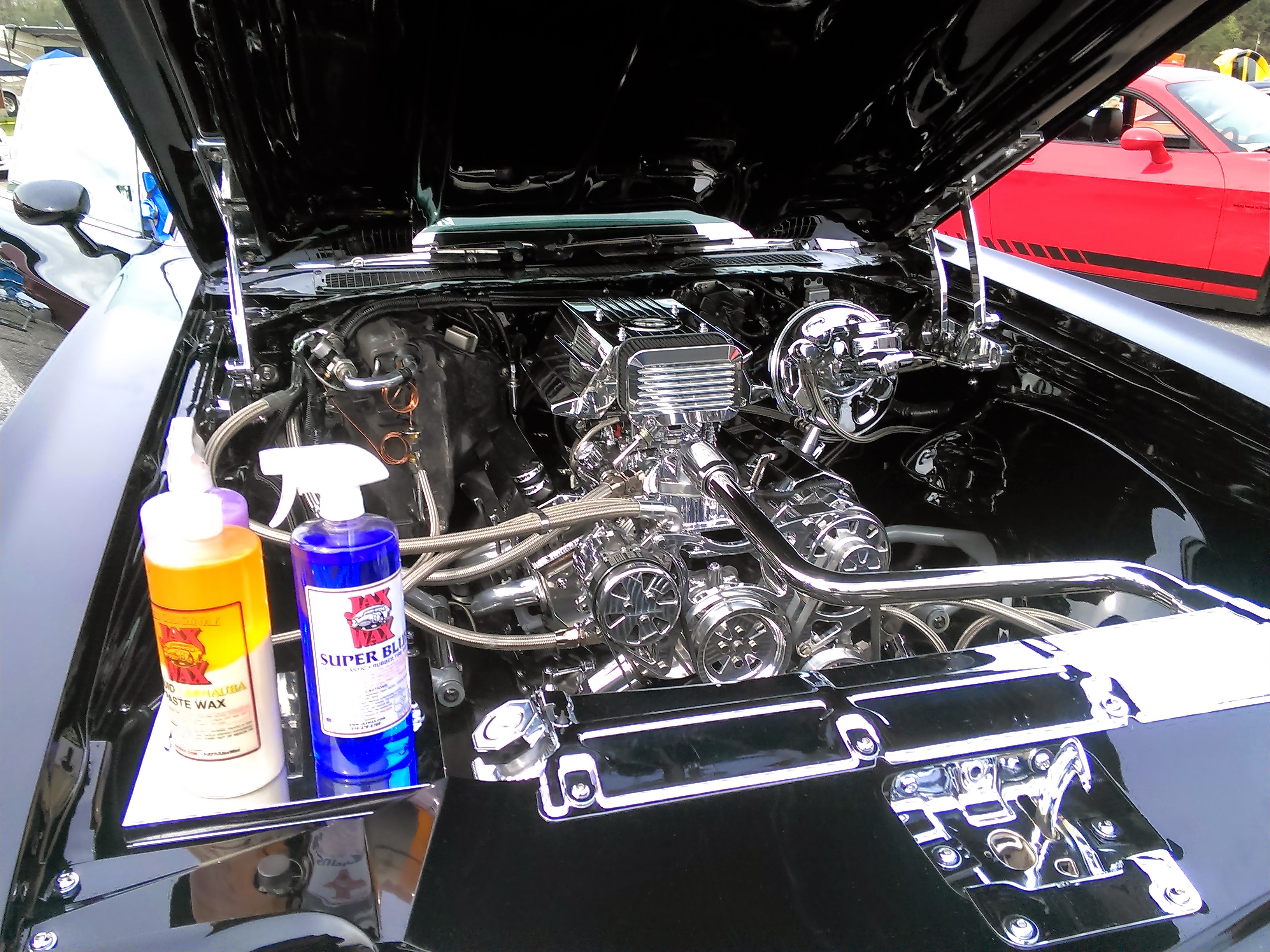

Anyone using billet hinges that they would recommend?
IMG_20150412_104151.thumb.jpg.be5b97d69bb514744de73cba28813dfb.jpgWe went with the Eddie Motorsports full polished billet hinges, The hinges are fantastic. We preferred the solid construction of the Eddie Motorsports as opposed to the Ring brothers with the cutout circles. Make sure that you order the right size struts( based on the weight of your hood ) and with a little elbow grease they too will polish up quite well .

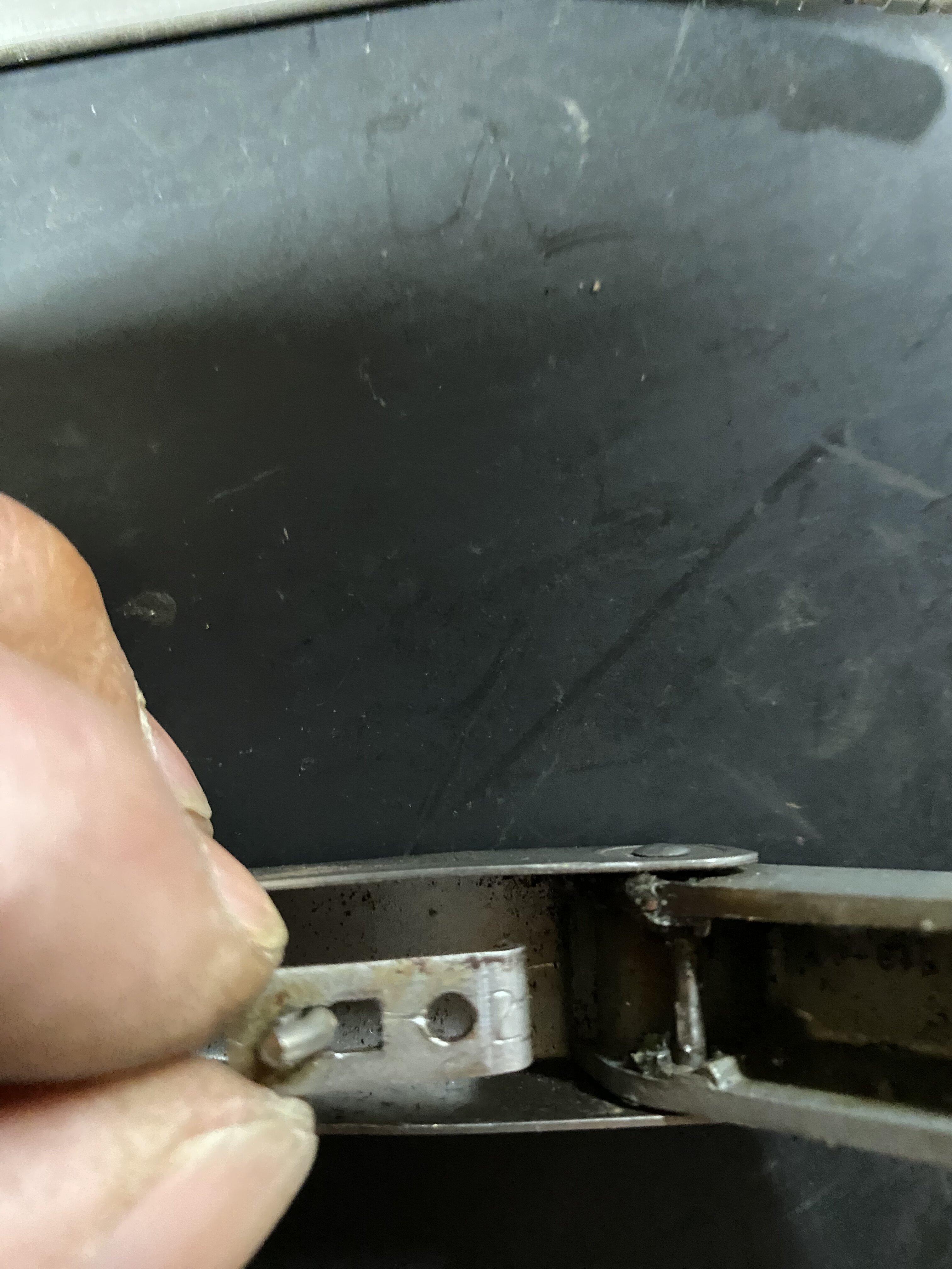

That's right Joe. Had a bad experience with mine. But Eddie Motorsports sent me a new set. There is a small 1/4" bolt at the lower side of  lever that gave way and broke. I have not set those back up since I'm putting in my BBC. They told me if I had anymore issues with them to let them know. To me they are built very well, just didn't understand why it did what it did. The hood had been opened and closed countless times. I'm getting my old hinges redone just for back ups. If your on a tight budget ,these are not the way to go.$$$ is the deal. I used up all my recognitions from work to buy these, kind of a present for the Monte and me.

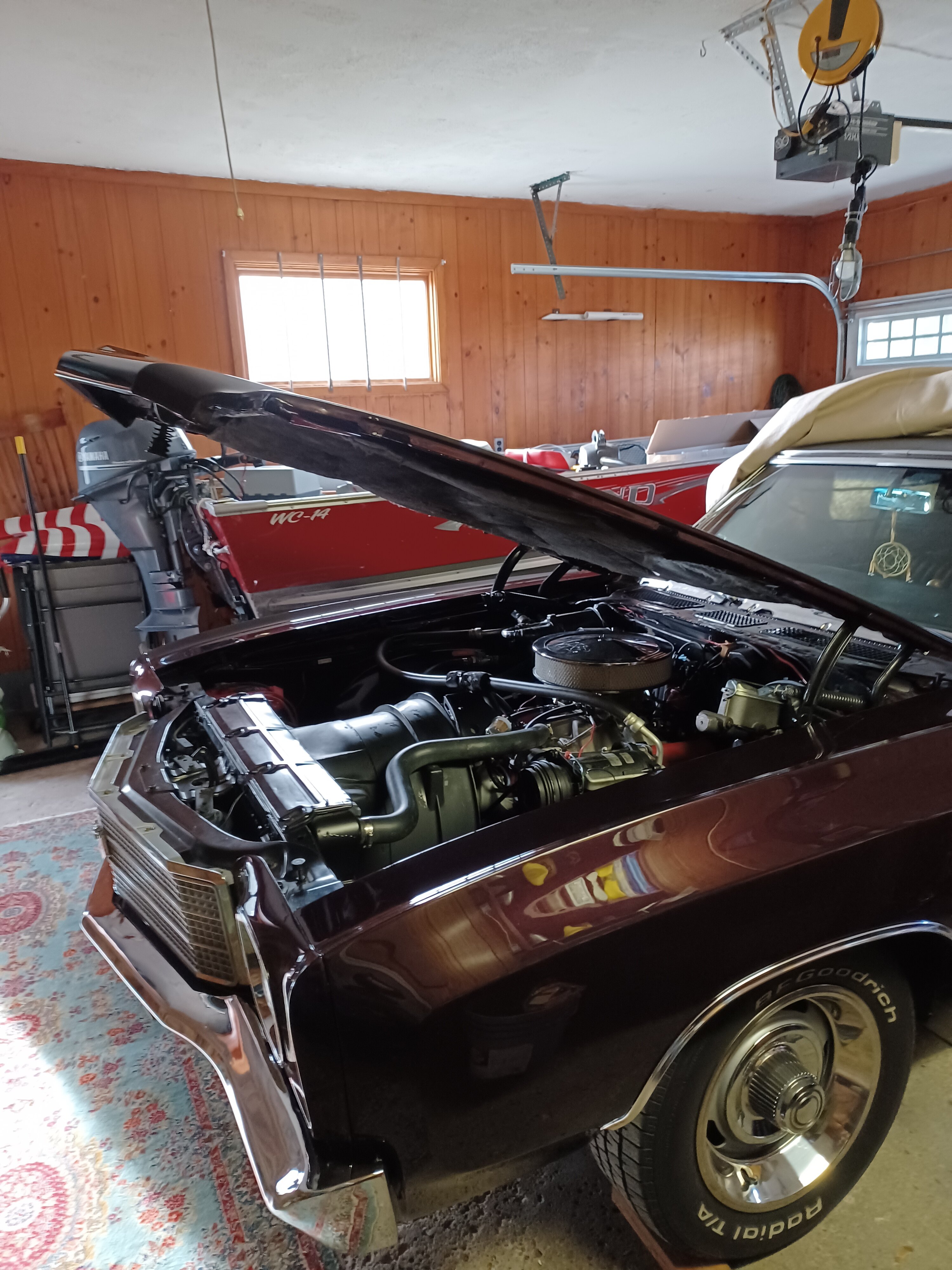

Albeit on a smaller scale, but yet still a lot of tension. I did my  hood the same way.
Today I tried putting springs inside the hood springs. Hood will stay up without the prop rod. although if doing any real work I'll still use it. Happy with the results. Attached 3 pictures with hood all the way up and closed to the point that it will still stay up.20230324_171303.thumb.jpg.70be845591ea9d95ec51020ddaee3c10.jpg20230324_171319.thumb.jpg.9d78937ac4558e64e485fce538de5409.jpg20230324_171554.thumb.jpg.e753ed4e941ad08038b04aa3619cc315.jpg

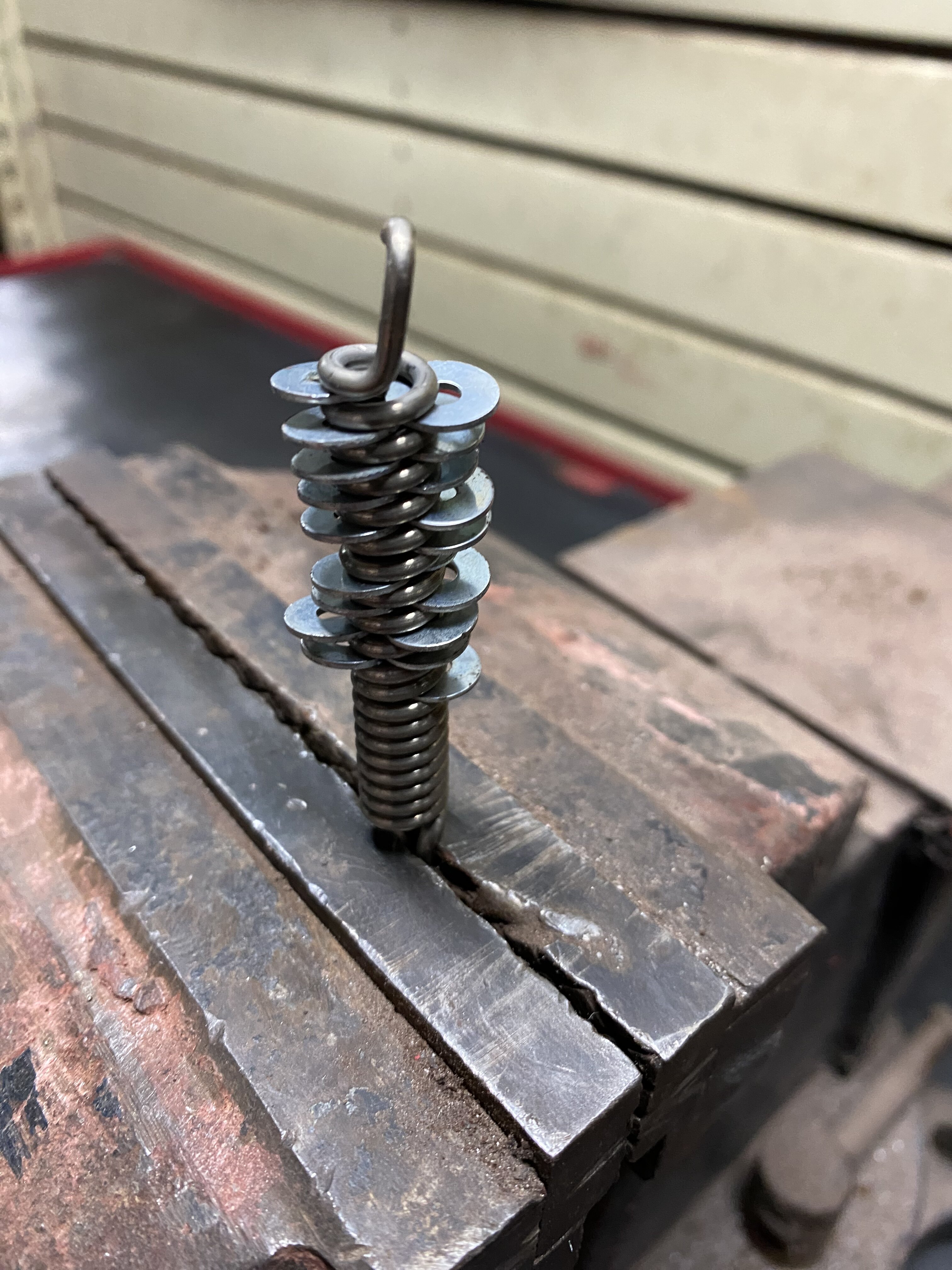

After considering the many methods out there to replace, I opted for the washer method although for the new springs, I used some plastic spacers I had on hand out of concern of scratching the springs.  For easy on and off removal, I found that the spring had to be stretched about 2" from its fully contracted position.
To remove the existing springs I let the hood down to stretch the spring while leaving just enough space to stick my arm under the hood to stuff washers in between the coils until the spring was removable without using force when the hood was fully open.  I used a broom handle as support to hold the hood fully opened during the removal and installation process.
To install the new springs, I  used a floor jack (see pic).  I hooked one end of the spring under the pin located below the pad and the other around a crow bar I placed under a set of 4"x4" pieces of wood which rested on a 2"x4".  The 4"x4" created the additional jack travel needed to get the right amount of spring stretch, while the 2"x4" made it easier to hook onto the crow bar.  I also used the jack to remove the washers from the old springs after removal from the car.  Once stretched, I inserted 1/16" plastic spacers (see pics) between each coil then lowered the jack.  The spacers kept the spring partially elongated.  I unhooked the spring from the jack, installed it in the car, put a bag under the hinge, lowered the hood and the spacers fell in the bag.  This worked flawlessly for the first spring, but for the second I found I had to add a few larger spacers and then coax some of them out with the hood down low enough to still get reach under the hood.  The larger spacers had ridges and that seemed to prevent them from slipping out easily.  Using smooth ones like the smaller ones likely would have made this easier.
