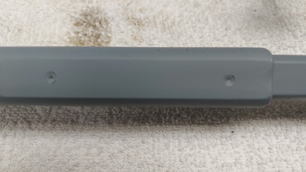

94080305_2023-04-0319_40_27.thumb.jpg.f4603374172edb92d18261d60c246a5f.jpgThe haynes advised to collapse?  I just took mine out to have a new boot installed and the shop advised me not to break the plastic rivets as they are designed to let it column collapse during an impact.
I just primed the shaft.  You can see the plastic rivets he advised about in the second picture.  I had disconnected the shaft at the rag link first and then pulled off the steering column.  I did not have headers in the way.
