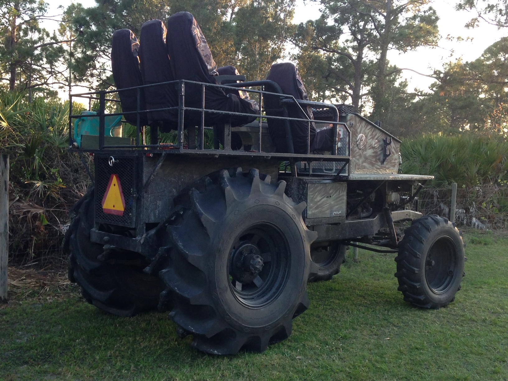

MCfan Posted April 16, 2023 Author Posted April 16, 2023 Thanks again for everyone's suggestions on things to do and check regarding my power steering issues. I had planned to investigate all suggested causes but, before I got started, I also mentioned the problem to my son-in-law who lives nearby. Several years ago, he had the same symptoms occur on his swamp buggy powered by a 305 Chevy with power steering. He solved it by flushing the power steering fluid and re-filling the system with Lucas Power Steering Fluid with Conditioners. Based on his input and several of your questions/suggestions regarding the condition of the power steering fluid in my system, I decided to investigate that as a possible cause first. Before I began the power steering fluid flush procedure (I looked at several YouTube videos), I jacked the front wheels off the ground and cranked the steering wheel lock to lock several times without the engine running as Tom suggested. There was no locking up at all so I could pretty well eliminate a mechanical failure in the steering box. I flushed the old fluid by disconnecting one end of the return hose and plugged the return inlet to the pump. Cranking the steering wheel lock to lock several times pumped the old fluid out into the catch pan. It was surprisingly dark as it had not been changed since 2013 when I installed the rebuilt pump. Continuing to crank the steering wheel while filling the reservoir with fresh Lucas fluid ultimately purged the old fluid out of the system and replaced it with fresh fluid. After reconnecting the return line, I again cranked the steering wheel lock to lock many times to purge the air bubbles and kept refilling the reservoir with fresh fluid. But when I checked the fluid level on the dip stick, I could see that there was a layer of foamy fluid on top in the reservoir and on the dip stick. Apparently the procedure I used either allowed or introduced a lot of air into the system. Finally, I decided to test drive the car. Every movement of the steering wheel cause an unusual noise from the power steering pump, although the system seemed to be working fine otherwise. I returned home and immediately jacked the wheels off the ground and tried to purge more air out of the system by operating it lock to lock many times and adding fresh fluid as needed. The pump was much quieter during the second test drive and almost totally quiet during the third test drive. The best news, of course, is that the "locking up" problem has almost totally disappeared. I am confident that the conditioners in the Lucas fluid will eventually unclog whatever the old fluid had done that was causing that problem. I plan to follow up on some of the other suggestions but for now, it seems that the original problem has been solved. If I find anything else, I'll report that later. My Monte is about to be put down for a long summer's nap as I head for our summer home in MN next Thursday. I'll miss her while I'm gone! 3 Quote
