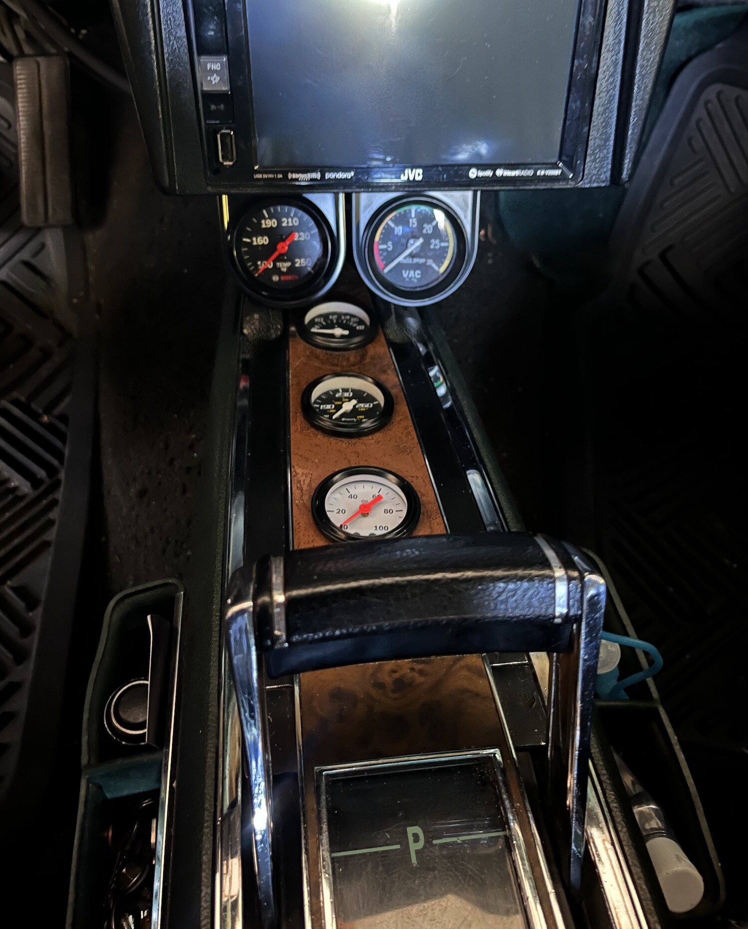

EVC Posted August 6, 2023 Posted August 6, 2023 To add my thoughts: I run two water temps gauges.. One directly in the thermostat housing and the other in the stock position on the passenger side of my 350… There is usually a variance of 20 to 25 degrees between the two … Naturally the one in the housing is hotter… Typical readings are as follows: Using ambient air temp 90 to 95 degrees,,, as baseline. My Radiator is a 3row copper/brass stock type, stock fan and fan clutch. At idle,,,,In heavy traffic,,, w/AC on , the temps can read as much as 210/220 at the stock position and 230/240 at the upper housing when in heavy traffic. When rolling, the water temps will appropriately drop back to a comfortable 180 to 190 with AC ….Every car I've owned during the past 60 plus years of driving has run similar temps and like many other members here I am always concerned. The bottom line is, if it doesn't boil, then move on and try to treat the engine gently. I'm sure everyone here has their favorite setup, but I'm a big fan the 3 row radiator opposed to the 4 row or aluminum. (another discussion ) When the ambient temps go above 100 degrees I expect the numbers to increase and scare the crap out of me, but I've never lost and engine because of heat. Try driving a 63 Pontiac Bonneville 389 or and old Cadillac 472 in the Arizona desert. The temps will go off the charts. They seem to run better without mechanical gauges.. On cool days with average of 75 degrees she will run at about 160 on the open road (actually too low for me), but it really doesn't matter much whether you use a 160 , 180 or even a 195 degree thermostat, as long as it opens on time. Running a car too cool in the winter can be worse than running it at 220 on a hot day. Good oil with Zinc, proper coolant, hoses/belts and timing is everything… My fuel economy is best when the engine is 195 to 210. I use a vacumn gauge to drive and it really helps me from putting the foot down.. I picked this up back in the early 60s when Pontiac installed them in some their cars… EVC Quote
