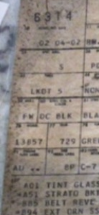

Glen Posted April 29, 2023 Posted April 29, 2023 15 hours ago, willie said: Glen i can go for a darn ice cream about now as i was thinking about this all day!!! My one cell brain is working overtime!! Ok so Glen your 70 has CN in box 53-55 that's what we all have as it shows what type air cleaner, and your 104 box shows DQ (this is what i would go with for the 70). On your 71 (paperwork not there) what does the rad cover sticker say, and the air cleaner sticker say? Are they both the same and original? When you get the paperwork you need to find box 91 and try and make that out and if is compatible to your other 2 stickers, hopefully they are. If not something is not correct. I don't have a 70 B?S to help only 71s, and they all seem to be the same. Maybe a different code in box 91 but at least the 53-55 box has the CN. If any one else has a build sheet for a 71SS please let us know if there is a CN in box 53-55 and let us know what is in box 91 (Mine is AU) it could be something else, but let us know..... The bottom line is, all 3 are supposed to match if not something has been changed somewhere. The cars are over 50 years old. Someone, somewhere changed something if they dont match. Not blaming Osbourne for selling anything but the people who bought some of them should have qurstioned at that point. Dven when Darren originally told me i said how can that be because no one was selling what i needed to match. But i tip my hat to him as he knew what he was talking about. I am just passing it along. Ok Willie, hope this’ll hold ya over til I get home to look at the car. Bob sent me a pic of the B/S and P-O-P when we were negotiating the sale/purchase. I located it in my photos , however it’s quite fuzzy/grainy. But I can definitely make out the ‘CN’ and ‘AU’ in (what appears to be) their respective boxes. See if this lines up with your theory… Quote

sbarnette Posted April 30, 2023 Posted April 30, 2023 All this conversation got me off the couch and I dug up a build sheet for a 71 SS I had many years ago. It’s very hard to make out with the crease in the build sheet, but I suspect box 91 is AU. Box 53 is CN. Quote

Glen Posted May 1, 2023 Posted May 1, 2023 4 minutes ago, willie said: Again i am not taking sides!!!! Glen i think (in my opinion) you said your rad sticker was original, but your air cleaner was correctly RESTORED to (the last owners car) or the sticker he could get at the time. If your rad sticker reads AU and its original, the air cleaner should read AU, along with your missing build sheet. According to what i get from the homework i have done. Sammy thanks for checking, This is the way i am understanding they all (71s) are shown. Now i have to prove it but can't as of yet!! And like Glen said a very nicely optioned SS!! I’m just busting Dennis’s stones. He picks on me incessantly, routinely putting me in headlocks and giving me noogies. So I take the easy shots whenever the opportunities present themselves 😂 Regarding the RESTORED air cleaner I mentioned… that one is for my ‘70 when the time comes to put her back to stock. The pix of the stickers I sent earlier are on my ‘71. Earlier in the thread I sent the fuzzy pix of the 71’s B/S (CN & AU codes present), corroborating what’s reflected on those stickers. My 70’s B/S reflects (mostly) the ‘CN’ and ‘DQ’ in their respective locations. However, this car has neither its original air cleaner nor radiator top plate (I also have one of these ready to go for when she goes back to stock). Confusing? Just a tad. 1 Quote
