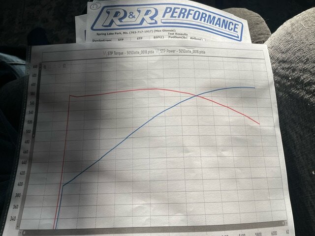

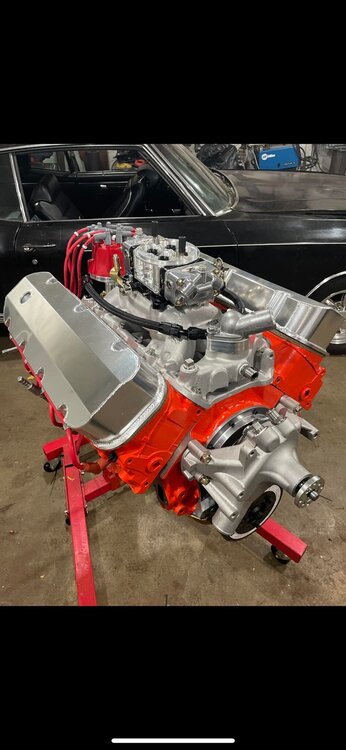

70MC402 Posted July 13, 2023 Posted July 13, 2023 (edited) Hi everyone, in early August I’m going to be bringing my 505 to the Dyno to see how it does. Any guesses at power and torque numbers? Let’s see who can get the closest! The Dyno altitude is roughly 930 feet above sea level. In August my guess is it’ll be 70s-80s when we run it. I’ll be running it on 93. The engine is 505 cubic inches. 4.350 bore, 4.250 stroke. Two bolt main block, ARP main studs. Align honed, decked, bored and honed, cam bearings, magged. It’s a Molnar 8 counterweight crank, molnar H beam rods and Icon 1/16-1/16-3/16 12cc dome pistons. The heads are 049 castings with the intake ported by Mark Jones of Vortec Pro. I can’t say enough about how helpful, educational, and thorough Mark Jones has been through the whole process with all my questions. The heads had 2.190/1.88 valves installed before I got them, and measured between 118-120ccs, yielding roughly 9.8:1 compression.They currently have comp cams 924-16 springs set up at 1.800 installed height. 147 lbs on the seat and 343 on the nose. The cam is a billet core version of the comp 11-456-8. 242/248 at .050 and .566/.566 lift, 112 LSA, installed ICL at 108. Using a set of lifters I ordered from Crower, they are the high pressure pin oilers, and when unboxing them I found they’re actually Johnson’s! Still pin oiled lifters. 7/16ths Manton pushrods. Crower enduro stainless 1.7 rockers. The intake manifold is an out of the box RPM air gap. The carburetor is an FST 1050 built by Mark Whitener at Lighting Racing Carbs, another guy I can’t speaking highly enough about. Ignition is a MSD pro billet, 8.5mm MSD super conductors and NGK 4323 plugs. If there’s anything else I missed don’t be afraid to mention it! Thanks and let’s see who’s closest! Edited July 13, 2023 by 70MC402 Quote

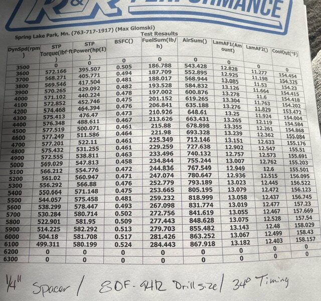

70MC402 Posted August 8, 2023 Author Posted August 8, 2023 Well it didn’t quite make what I was hoping but it should still be a handful! After an afternoon of jet changing, spacers, timing adjustments best we could coax was 577 torque and 582 horsepower. Quote
Dragginwagon467 Posted August 8, 2023 Posted August 8, 2023 3 hours ago, 70MC402 said: Well it didn’t quite make what I was hoping but it should still be a handful! After an afternoon of jet changing, spacers, timing adjustments best we could coax was 577 torque and 582 horsepower. That’s not too bad. The power hangs on fairly well up top and that torque curve is nice and flat. Quote
