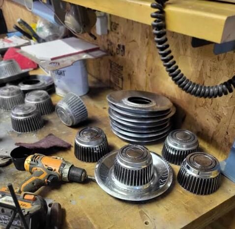

Has anyone restored derby caps,I have several trying to find the best way to redo the black painted areas.I have restored some side trim for my 70 c10 by spraying the entire piece and wiping the high areas with a gas saturated rag which worked but don't think that technique would work for these. Any advice appreciated.  thanks

thanks for the suggestions guys. I fooled around with the best caps I had which are driver quality only. didnt turnout to bad used the spray and wipe the high spots with a gas rag
