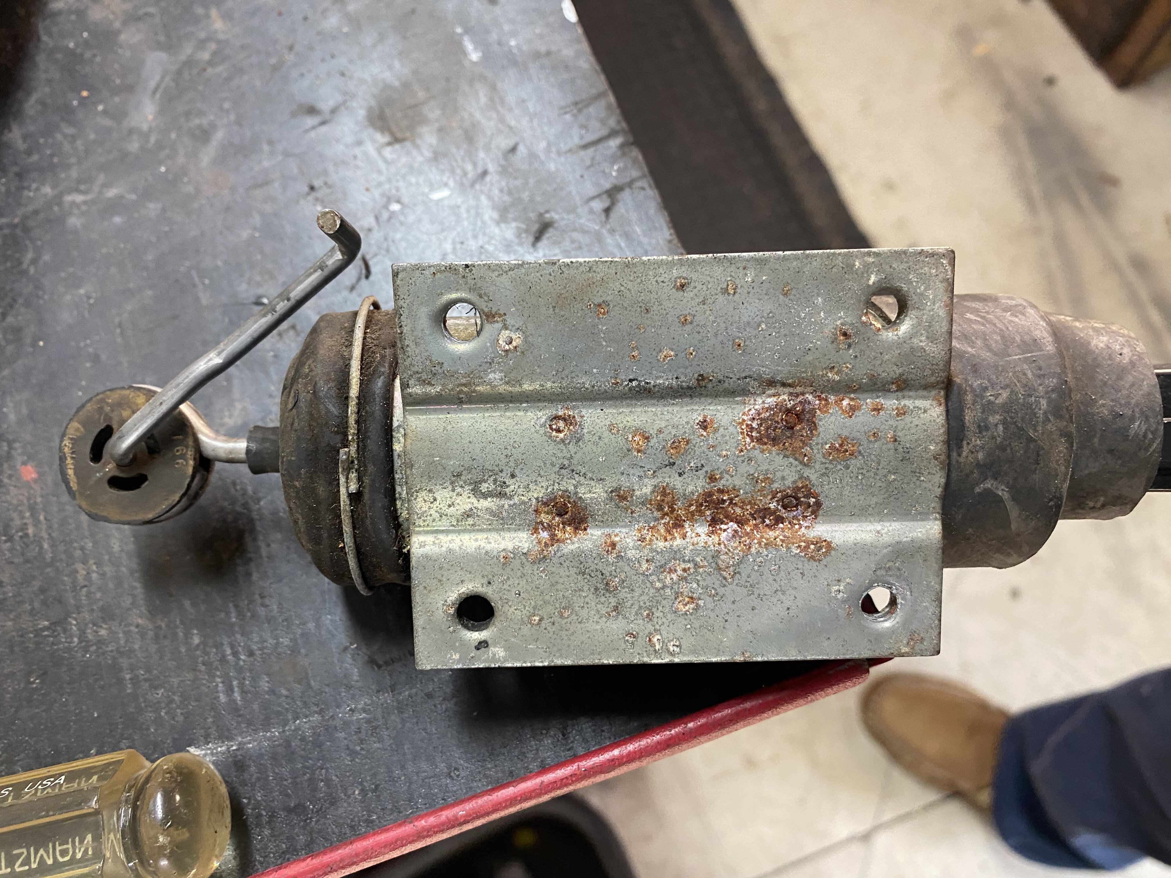

mon-tss Posted December 19, 2023 Posted December 19, 2023 I have the bracket and most of the wire; but that's it. guess the rivets broke loose and it got remove so it wouldn't rattle. Don't think anyone make these. Quote

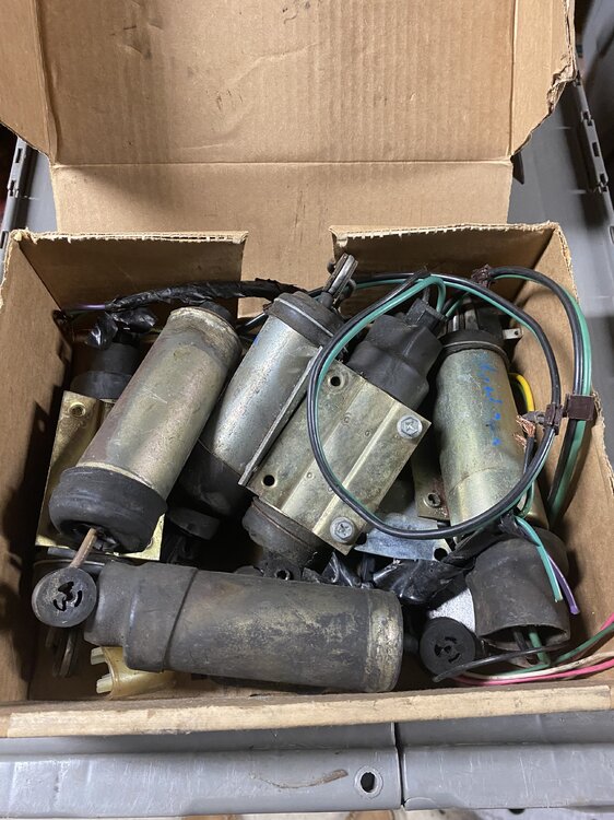

Dtret Posted December 19, 2023 Posted December 19, 2023 I got them. Post a picture of what you have and I’ll see if I can finish building it to figure out what parts you want. Someone chime in on this please. It’s been a while since I have messed with these. But I seem to remember the actuator having 3 bolts. I can’t get in my cars to look. 2 Quote

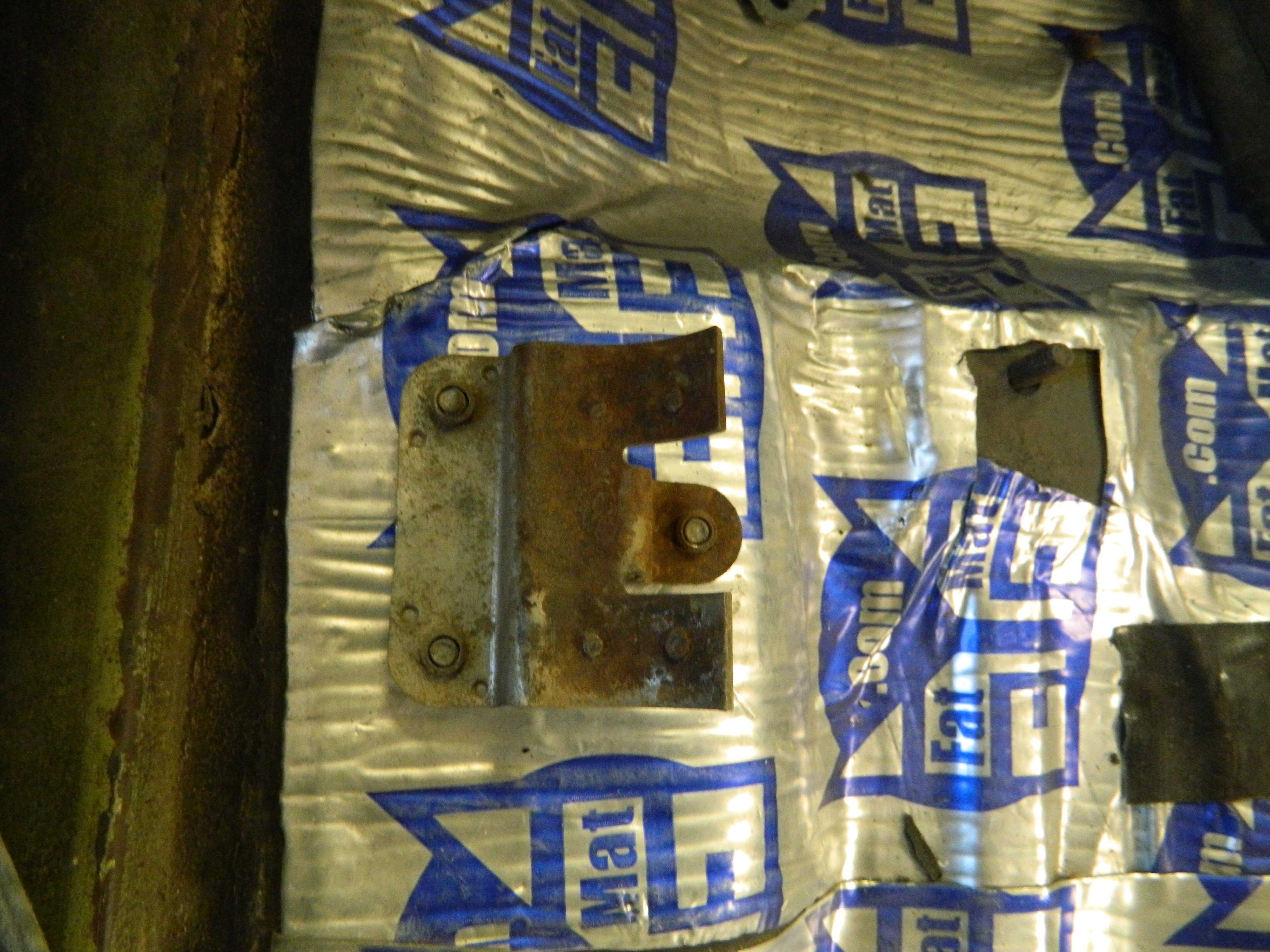

mon-tss Posted December 19, 2023 Author Posted December 19, 2023 Took a picture of the passengers side. And what I have . Would prefer to have it attached to hte bracket 1 Quote
Dtret Posted December 19, 2023 Posted December 19, 2023 Ok. All these bolt on with four bolts. But could possibly be made to fit. I’m going to have to check the numbers to see if they will work on Monte’s. 1 Quote
Marks71 Posted December 20, 2023 Posted December 20, 2023 Just a thought here. It looks like your bracket is pretty stout. What if you drilled a series of small holes in the bend of your bracket to create a couple 1/2” slots that you could pass a couple hose clamps through. Then cut up an old bicycle inner tube into 3/4” strips to wrap the actuator with to go under the hose clamps. I may be mistaken but it looked like Dennis had a couple actuators without brackets. Quote
Dtret Posted December 20, 2023 Posted December 20, 2023 You could do that. They all had brackets at one time. They were just spot welded on. You could possibly just drill holes in the bracket to match the door and cut off the excess material. Quote
mon-tss Posted December 20, 2023 Author Posted December 20, 2023 I think the activators are all pretty similar. Might be able to pop rivet this bracket on different activator or maybe weld put of this bracket to another . should be able to make something work. Quote

Marks71 Posted December 20, 2023 Posted December 20, 2023 Not sure what the inside of those looks like but I’d assume there’s a piston that the pop rivets would interfere with the travel of. Quote
jft69z Posted December 20, 2023 Posted December 20, 2023 The solenoids appear to be similar. I'd find one that matches what you already have on the right side, then give the left side bracket you already have a few tack welds with a MIG welder, that's probably the easiest, and most cost effective fix. Quote
mon-tss Posted December 20, 2023 Author Posted December 20, 2023 Sounds good. I can use a foot of the wire with the end that plugs into activator out. Thanks Quote
Dtret Posted December 20, 2023 Posted December 20, 2023 No part numbers on it. I did test it and it does work. Check your act rod to see if it’s the same length. 1,000,000 dollars plus shipping, if you want it before Christmas it’s 8 dollars more. Yes. Obviously a joke. lol. I didn’t realize how hard it is to keep my slippers out of these photos. lol. 3 Quote
