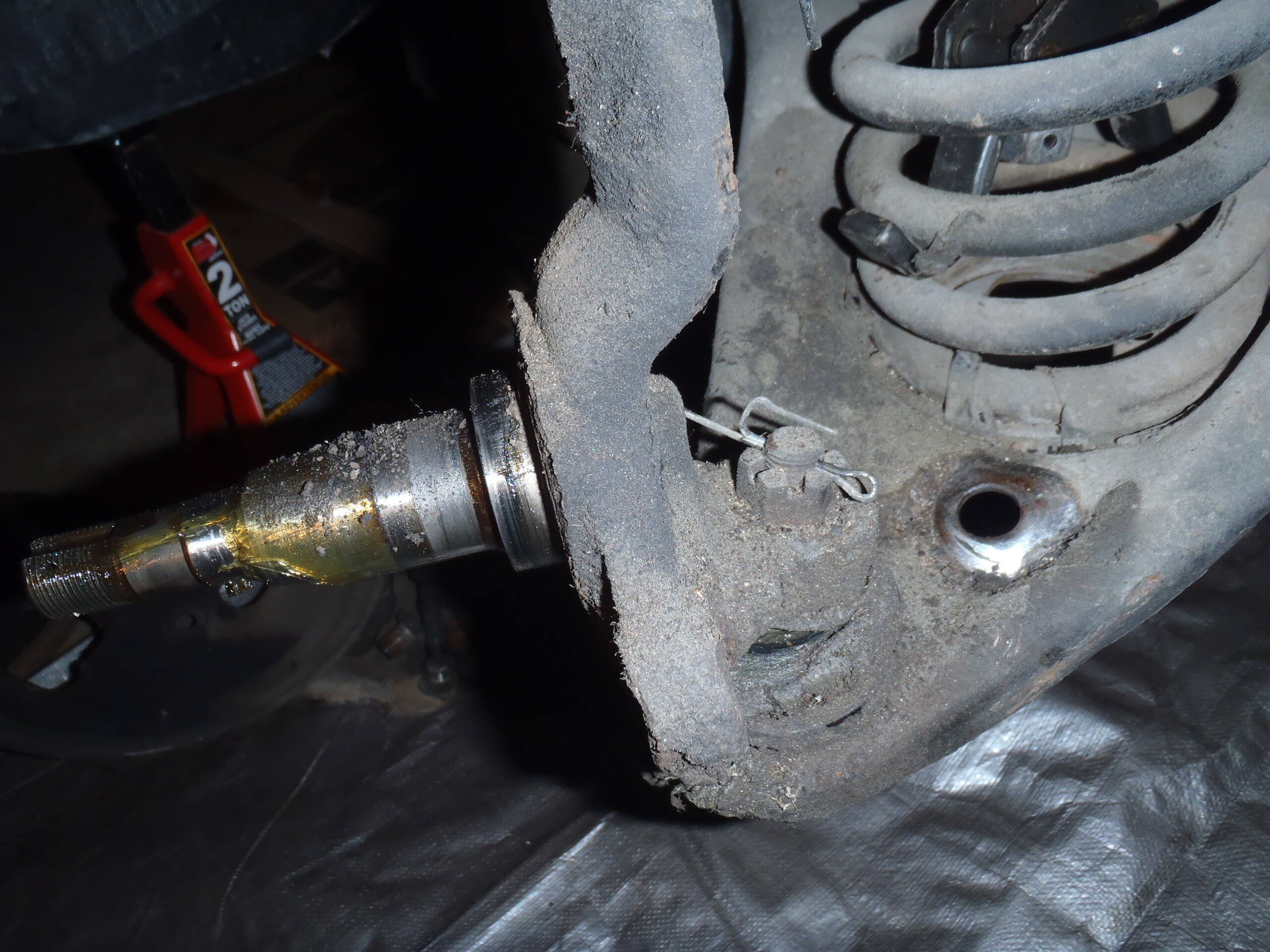

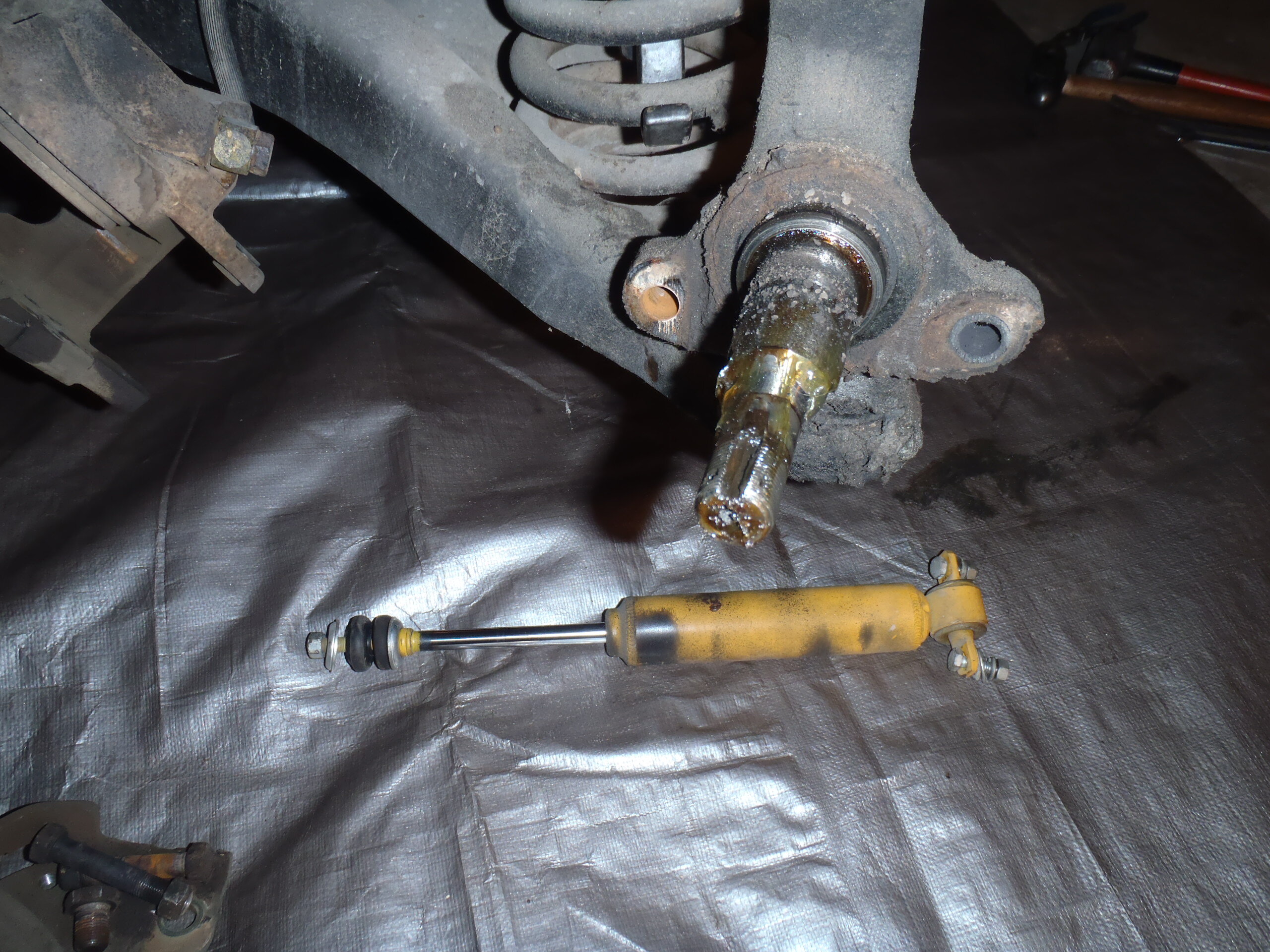

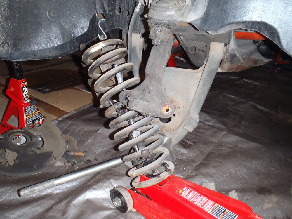

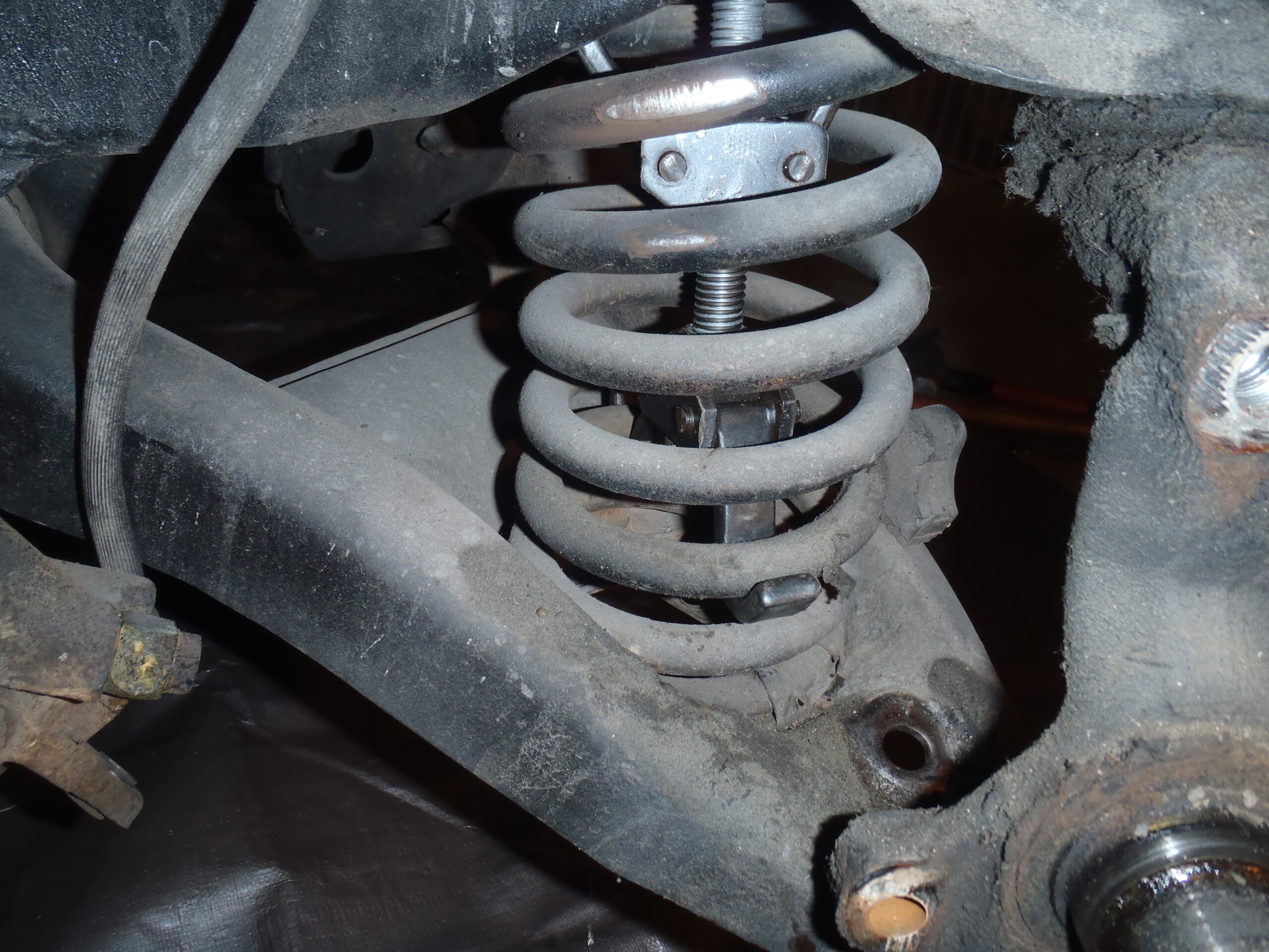

MCfan Posted January 3, 2024 Posted January 3, 2024 Wayne, you are wise to use some type of safety restraint for that job. The first time I did it, I pried the spring out of the lowered control arm socket and it still had enough compression to go bounding across the garage floor - fortunately I was not in its path. The next three times, I used an internal spring compressor! It's a bit of a Houdini exercise to get it positioned (after removing the shock, of course) but it can be done and is well worth the safety it affords (see photos). Good luck. Stay safe. 5 Quote

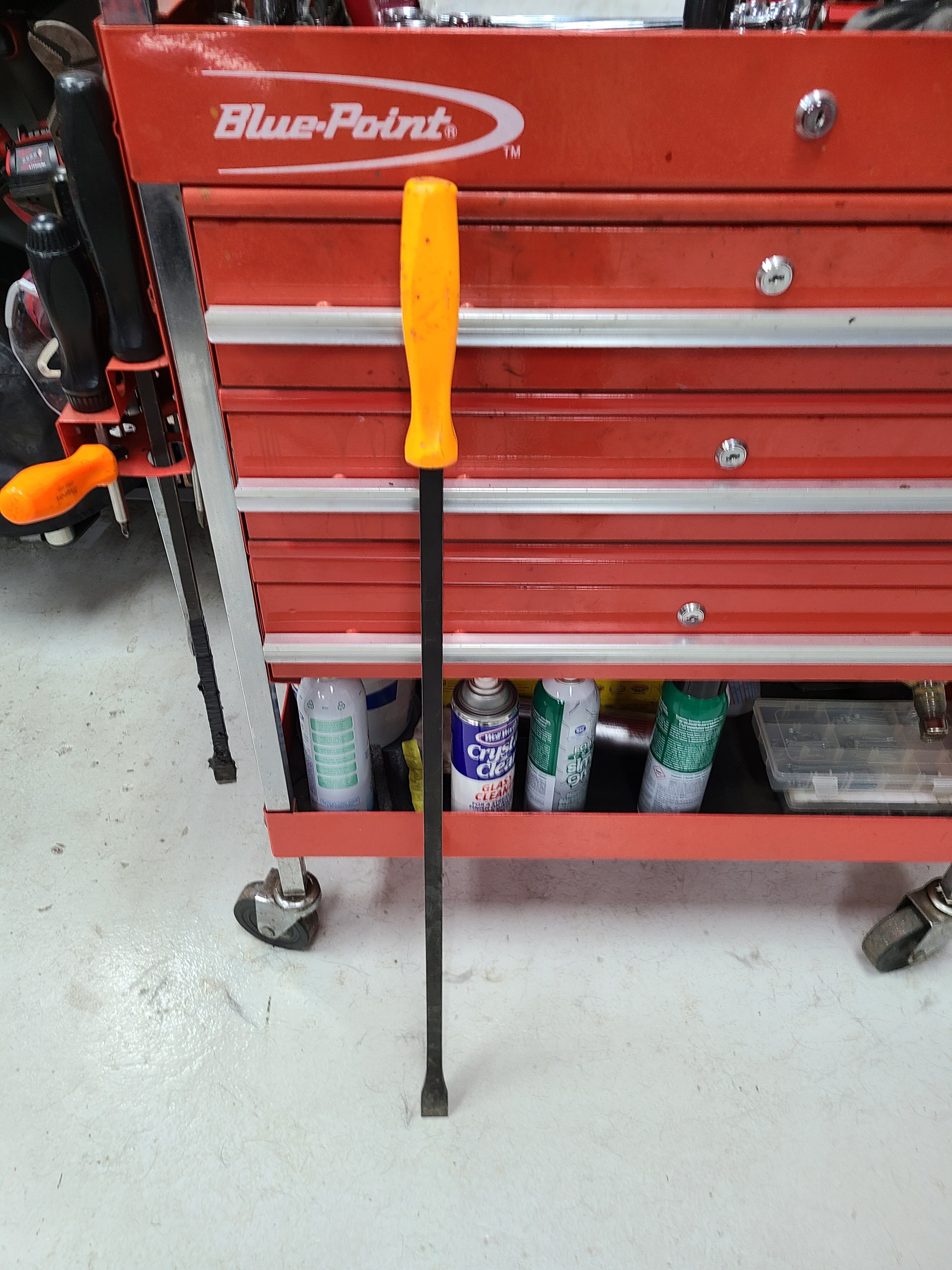

Scott S. Posted January 3, 2024 Posted January 3, 2024 With a tire iron ??? Or a really big screwdriver ?? Quote
jft69z Posted January 3, 2024 Posted January 3, 2024 34 minutes ago, Scott S. said: With a tire iron ??? Or a really big screwdriver ?? I use a 3 foot Snap-On prybar. 2 Quote
