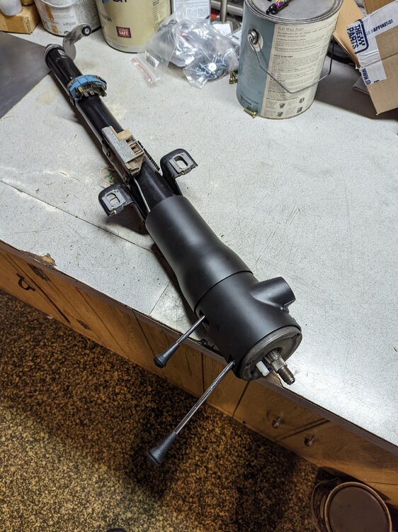

MC1of80 Posted January 22, 2024 Posted January 22, 2024 You can make a column shift tilt into a console/4speed column. The lower bowl is now sold new. This was a column shifted tilt that I converted to console/4speed tilt. 9 Quote
Dtret Posted January 22, 2024 Author Posted January 22, 2024 Technically yes but on the 4 speed the lock rod arm is straight and about an 1 1/2 long. I’ve done the conversion above twice for automatics. If I’m going to purchase one it needs to be correct for the car. 6 Quote
