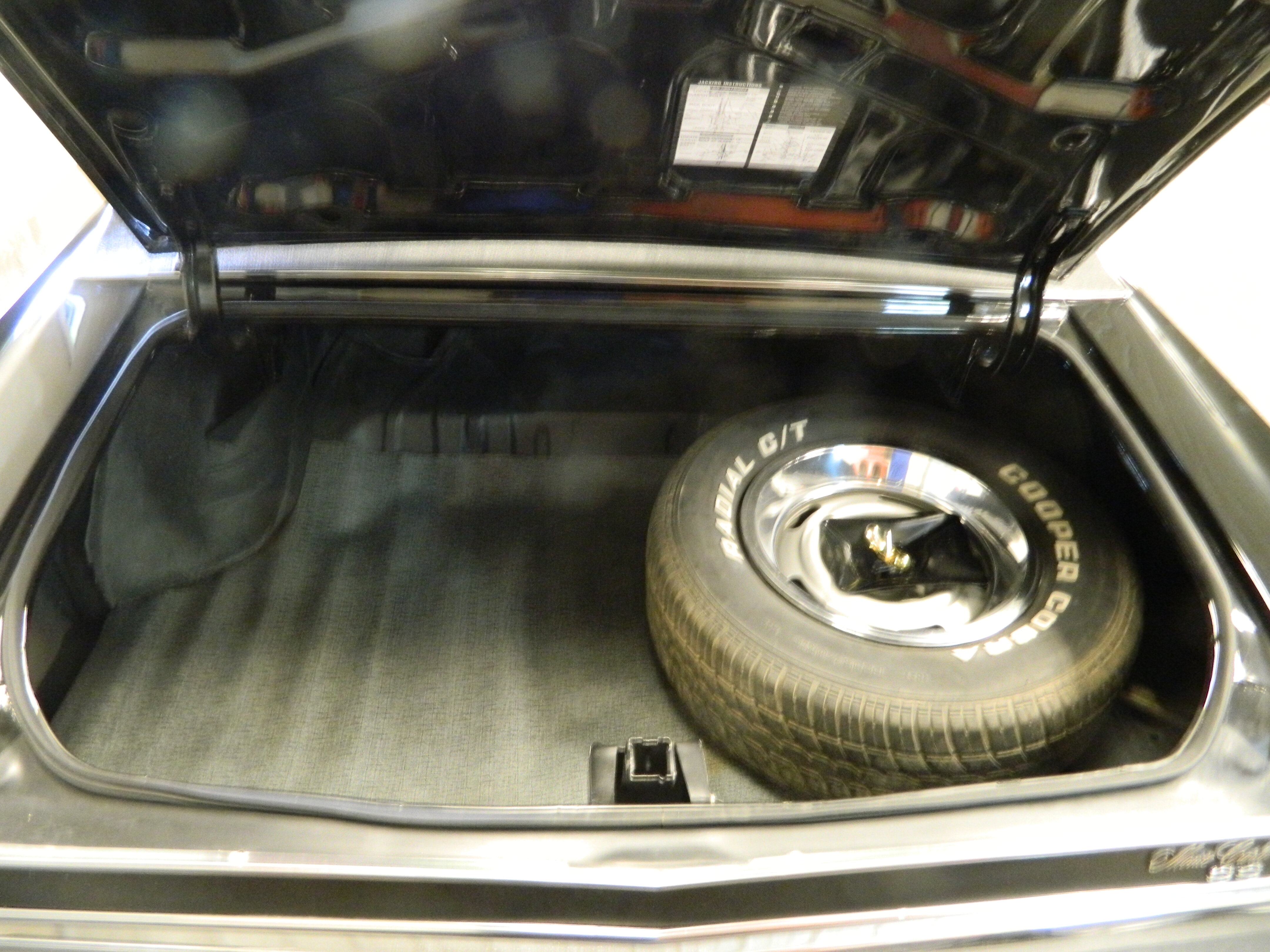

Jeff Dodson Posted June 11, 2024 Posted June 11, 2024 It the truck lid hinges adjustable. The back section sticks up high enough that it will leak water in the trunk when it rains. Quote
420ponies Posted June 11, 2024 Posted June 11, 2024 Make sure the spring rod going into the hinge is in its "slot" . That can cause it to lift when closed. 3 Quote
cny first gen 71 Posted June 11, 2024 Posted June 11, 2024 I don't think there is any up and down adjustment I'll look at mine a little later I'm hoping to get to cruise in tonight Quote
jft69z Posted June 11, 2024 Posted June 11, 2024 5 minutes ago, cny first gen 71 said: I don't think there is any up and down adjustment I'll look at mine a little later I'm hoping to get to cruise in tonight You typically have to bend the hinge if it's way too high. I'm sure you checked there are no shims already installed in there, Jeff? 2 Quote
cny first gen 71 Posted June 11, 2024 Posted June 11, 2024 I looked at mine no adjustments, like Joe said may have to bend the hinge or even bend or tweek trunk lid a bit. But be very careful if you have to bend anything! Quote
Blackhawk Posted June 11, 2024 Posted June 11, 2024 As said, check for shims. You may need to shim the rear hinge bolts to drop the trunk lid. This is a good tutorial on adjusting the trunk and hood. https://www.chevelles.com/threads/lowering-the-rear-of-your-hood-or-front-of-trunk-alignment.388364/ 1 Quote
mon-tss Posted June 12, 2024 Posted June 12, 2024 if you take this lower latch off (two bolts and then shut the deck lid , Does that help? If so lower it. Quote
