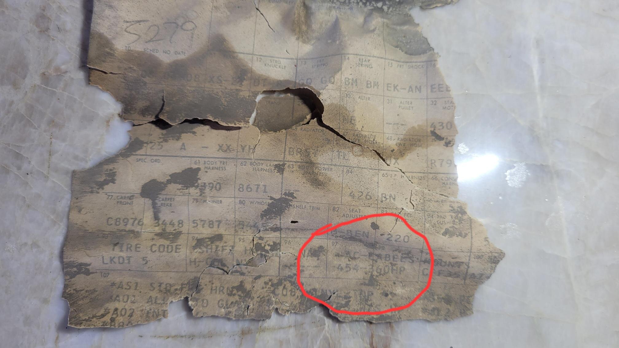

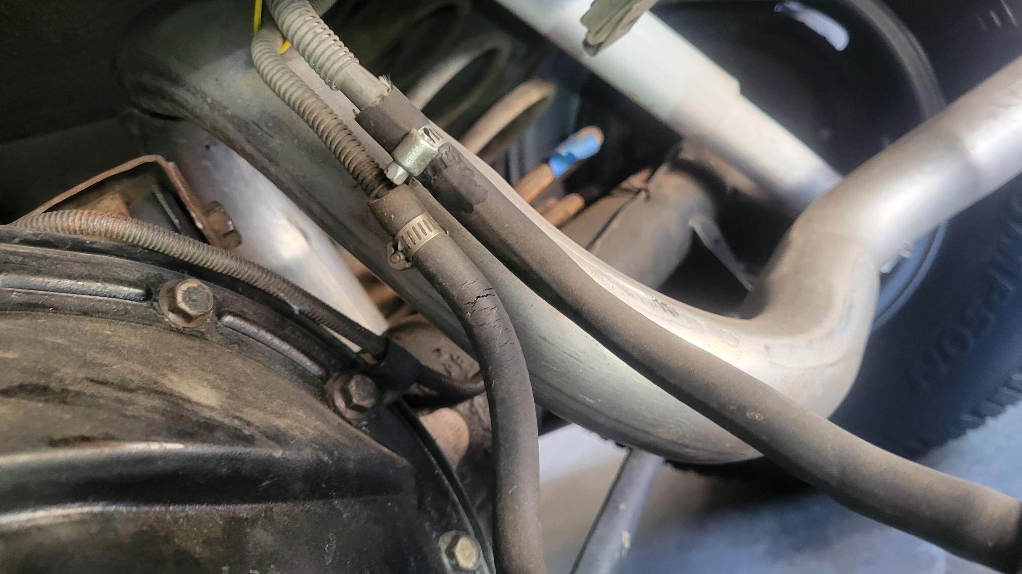

riverdogs00 Posted August 8 Posted August 8 I dropped the tank on my blue SS, just to see if there was a vent or something that could be creating the issue. I DID find a portion of the build sheet, so that was a SCORE. OEM rubber lines (rock hard and cracked). I pulled the sender out for a peek, and all looked good in the tank, no rust or dirt. Reinstalled the sender, added new rubber lines and reinstalled. 4 Quote
