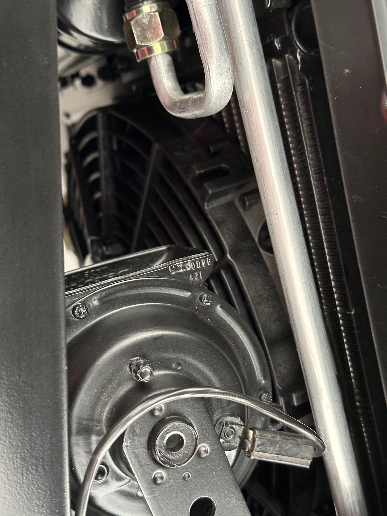

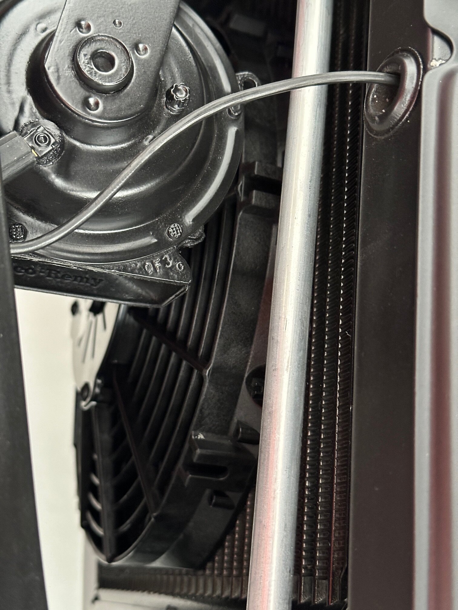

After installing the A/C in my car, I wanted to address the issue poor A/C performance at idle because of low airflow across the condenser. Modern cars have electric fans to facilitate airflow whenever the A/C is on, which makes all the difference. Old cars like ours had mediocre A/C systems to begin with and generally did not work well when moving slowly and/or at idle.

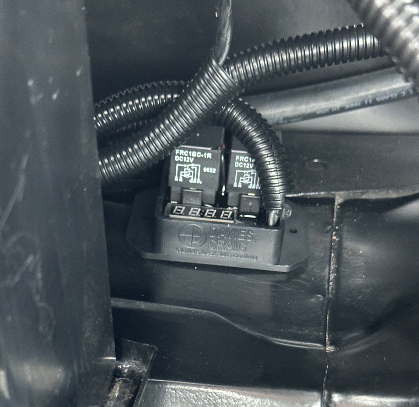

I really debated about doing this because you guys know I'm a fan of originality but I think it turned out well and it made a huge difference. The fans are 10" SPAL rated at 800CFM each. I chose these because they were the largest I could fit in the space available. Also, the s-shaped blades make the fans relatively quiet. There are higher CFM fans, but they are straight-blade and they are much louder. I used a Davies Craig digital thermatic fan switch kit with dual relays and adjustable temperature setting for the fan(s) on/off temp. I tucked the unit into the front fender beside the battery.
It was easy to wire up. It triggers the fans based on coolant temperature and it has a wire that connects to the compressor circuit to trigger the fans whenever the A/C compressor engages. Both work well.
Overall I'm happy. I wanted to share with everyone in case you you have considered this or have issues with poor A/C performance at idle. Bonus: as pusher fans, the fans act of a bit of a boost to the clutch fan as well. 👍
Update: First real-world test yesterday. It was 87° and my car sat in the sun all day at a car show. When it was time to leave, I rolled the windows up, turned the air conditioning on and the air from the vents dropped to 37° relatively quickly. That is due to the fans pushing air across the condenser. 👍
