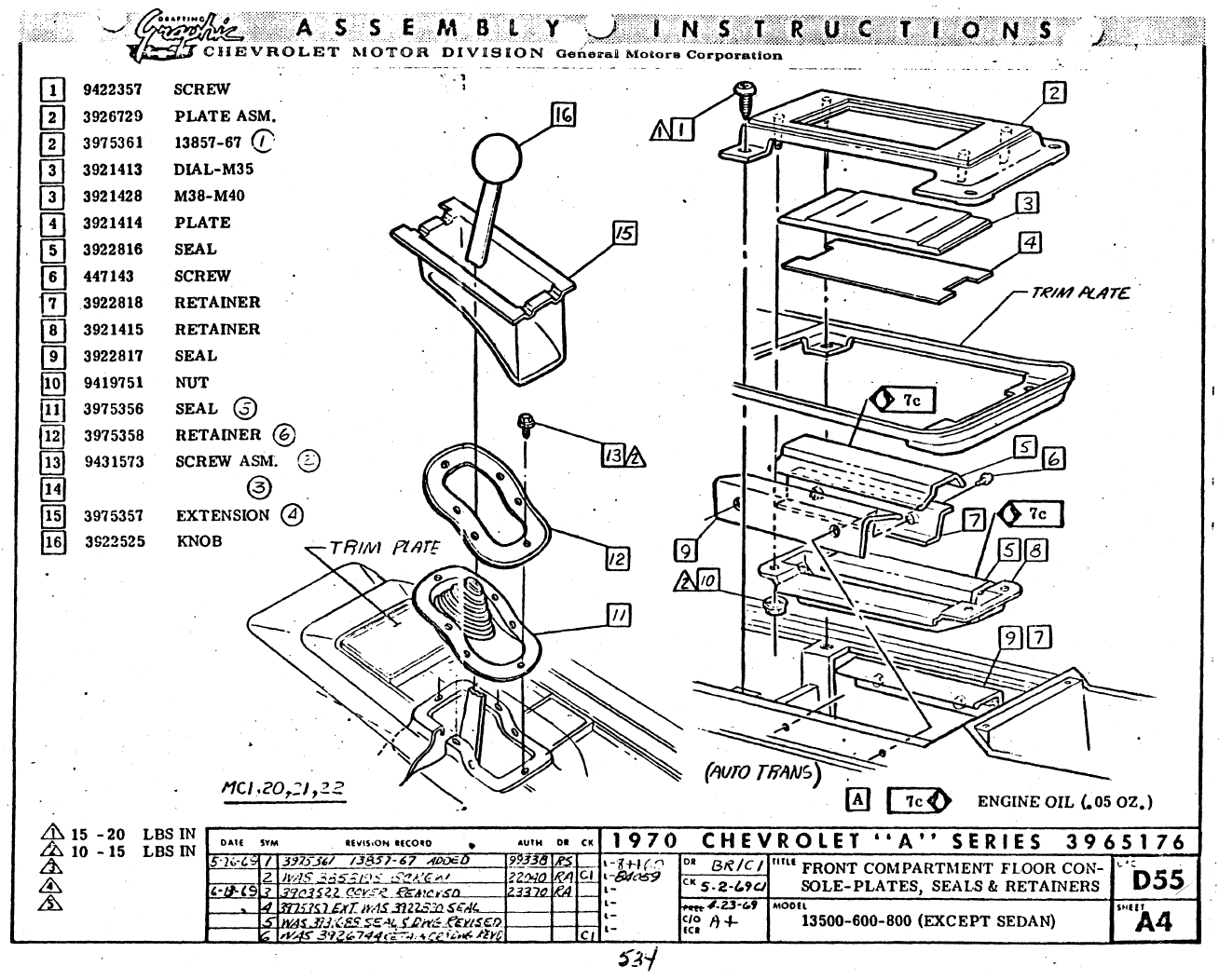

I see in the 70 manual, section D55, sheet A4  (page 534) shows a knob to be part number 3922525, that's under the 'floor console option'.
When I go to the 4-speed transmission section, it shows a 2 piece knob.

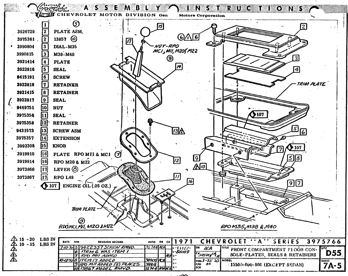

In the 1971 book, Section D55, sheet 7A-5, page 499 it shows a knob as part number 3992308.

1971
1970
Dan, I also am getting the same number as Joe, 3992308. That would be for a 1971 with console.

Thank you, Joe! That's exactly what we needed. The '71, 3992308 knob looks the same as the one that the Camaros used, but the numbers aren't the same. I would assume the thread is different.
