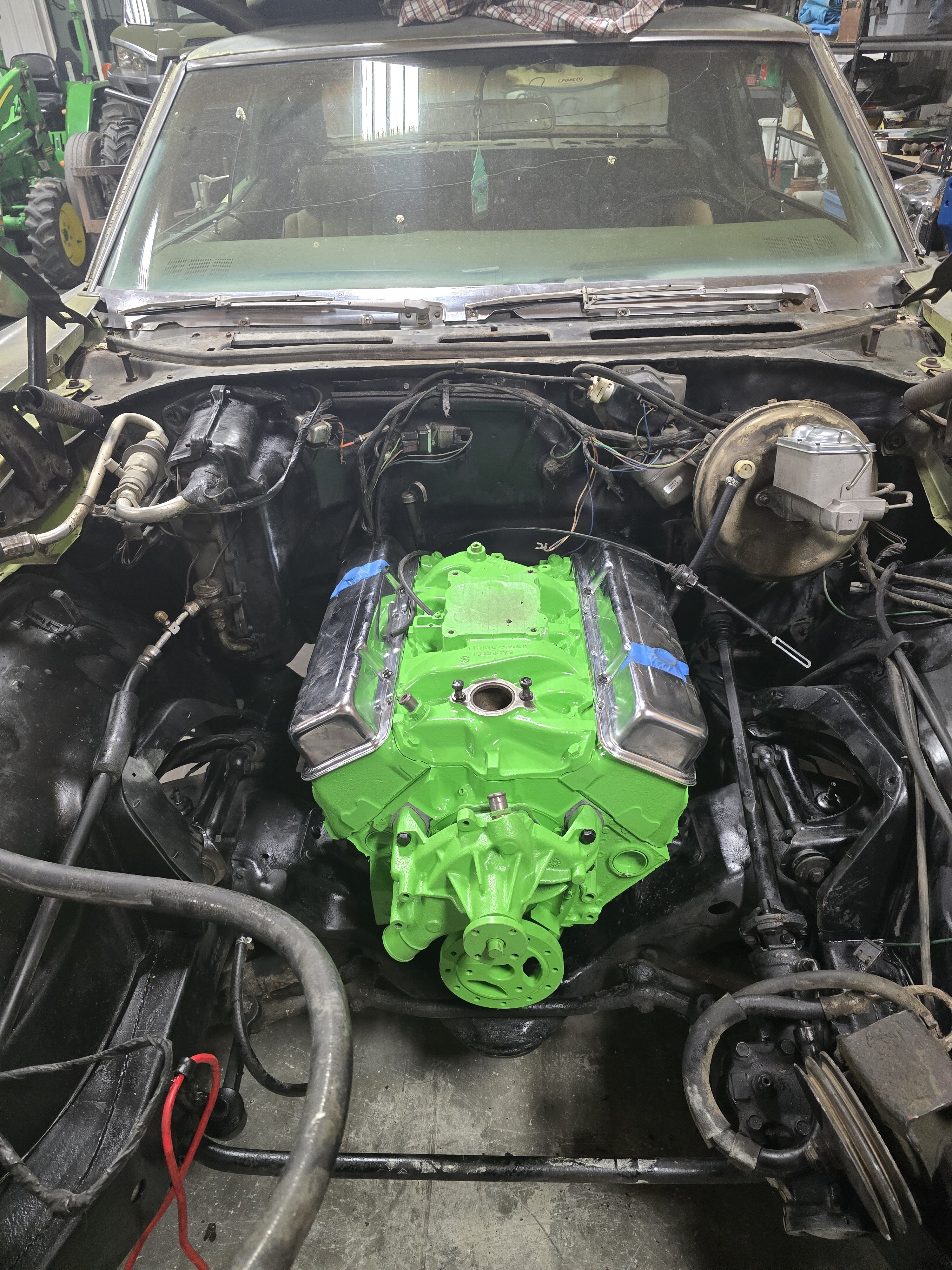

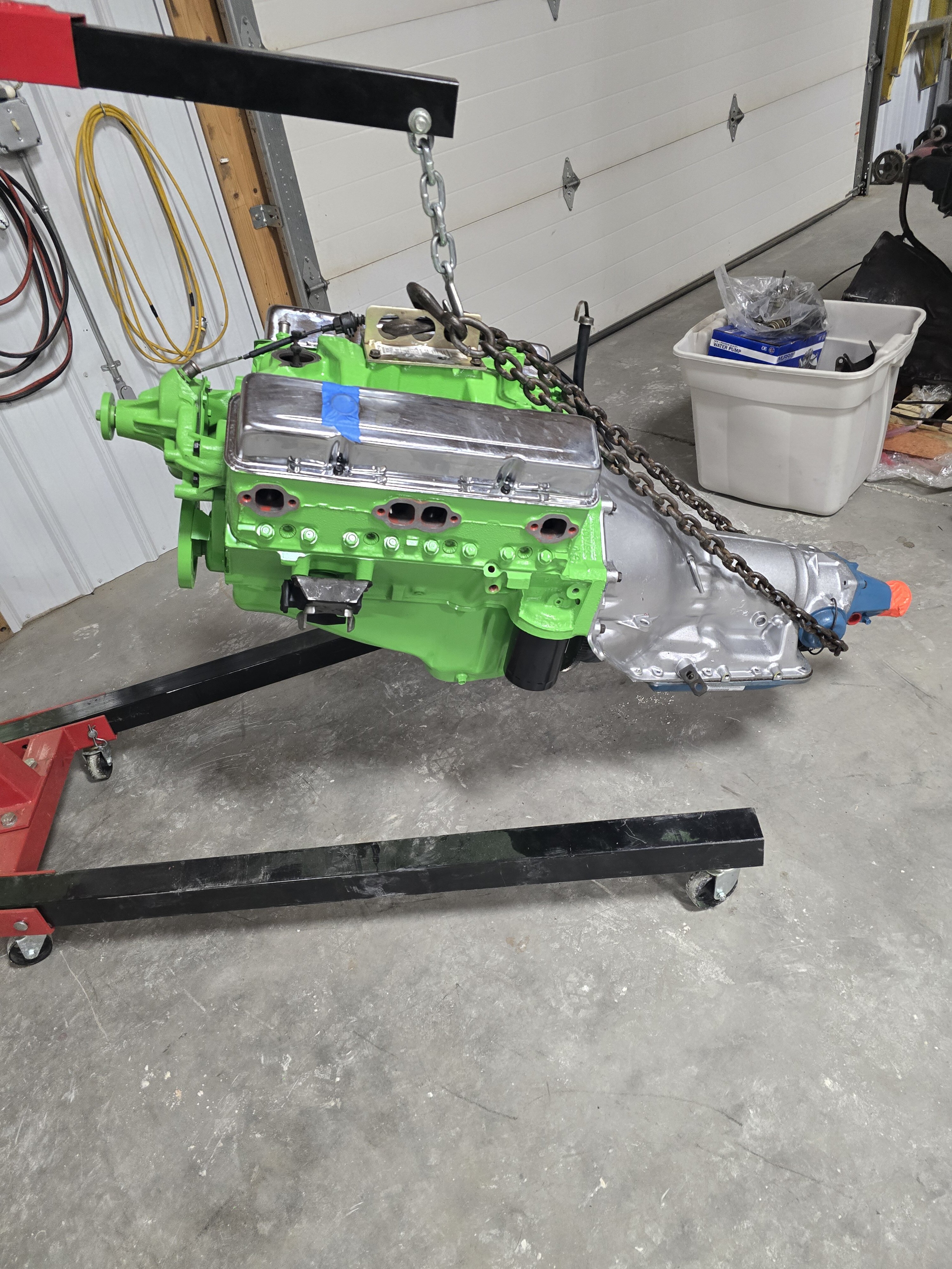

Tonka Man Posted December 31, 2024 Author Posted December 31, 2024 I know I'm going to catch grief for my choice in engine color but I have decided that on these cars, I'm going to build them for myself. None of my Monte's are matching numbers and none are SS cars. All are rescue cars with rust, grime, dirt and possibly a sordid past. They all are high mileage cars. I have two 350/350 drive trains that are out of heaven knows what so I'm going to do things my way. I am big into colors and I decided that I'm going to paint the blocks the body color so when I open the hood at car shows, it matches. Again, my way is the way we are going! This block is a 350 probably from the mid to late '70's; the heads are camel hump heads from the '60's and I have no idea what the 350 turbo is out of. However, the engine and transmission have a fresh rebuild and they should run really good. The old engine and transmission I will tear down and send out for rebuild and put it in Blueberry, the 1970 I bought earlier this summer. 5 Quote

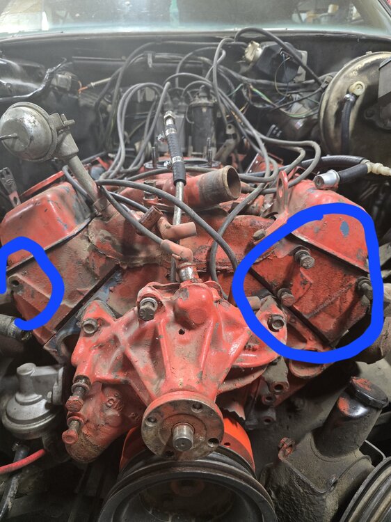

Tonka Man Posted January 23 Author Posted January 23 Well, I'm in a Pickle! Literally and figuratively. My engine swap has hit a snag. As you can see from the picture below, the old and tired 350 has newer heads that are drilled and tapped for the alternate bracket on the passenger side and the AC brackets on the drivers side. My new engine has some 327 camel hump heads that I've used on a few builds now. Unfortunately, they are not drilled and tapped for those bolts. I can live without AC on this car but not an alternator. Any thoughts on what I can do to to make this happen? The second picture is a blend of the correct bracket (below) and another one I had kicking around (middle). I don't even have the top one that wraps the alternator yet. 2 Quote
Marks71 Posted January 23 Posted January 23 If you Google accessory brackets for double hump heads, there is a lot of help there for your situation. There’s a company that makes plain steel brackets that Vintage air had recommended to me when I had to relocate a power steering pump during the install of a vintage air system I was doing. Unfortunately I can’t remember the name. I left a message with Vintage Air regarding the company name. 4 Quote
Marks71 Posted January 23 Posted January 23 Google Alan Grove Components. The number Vintage gave me was 913-837-4368. 3 Quote
Scott S. Posted January 23 Posted January 23 Montelishi has this big chrome bracket..... Works well for me. Quote
