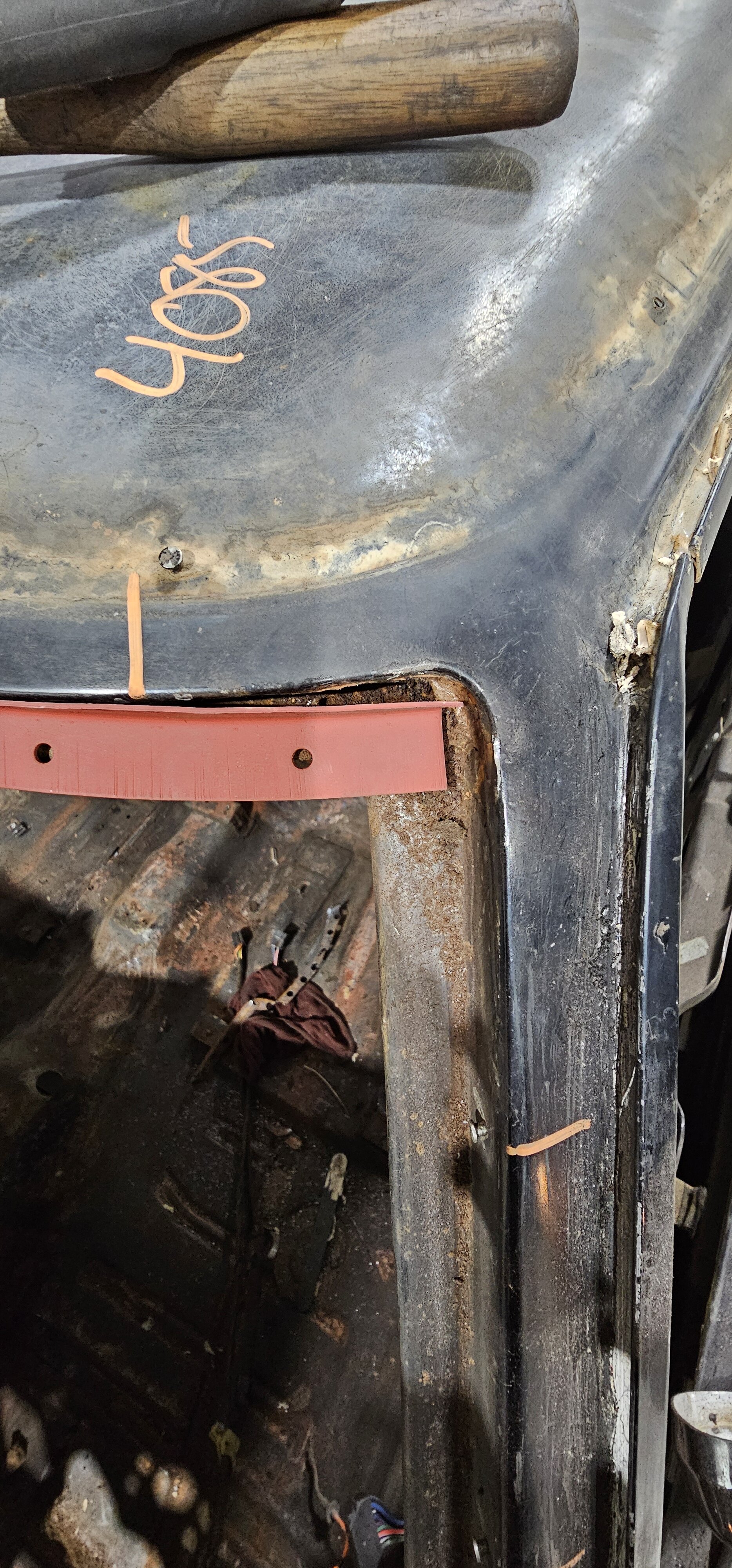

Cut out the left side of the windshield. Was gonna patch it here and there but screw it. Gonna need some tweaking on the repair strips, they aren't conforming correct.

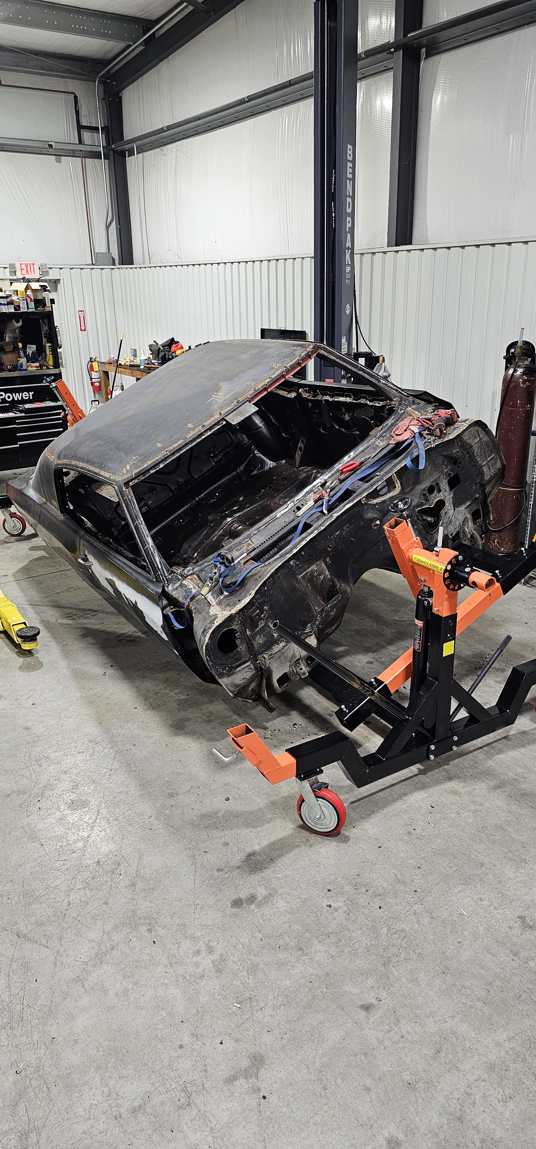

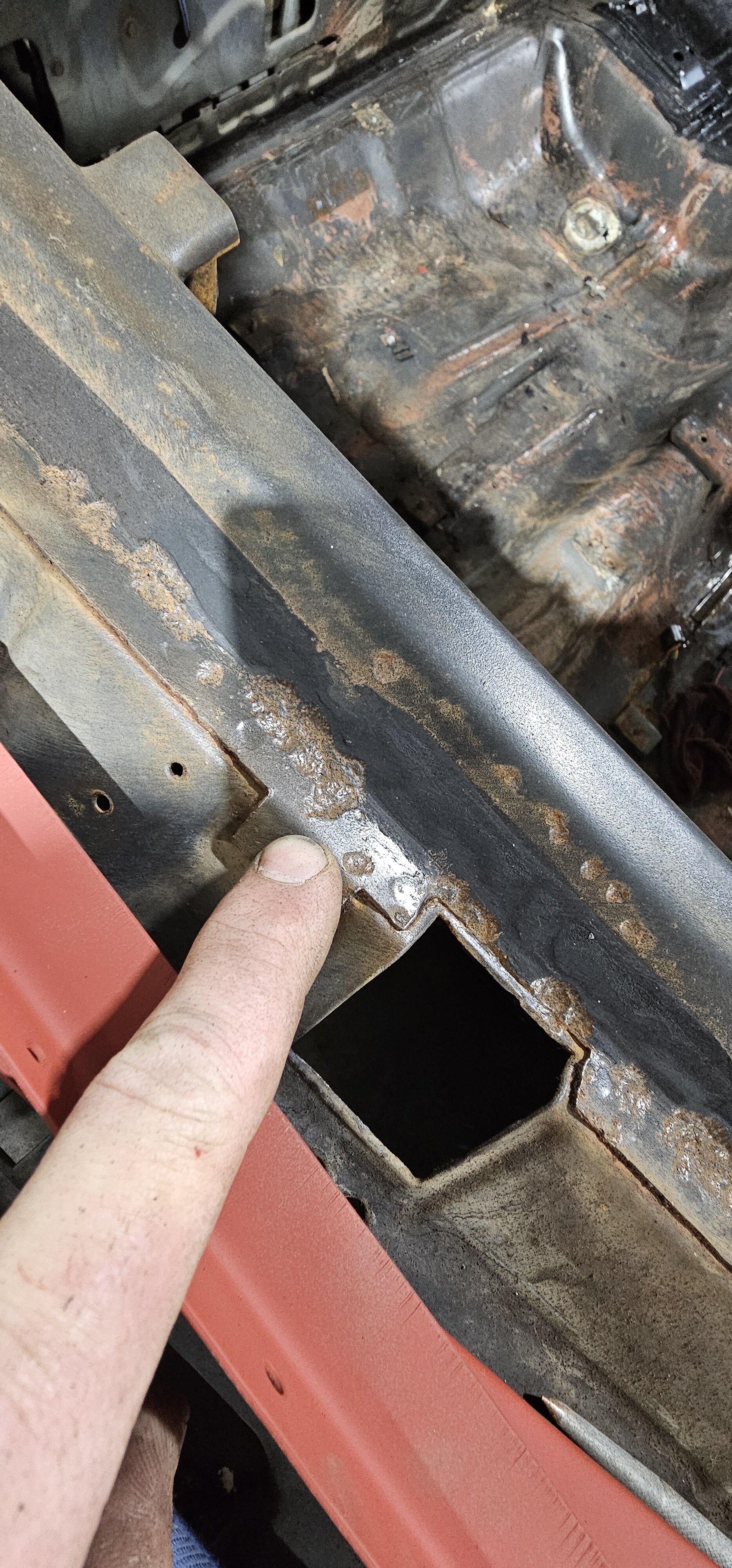

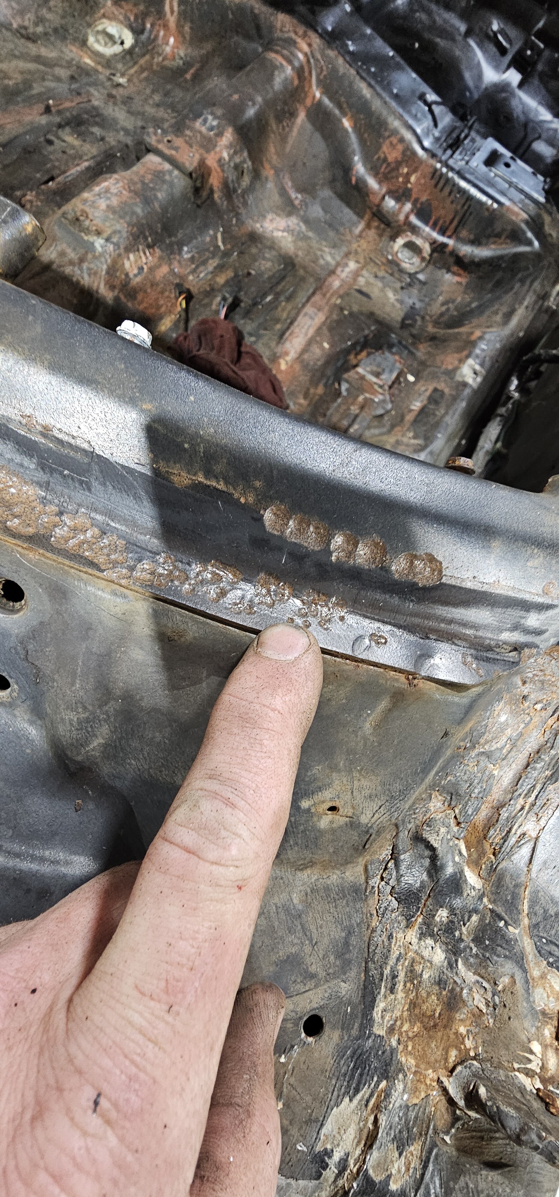

so I got the driver's side of the windshield sorted out for the most part. Then I realized that the welder wouldn't reach where it was at, so I decided it was time to yank out the rotisserie.
20241025_153330.thumb.jpg.757dd5bf66a8cf47a487be8c44eba828.jpg20241025_153326.thumb.jpg.44e518ea8db6c1e1996083610c114e40.jpg
So, now its official and sitting on a rotisserie....lol
