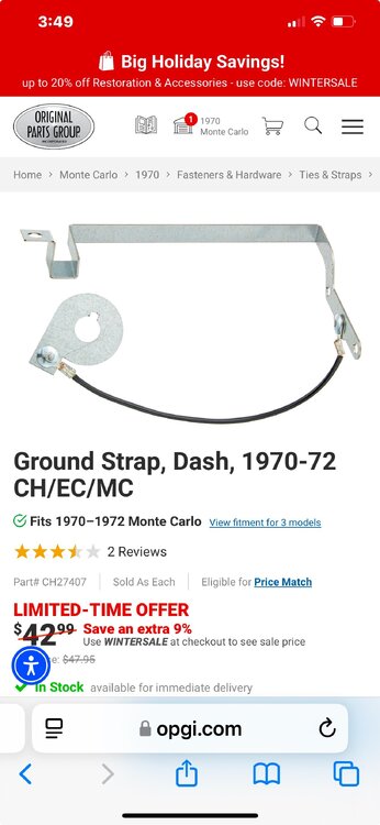

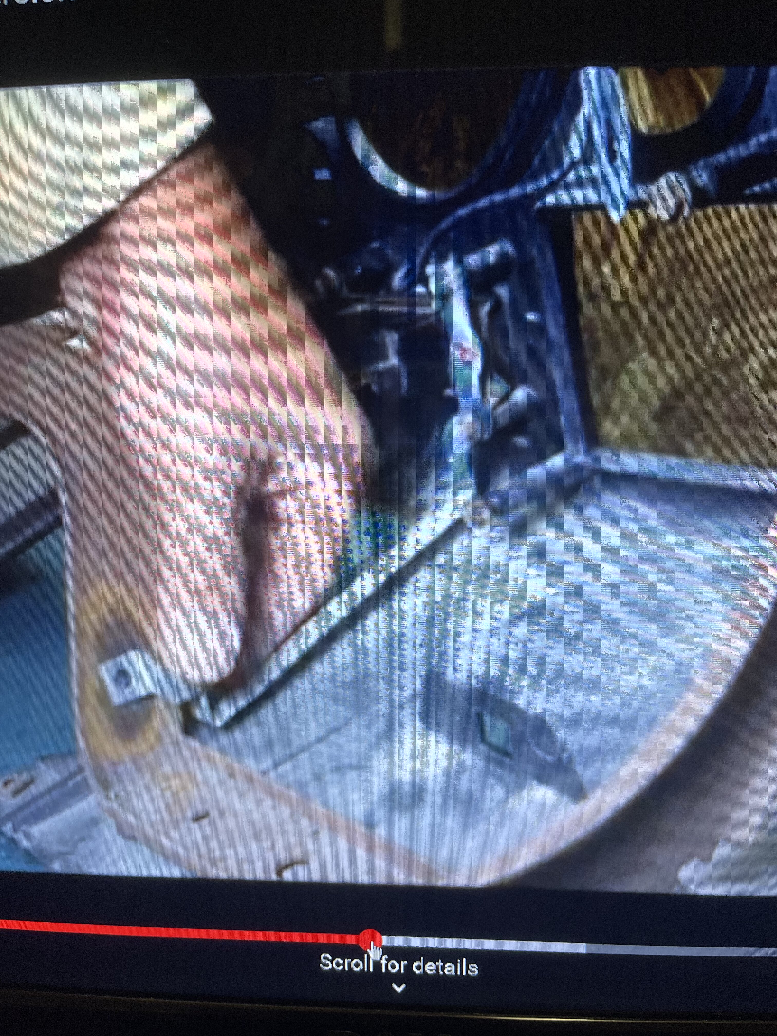

GRAY 70 Monte Carlo Posted June 30 Posted June 30 On 1/7/2025 at 8:05 AM, stangeba said: I found this picture of the back side of WS Wiper switch from my 71 Monte. I assume the black wire is the ground. Should have a ground brkt pictured below also has lead that goes to headlight switch 1 Quote
Paul Bell Posted September 7 Posted September 7 Yes, the wiper switch's metal housing must be grounded. It uses the same strap that goes under the headlight shaft nut. For 1972, the harness and switch were improved to have a wired ground to the switch which has an extra ground terminal. In use, the wiper motor and washer pump both get ignition + anytime the key is on via the black/dark blue/yellow wire. While the motor ground is from the motor case to mounting bolt strap, the first ground from the switch triggers the motor out of park and into low speed, the second ground from the switch triggers high speed. When the switch is turned to off, these grounds disappear and the motor cycles into park then off. Pushing the switch in forces it into low speed if it was off and sends a third ground to the washer solenoid to pump washer fluid. A small motor driven pump is available that fits into the stock pump housing which works better than the factory plunger pump. To ensure a better ground at the switch, I soldered a wire to the switch's metal housing. If the motor to mounting bolt ground strap is poor, the low speed resistor will smoke and you'll be off to the store for a new one. The ground strap is critical. I added a ground wire to the motor case. If you buy a rebuilt motor, make sure it has the correct number of terminals, the rubber mounting feet and ground strap before you surrender your core. 3 Quote
