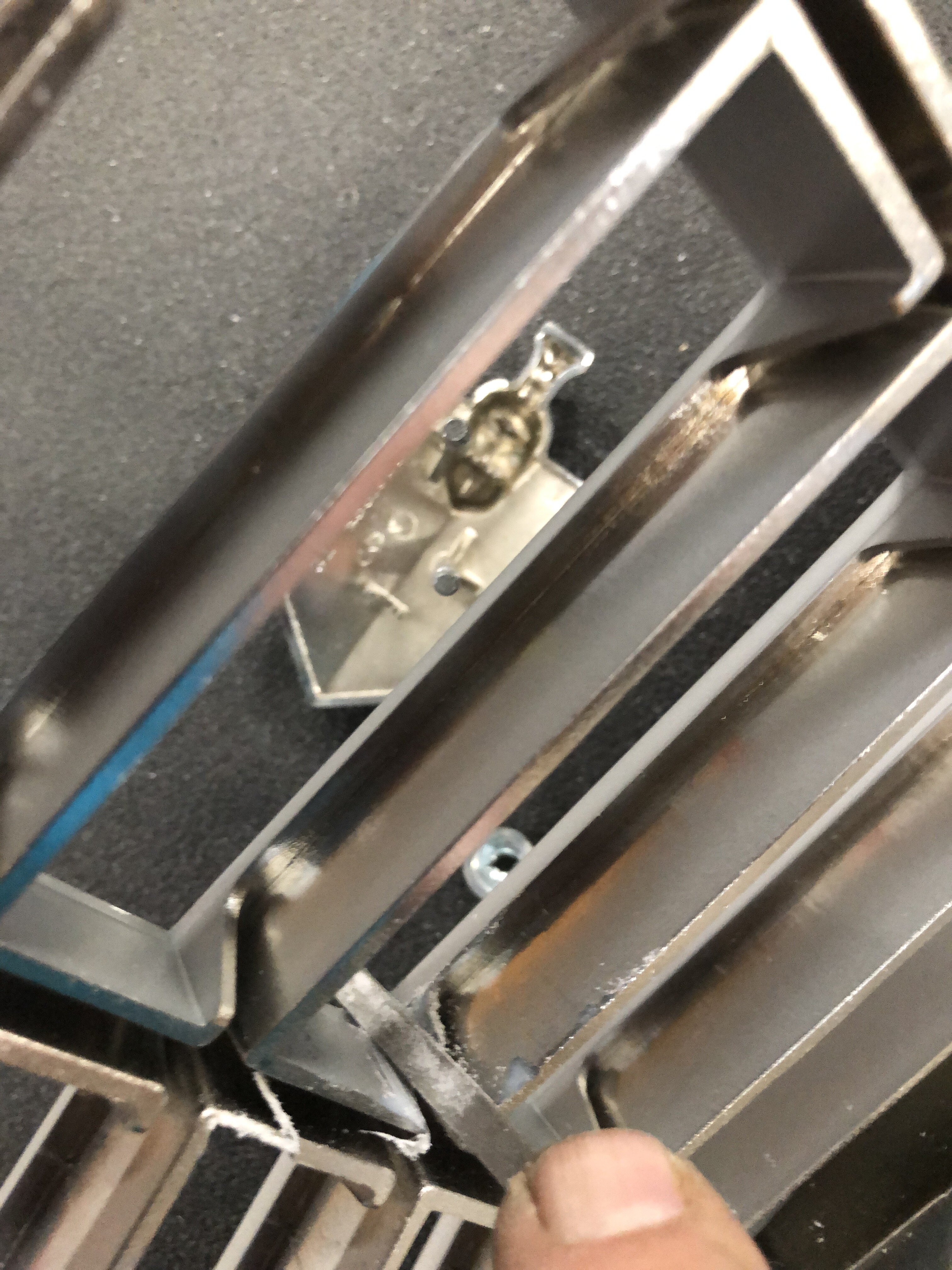

JUBAL Posted October 31, 2024 Author Posted October 31, 2024 I installed the new plastic 72 grille today. The old one was removed easily, although I had to get the three bolts from the bottom and I hate to lie down on the concrete but they came out easily. I took the old grill and removed my parking lamp bezels and lenses. Then I took off the center grille emblem. I placed it on the new grill and it was at about a 30 degree angle. They made the grille close enough but no one thought to see if the emblem fits. Trying to decide what to do and not wanting to put pressure on the plastic, I filed away at the corners of the grille that was keeping it from being perfectly vertical. Thirty to forty five minutes. The first photo as I am trying to fit it. It was far worse than that photo. Satisfied that it was now correct, the rest of the installation went flawlessly. Although I would caution about using any powered tools to crank the bolts down, as one can hear the plastic hollering at you. The only mistake is that the plastic in the center bar is wider than the stock item, for I measured it. With patience and filing the plastic it finally fit. The other option would have been to relieve the two studs for the emblem, but removing plastic was easier and no one can see it behind the red knight in the center. I bought mine from OPG last year with a coupon for $350.99 shipped. For the first time ever I have a grille that looks new, and saved at the least twenty pounds. Notice the excess plastic in the corner of the third photo that must be removed to get the emblem to be vertical. 3 Quote
jft69z Posted October 31, 2024 Posted October 31, 2024 Thanks for the update Jerry. I like the color of the car too, though I'm a little biased in that regard. I seem to recall I had to file the aftermarket front emblem I had installed when I did the car. Just like yours, it was not straight & took a lot of time to get it right. I understand that you measured the new grill though, and simply took the existing emblem off the old grill and put it on the new one, where it didn't fit. Anyways, thanks for the update! Joe 2 Quote
Marks71 Posted November 1, 2024 Posted November 1, 2024 It looks really nice. My main concern would be possible stress cracks in the future if the plastic was showing some resistance during the installation. 1 Quote

JUBAL Posted November 1, 2024 Author Posted November 1, 2024 34 minutes ago, Marks71 said: It looks really nice. My main concern would be possible stress cracks in the future if the plastic was showing some resistance during the installation. It really fit perfectly. I mentioned cracking if one used a battery powered wrench or small impact. With a ratchet one can feel when it is snug. Really no resistance I felt today. 1 Quote
