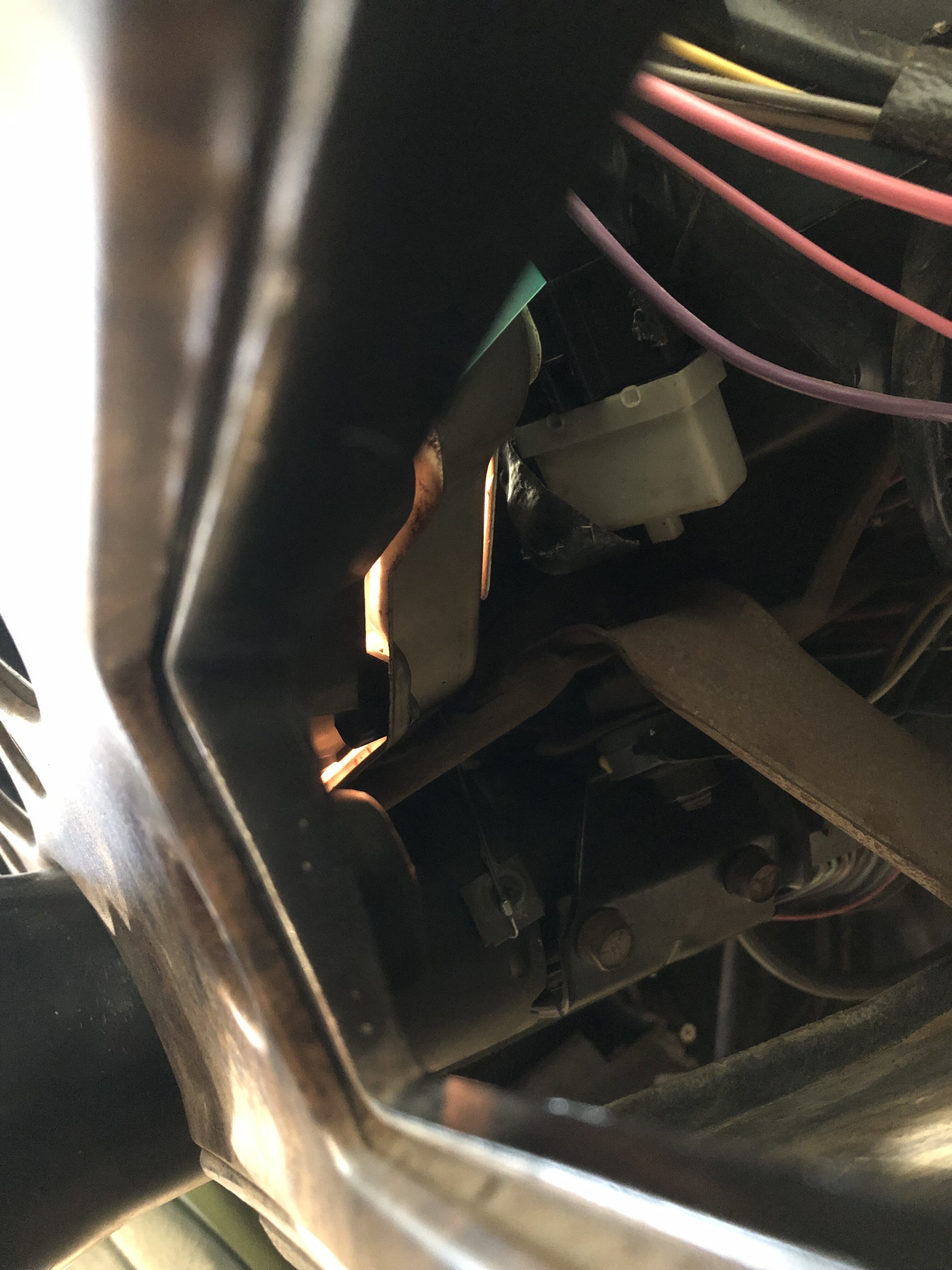

Chronicle Posted November 11, 2024 Posted November 11, 2024 Hey guys! I just reinstalled my instrument cluster with a fresh printed circuit because I had no lights before. Now I have warning lights, the light switch, the odometer, and can see other bulbs are illuminated from the back, but no other lights are shining through. Turn signals and bright/dim aren't working, either, but all exterior lights work. We replaced all the bulbs so we know the bulbs are fine. We just aren't getting any lights to shine through on the clock, speedo, and fuel gauge. Why won't they light up? We installed a new plastic gauge cluster housing from OPGI, by the way. Any ideas? Quote

Chronicle Posted November 11, 2024 Author Posted November 11, 2024 Yep! We have the grounds on and we turned the shop lights off. Like I said, we can see the lights are illuminated but they aren’t shining through. Should there be a gap between the plastic housing and the metal housing to let the light through, by chance? Quote

Chronicle Posted November 11, 2024 Author Posted November 11, 2024 Just going with the old incandescent 194’s, but I did try some LED’s I had lying around. They light up too (as per the pics), but can’t see anything on my instruments. There isn’t any gap as of now, but I didn’t know if there should be in order to let the light in the sides of the gauges. My current headlight switch seems to be working fine but I certainly could try a new one. Quote

1970mcss Posted November 12, 2024 Posted November 12, 2024 The cluster to me looks like it's not set correctly. The metal and plastic doesn't seem to be seated correctly. I'll look for a picture of mine out of the car. 2 Quote
