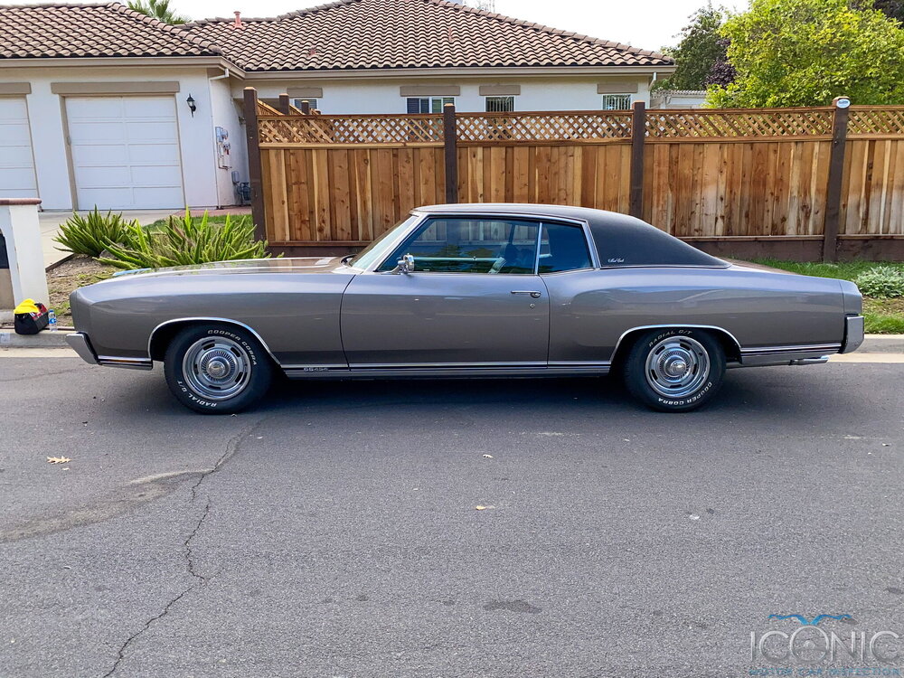

Scott S. Posted November 13, 2024 Posted November 13, 2024 Hey Craig, Keep in mind tire clearances when you lower your Monte.... Here's a picture of Montelishi when I first got her. Just a bit taller than factory. 4 Quote

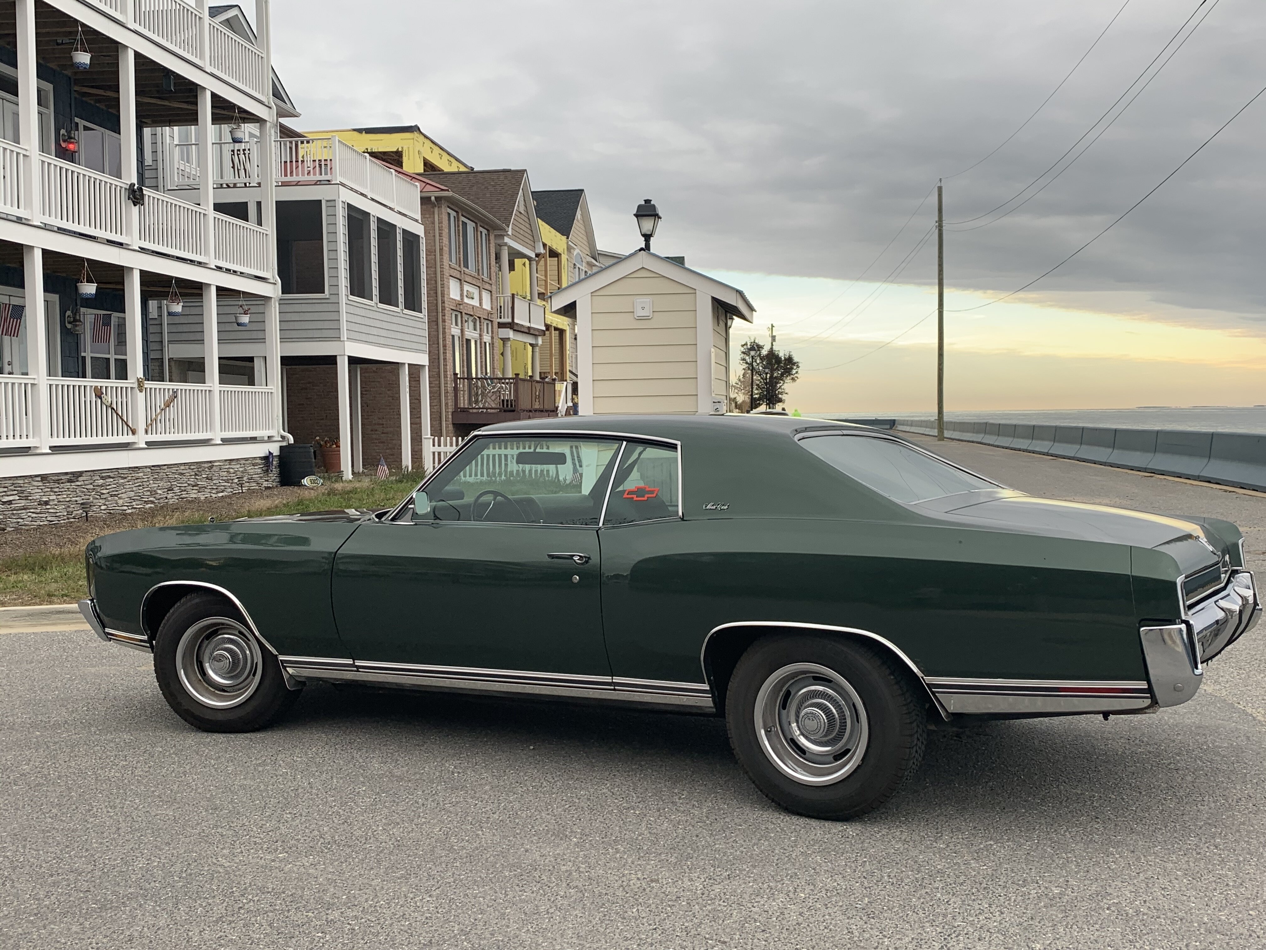

cny first gen 71 Posted November 13, 2024 Posted November 13, 2024 This is mine I'm sure it's higher than it was from factory but it's the way I want it. 5 Quote
Rob Peters Posted November 13, 2024 Posted November 13, 2024 1 hour ago, cny first gen 71 said: This is mine I'm sure it's higher than it was from factory but it's the way I want it. Steve, yours looks real nice on the height. The front looks fairly close to normal height but the rear looks to be maybe 3- 4 inches from factory. Your height fits the hood and wheels nicely. rob 2 1 Quote

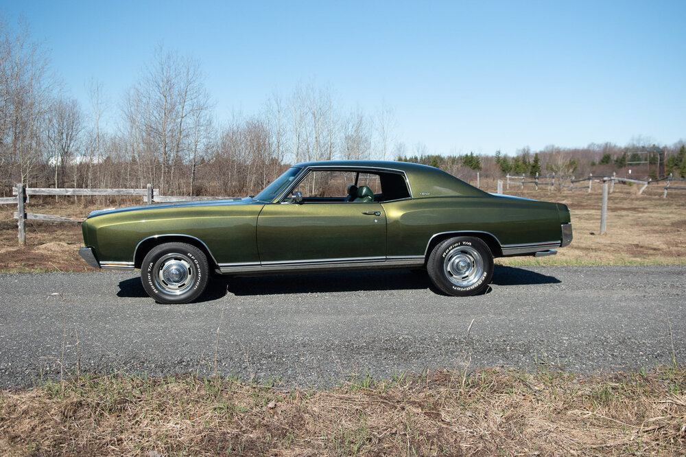

420ponies Posted November 13, 2024 Posted November 13, 2024 this how it is going to look again after the coil over install . 235/60/15 fronts, 275/60/15 rears.from the ground up to the center of the wheel well trim, front 24", rear 25". 4 Quote

Michael Boyte Posted November 13, 2024 Posted November 13, 2024 1 minute ago, 420ponies said: this how it is going to look again after the coil over install . 235/60/15 fronts, 275/60/15 rears.from the ground up to the center of the wheel well trim, front 24", rear 25". Jim , is that with the new coil overs ? If so , The stance is great 👍 1 Quote
420ponies Posted November 13, 2024 Posted November 13, 2024 This is the same tire size , with Moog Vari-Rate Rate (CC 507) rear coil springs ,air shocks with 25 psi ( just so they work). 3 Quote

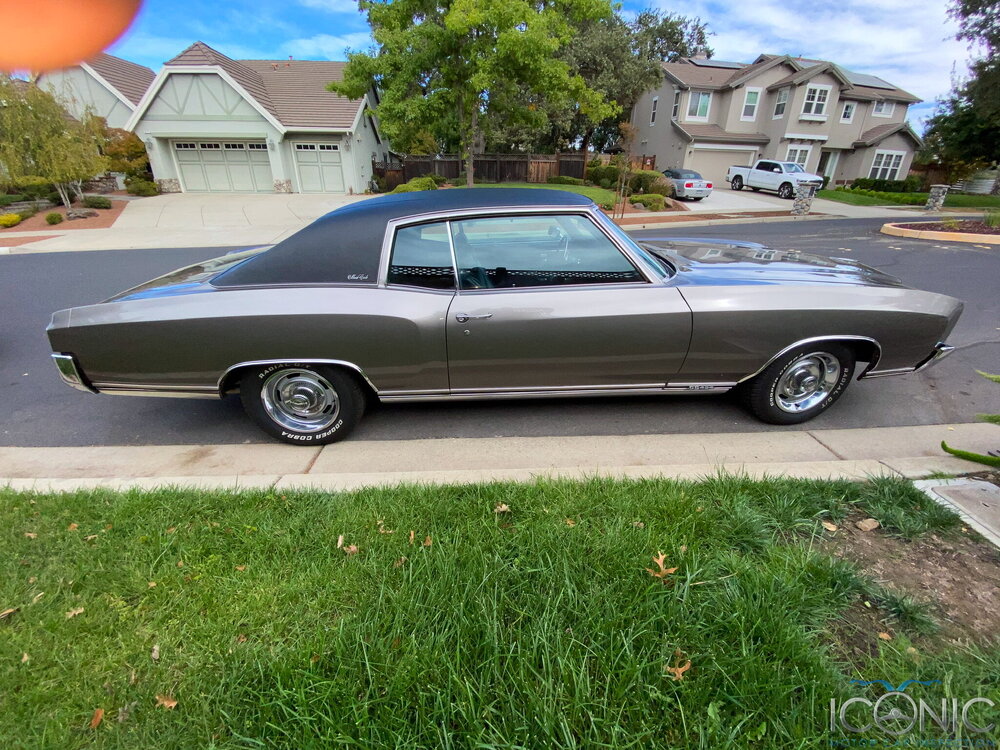

Glen Posted November 14, 2024 Posted November 14, 2024 7 hours ago, DragCat said: I think your ride height should optimize the suspension upgrade over looks, just my .02 Agreed. My ‘70 arrived with the QA1’s at all 4 corners. While the stance looks nice (subjective, of course) the ride is garbage. It’s jarring and reminiscent of how go-karting feels when you’re too old to be go-karting. Returning to OE-style springs and shocks (perhaps with a coil or 2 removed) is in the “YES” column when she goes in for refreshing next year. The QA1’s will then be making their appearance for sale here along with the Ron Davis rad and fans. 4 Quote

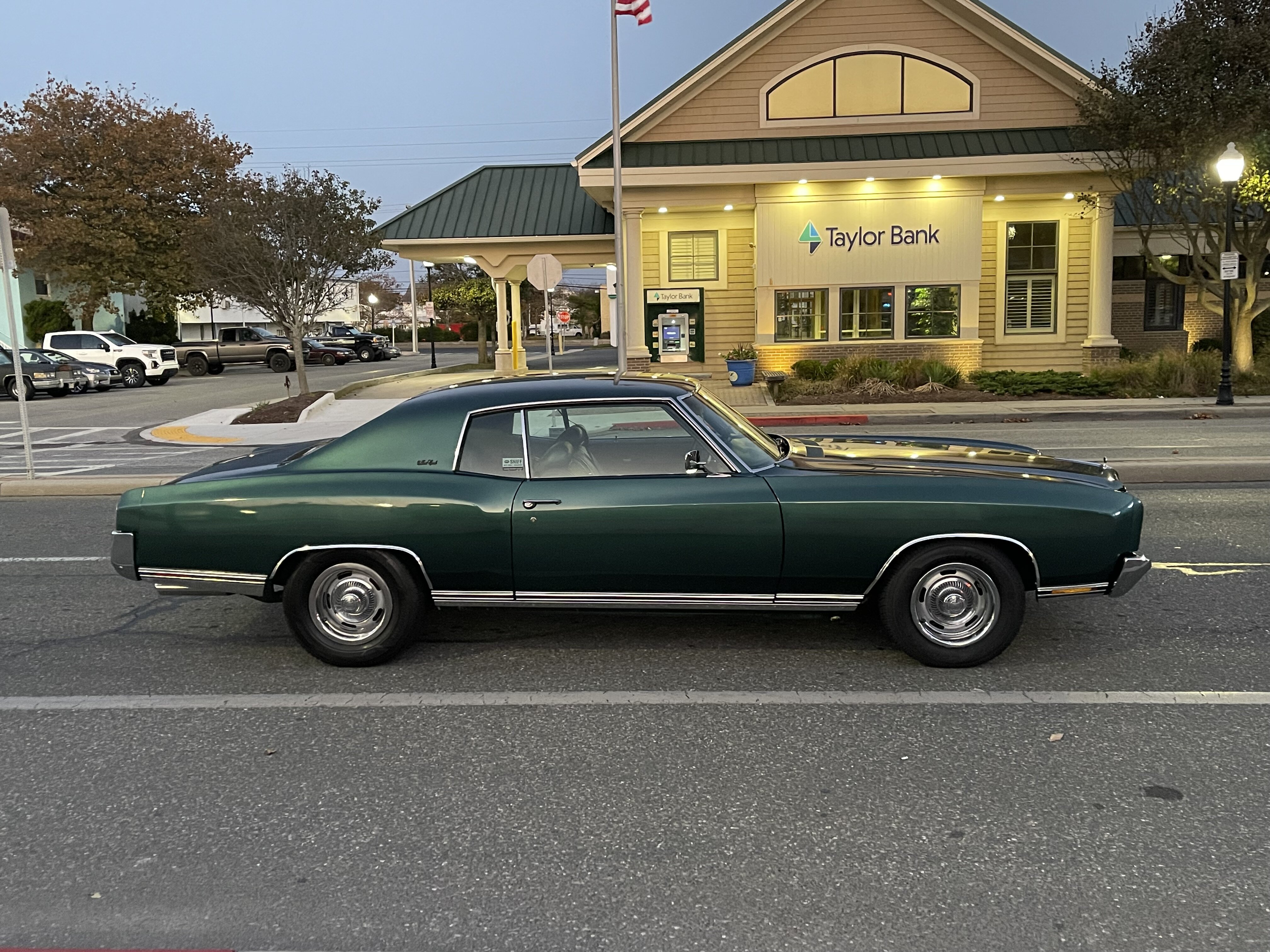

Traveler Posted November 14, 2024 Posted November 14, 2024 QA1’S installed on all four corners (small block springs 500#?) the info stated it would lower the car 1” The left photo is with QA1, the right stock(I assume it still has the original front springs but the rears springs may have been replaced. I set it up level. 3 Quote
Glen Posted November 14, 2024 Posted November 14, 2024 2 hours ago, DragCat said: I like the "ICONIC" watermark on the photo's These pix were taken at the seller’s residence by the inspector I hired to give the car “the full Monte” (see what I did there?). 1 2 Quote
