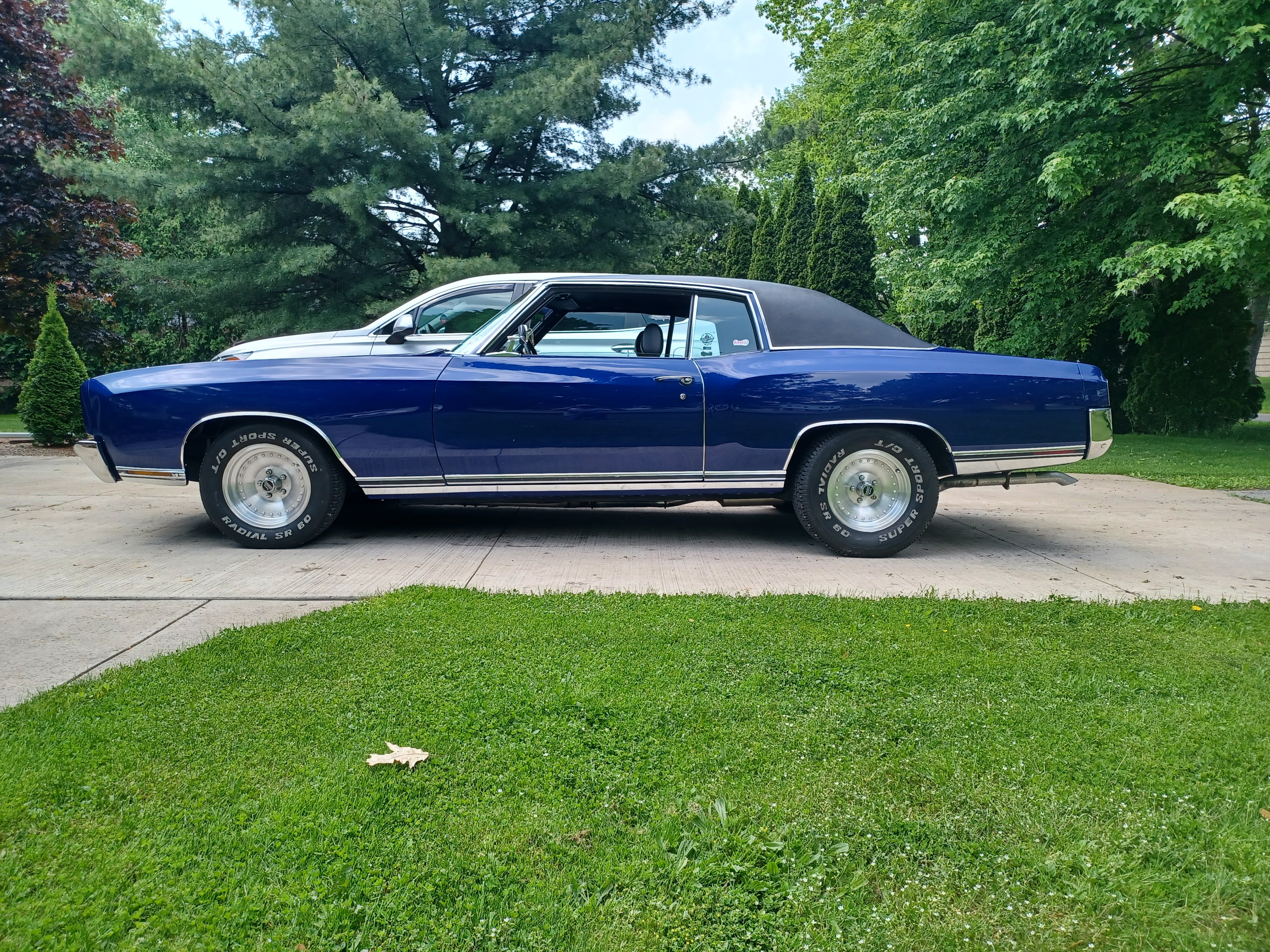

Whons Posted January 2 Posted January 2 I rebuilt my front suspension,cut 1" of length off new front springs. front tires are 235/60/15. Back tires are 275/60/15 7 Quote
420ponies Posted January 2 Posted January 2 1 hour ago, Whons said: I rebuilt my front suspension,cut 1" of length off new front springs. front tires are 235/60/15. Back tires are 275/60/15 Still digging' those wheels!! 3 Quote
