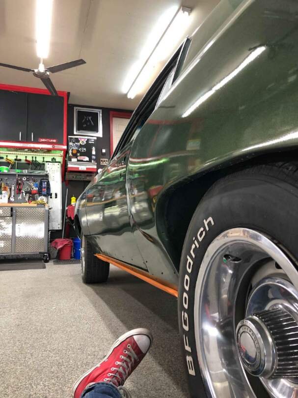

Merry Christmas to all. I’ve been getting mixed responses and I’m hoping for a definite answer. I have a 1970 Monte Carlo. I’d like to put my 15x8 4” offset rally wheels on. The front tires are 215/70/15 and the rears are 255/60/15. Will these go right on without any clearance issues? I have stock suspension
IMG_2858.thumb.jpeg.f6e3fa41340c46320c243e04fb4f9cd7.jpegIMG_2859.thumb.jpeg.b53ac0f1f105760c6718ae63a46a297c.jpegIMG_2860.thumb.jpeg.66d841edebe868f93b6b4f42899b1c65.jpeg

I'm using the same wheel/tire on the back of my '70, and they've got clearance, but I'm boosting the springs just to level the car out.

I have a set of those Vette rallys (15x8 with 4” backspacing) with 245/60 tires on all 4. I have mounted them on three different first gen Montes and all of them had a clearance issue on one side or the other in the rear. I have heard if you have a Monte with a perfectly centred rear end you may be able to have just enough clearance with Vette rallys and 245 tires.
I had to bend the lip on the quarter a little for clearance. A friend of mine locally had to do the same for his 1971 Monte with 245 tires on Vette rallys.

Ok, thanks again Aaron. I appreciate the elaboration. I’m now convinced that this setup will not work for me. If you had problems with 245’s then these 255’s definitely won’t work.
