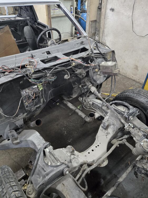

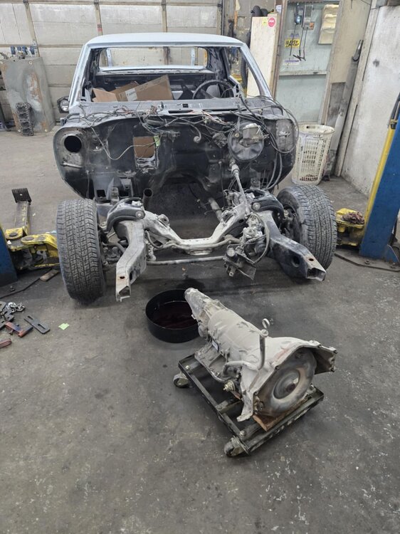

71SSclone Posted January 23 Posted January 23 I'm thinking, since the car is completely apart, why not replace the wiring harness. It's hacked, cut up, and full of bad connections. I was looking at a harness from American Autowire. Has any else used them? Is the harness complete, with options already built in (AC, power windows, redefrost, etc)? Does anyone have any other suggestions? I've heard Painless wiring is anything but "painless". Any other ones that can be reccomended? Thanks for the help. John Quote
B-Man Posted January 23 Posted January 23 My $0.02 ... If your car is completely apart, you've got the funds - and you're DEFINITELY going to put it all back together some day - then yeah, why not?!?!?! It will certainly 'show' better and you will likely have less quirky troubleshooting to do down the road. https://americanautowire.com/collections/chevrolet/products/classic-update-kit-1970-72-chevy-monte-carlo-510336 My 72 is not taken completely apart, so a new wiring harness would be quite a feat. Not impossible of course. I've already put a bunch of hours and $$ trying to figure out all the wiring hacks from the previous owners - some good, some bad. At some point I will easily spend $1,126 in hours and real dollars, no doubt 3 Quote
71SSclone Posted January 23 Author Posted January 23 It’s as far apart as I’m going to take it. She has all new sheet metal, so it is definitely going to go back together!! 3 Quote
Scott S. Posted January 23 Posted January 23 I'd think that that's probably as far as you need to go regarding access to replace the wiring. I've heard good things about American Auto Wiring...... And they can ever be bought with a new fuse box already attached. 1 Quote
jft69z Posted January 23 Posted January 23 2 hours ago, 71SSclone said: I was looking at a harness from American Autowire. Has any else used them? Is the harness complete, with options already built in (AC, power windows, redefrost, etc)? Does anyone have any other suggestions? I use the AAW harnesses. Very good setup, and detailed instructions. Not exactly an easy job, but with careful planning and attention to detail, it'll far exceed the factory harness. They do not include the A/C or power window harness, but they do offer them separately. I'll typically replace the A/c harness, because they're usually botched up anyways, but if the power window one looks good, I'll re-use it. Maybe replace the rubber boots if they're ripped up (between the cowl and into the door), and clean up any tarnished connectors. 7 Quote
