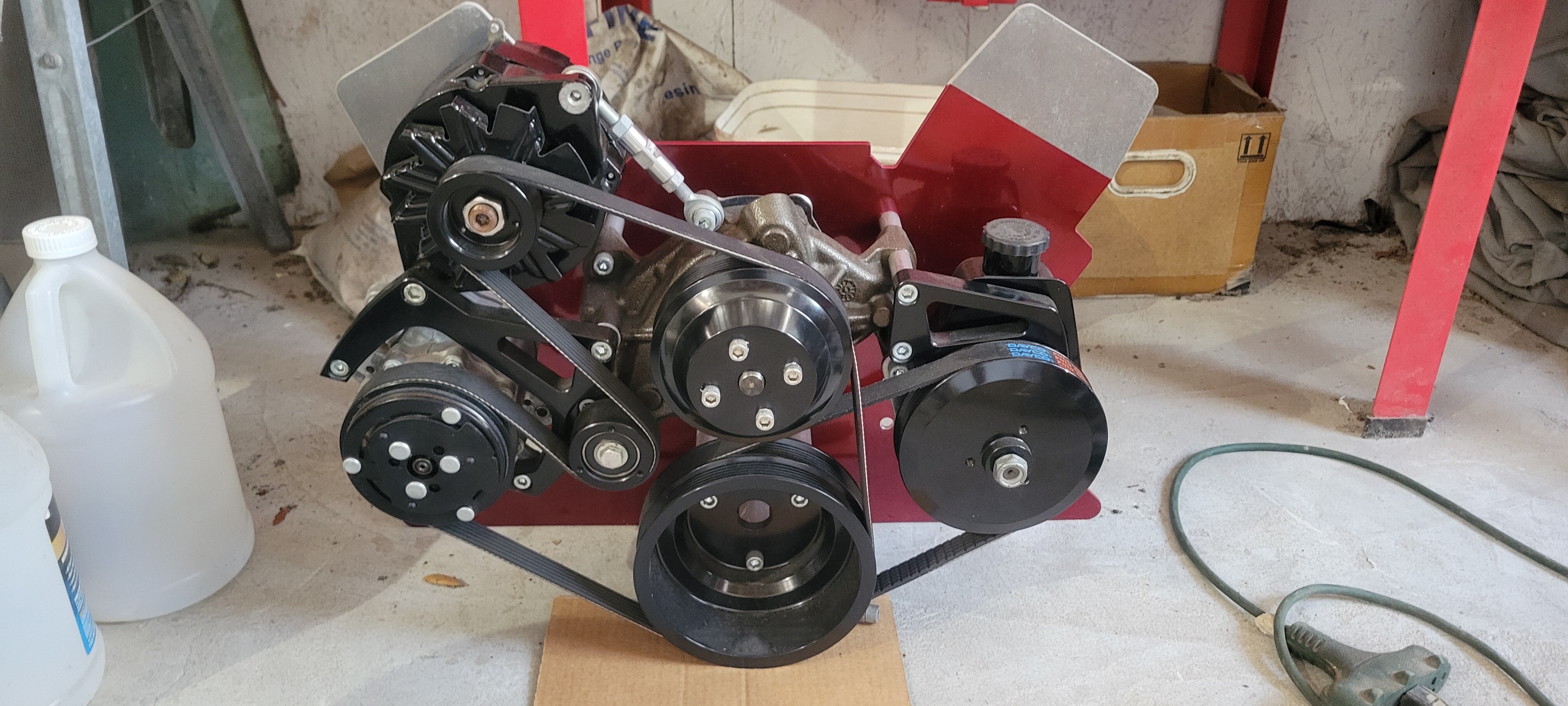

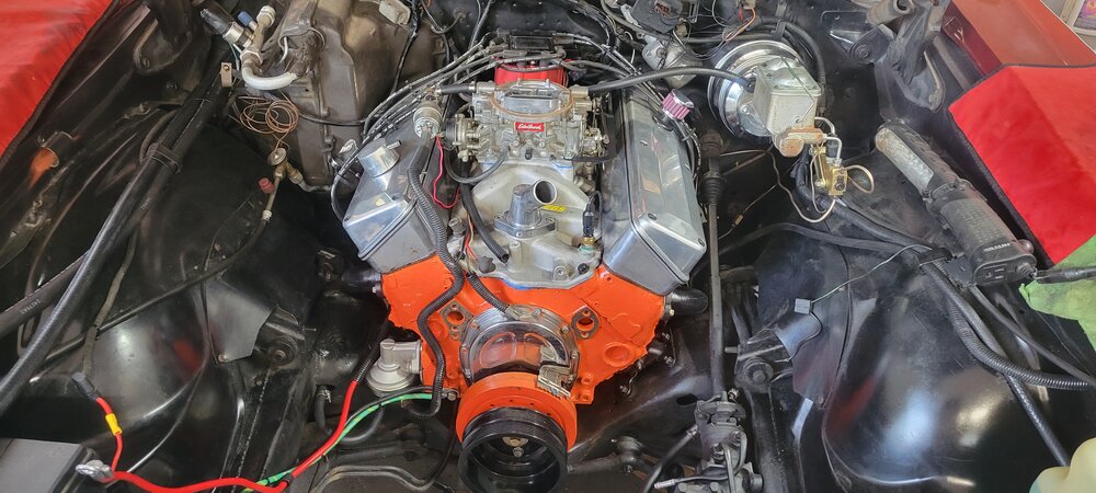

BobW Posted April 28 Author Posted April 28 Working alone,got the new motor in, lots of crawling under the car, crawling out to push & wiggle the block into position. Used a rachet strap around the crank to get the angle close to matching the trans. Two bolts started an slowly pulled the pair together, again out from under the car to lower the crane. Pics of the empty bay and the motor ready to go in. New front seal on the trans, torque converter bolted up, still need to install the headers then I', done under the car! I'm too old for this, too tired to take a pic of the motor bolted in! 🙃😉😪 5 Quote

BobW Posted April 29 Author Posted April 29 OK, motor is in, headers & exhaust connected, car is back on the ground. Much easier to stand in front of the motor to connect everything else! Fired right up as soon as it got gas to the carb. Tomorrow I'll work on the March Performance mid-mount system. 11 Quote
