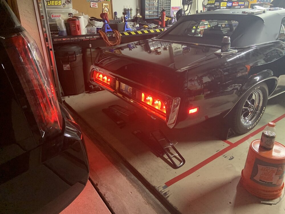

I have done the rear tail lights conversion, very happy with that 🤘So much so I bit the $ bullet and did the Cougar too.

On the Monte tail lights you needed (at least for the product I bought) pigtails for the 1157 bulbs . No biggie, I hate cutting OEM harness's. I shouldn't say you needed the pigtails, but it made the upgrade ez-peezy. The down side of the Cougar was the sequential tail lights, you had to change ALL the turn signal bulbs and the sequential module and Both flasher cans. The upside was the LED bulbs were plug and play for the original sockets. Even the rear side marker bulbs. I tried to do the IP but they didnt work and support was not helpful.

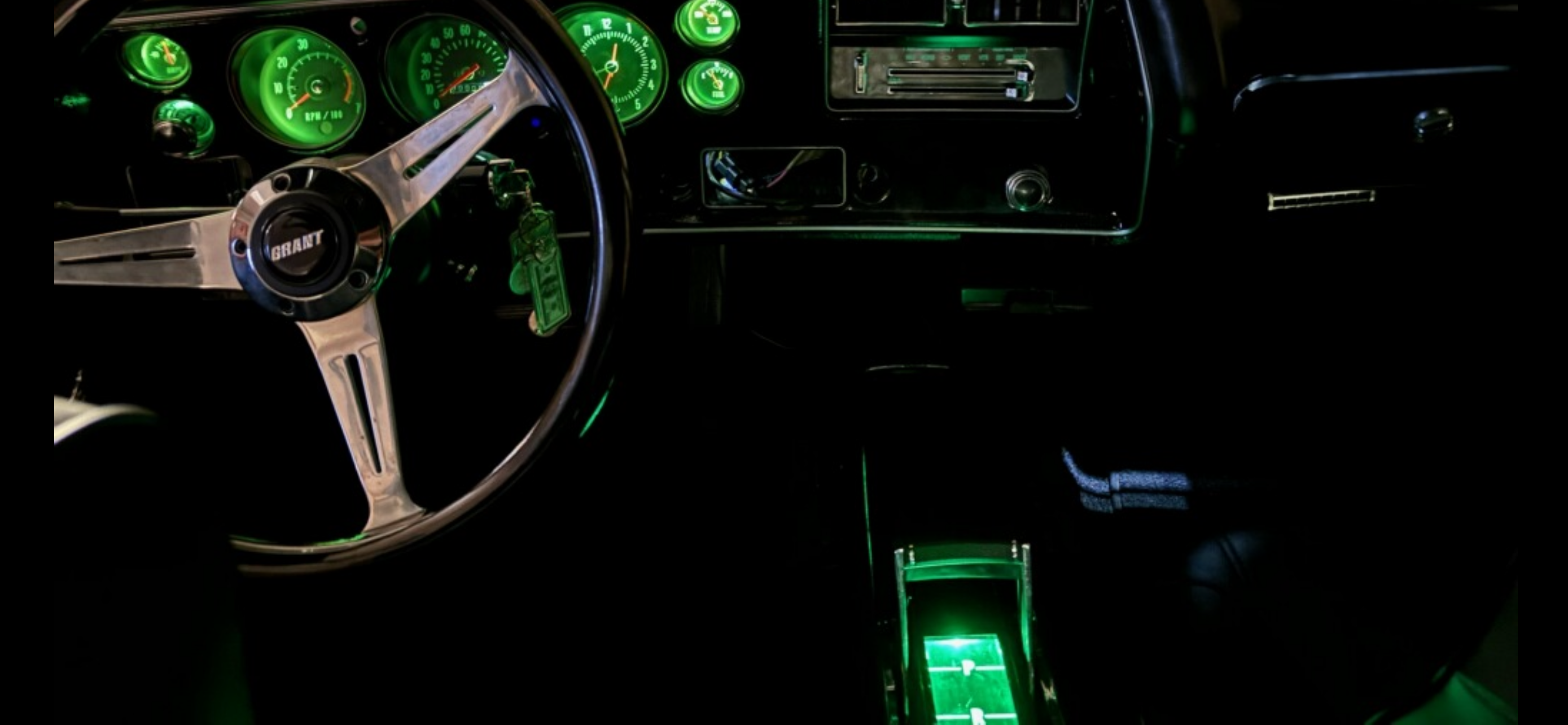

I have not done any leds on exterior yet but after all the pictures of ones all the folks on here have done I am sure it’s just a matter of time. I did replace all interior lights including IP console shift indicator IMG_0218.thumb.jpeg.e6e62312b5fbe91b2ea7440865e1a0e9.jpegI thought the indicator was a little bright white not enough green so I add led green bulbs IMG_3564.thumb.png.0c1f66bcd899d717cb66a87d736e8d3c.pngIMG_3318.thumb.png.fee600bd7fd4e488b534b5a962338aa9.pngfor my personal taste I like the shift indicator matching the dash a little better. I also add console ad dome lights to led all dimmable the only change I had to make was reversing the polarity on the climate controls
Looks good, and thanks for adding the source of the bulbs Of course I like the green option
