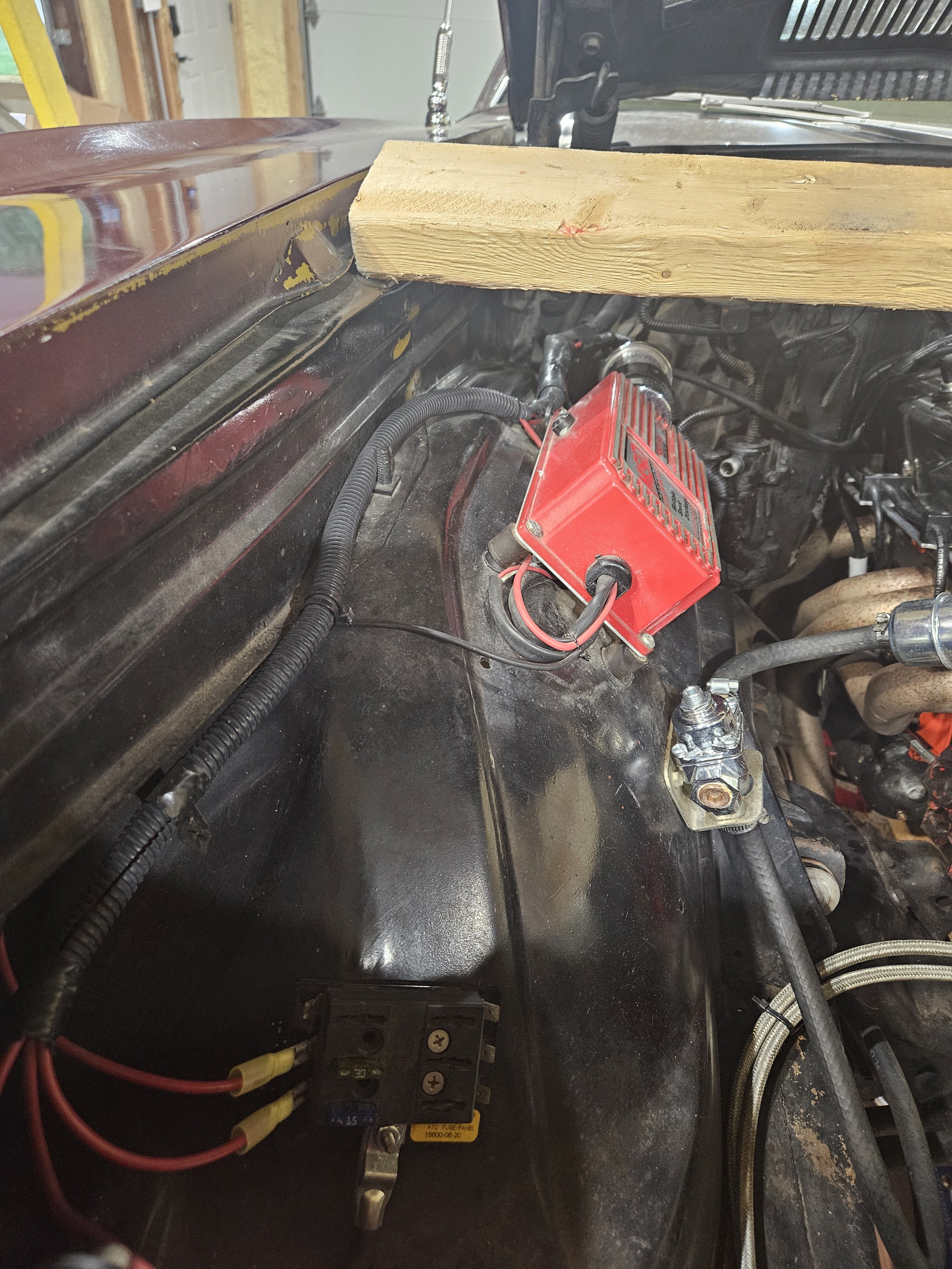

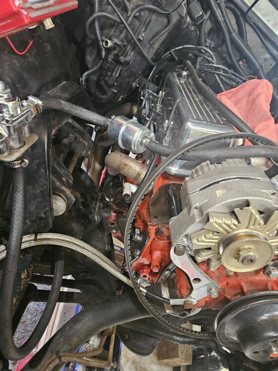

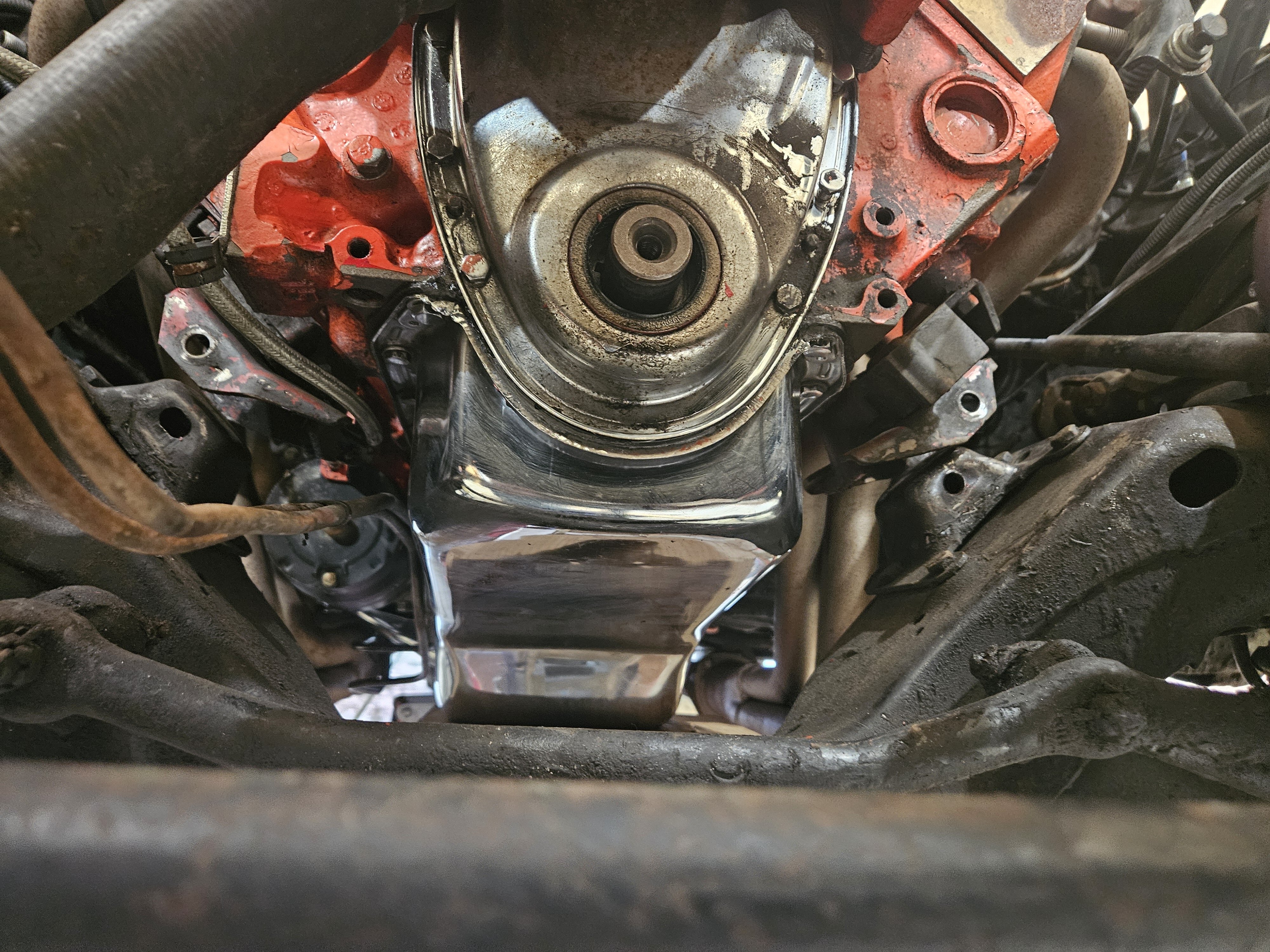

jbird72 Posted May 31 Author Posted May 31 21 hours ago, jbird72 said: So got everything perfectly safe...have distributer cap off engine unbolted..rear tranny unbolted from frame. No fan or shroud replacing balancer when comes in to 8in...i cant get darn thing to lift without car...if i have some lift on it i can get a pry bar just to see if motir will budge and it will from side to side a scooch no prob...what im i missing here. See pics 1 Quote
Dtret Posted May 31 Posted May 31 Headers hitting the frame? is the back of the engine hitting the firewall? 2 Quote
jbird72 Posted May 31 Author Posted May 31 10 minutes ago, Dtret said: Headers hitting the frame? is the back of the engine hitting the firewall? This is as high as shell go 11 minutes ago, Dtret said: Headers hitting the frame? is the back of the engine hitting the firewall? This is high as shell go i just gotta think what to put in betwixt 1 Quote

Scott S. Posted May 31 Posted May 31 I'm assuming you've got the inspection pan off at the fly wheel, and if you remove the starter, you should be able to wiggle the pan out. Quote
Scott S. Posted May 31 Posted May 31 Just now, Scott S. said: I'm assuming you've got the inspection pan off at the fly wheel, and if you remove the starter, you should be able to wiggle the pan out. And block the heck out of the motor mounts.... Quote
jbird72 Posted May 31 Author Posted May 31 14 minutes ago, Scott S. said: And block the heck out of the motor mounts.... I might just run 2 by 4 across the fender supports inside of course.. and ratchet strap. It aint that much weight ..moroso oil pan goin in Quote
jbird72 Posted May 31 Author Posted May 31 2 minutes ago, jbird72 said: I might just run 2 by 4 across the fender supports inside of course.. and ratchet strap. It aint that much weight ..moroso oil pan goin in Cause i got trans supported also 1 Quote
Scott S. Posted May 31 Posted May 31 Like I mentioned, removing the starter and inspection plate should give you more room to work as well. Quote
Scott S. Posted May 31 Posted May 31 Just a thought, but the radiator hose might be causing a bit of binding too.... 1 Quote
jbird72 Posted May 31 Author Posted May 31 Just now, Scott S. said: Just a thought, but the radiator hose might be causing a bit of binding too.... No its on fire wall worried may have hit trans fill but i didnt force er...yeah for sure cover and starter gonna come off. Gonna re wrap wires cause of header anyway. So funny started off with a carb swap. Lol...now .oil pan ..balancer..adjusting valves...replacing rear main and valve gaskets. And now motor mount. Lol 1 Quote
