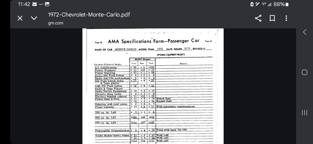

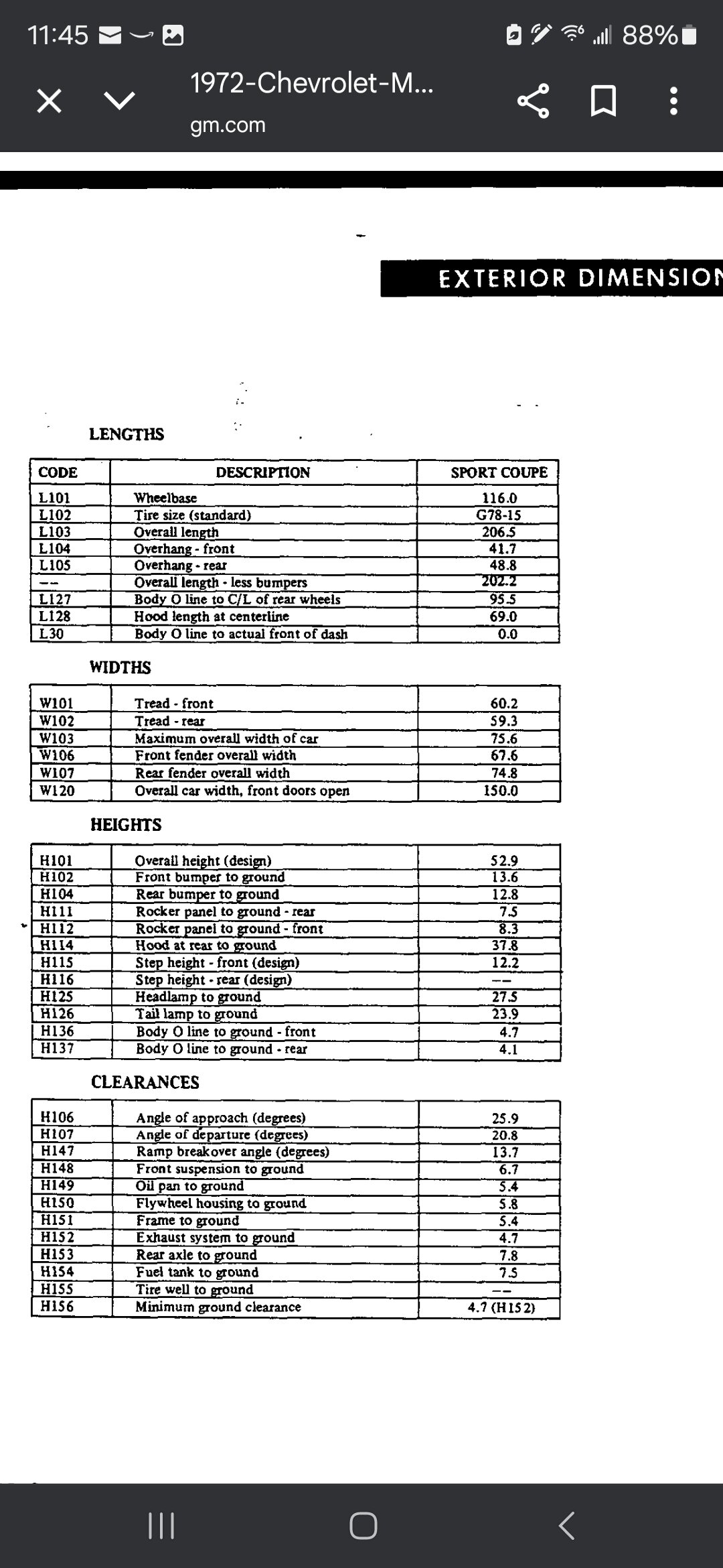

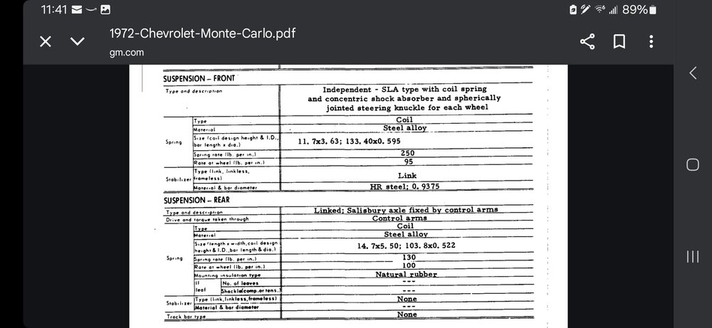

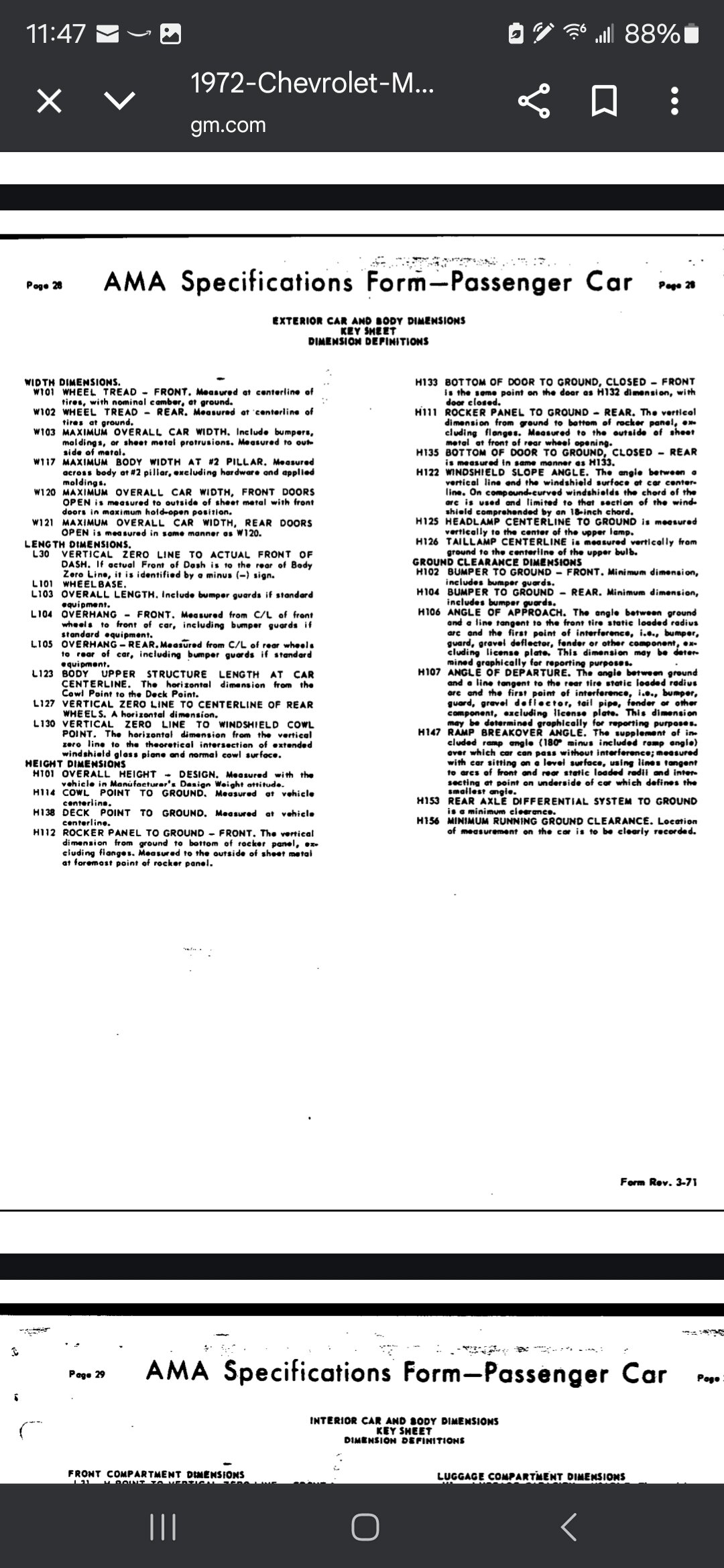

I got mine at summit racing. Engine size and if you have A/C.
More.  Mine is a 1972. But try and find the info from the topic on the page.
