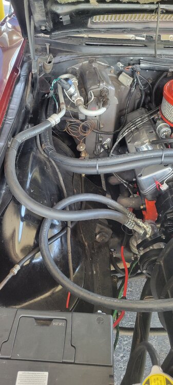

Finally got AC hoses made for the Sanden compressor on the Passenger side.
The stock compressor switch wire has a resistor that was mounted to the body (ground) of the stock compressor. Is that resistor necessary on the new Sanden compressor?
What does Sanden say about it?

Jim, you're always the voice of reason! Just sent them in inquiry, I'll post their reply when I get it.

It's an SD-7B10 that came with a March Performance accessory mid-mount system.

Purchased from a private seller. You can look here: https://marchperformance.com/
You could go with an S6 compressor It looks similar to  A6 hooks up the same no hoses to change and has Sanden guts i have been told. I have a chrome one and it works great.
