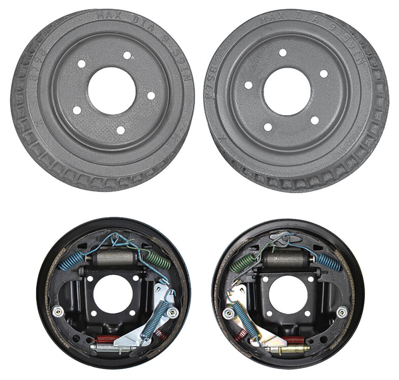

First of all, did you set the cylinders ???
There's a little port that allows you to dial them with a flathead screw driver. The "toothed" ring on the cylinder.
Also, did you set them by driving and operating them in reverse ??
Sorry, not on the cylinder, but the spacer on the bottom.
My mind gets ahead of itself sometimes.  ;)
That's called the "adjuster".
