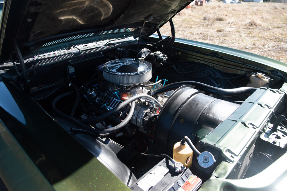

This is what Montelshi came with.
I've remodeled the hose and tank cap.......
Works fine.  :)
