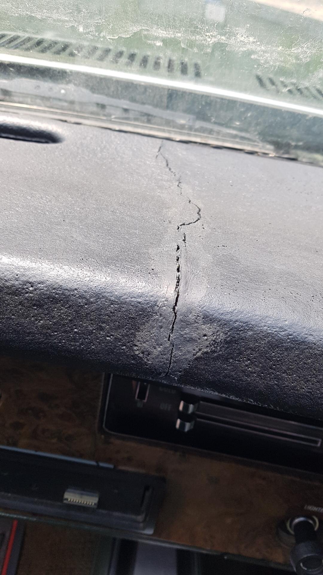

I took a run at it a couple years ago. Used a poly resin to fill in the speaker holes as well as the cracks. The coated it in black spray on undercoating.
The holes turned out fine, but the crack was to big to take. After one season it split again.
I've been thinking about taking another shot at it, but not sure if it's worth it. :(
Dash before repair.

dash2.thumb.jpg.da167ca2ed3619011b84fd248a6bcba6.jpgdash1.thumb.jpg.f9100533557450d7624b72c01ef75524.jpg
A year after dash repair....
All the other dry cracks filled in nicely, but the big one came back to haunt me.  :(
