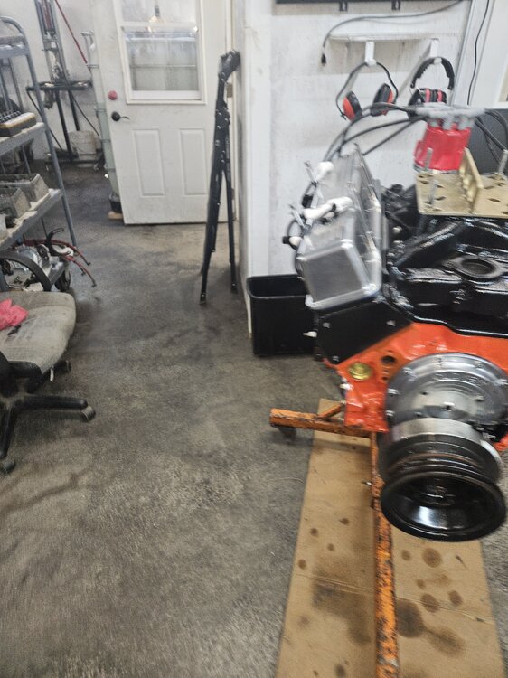

Almost done decided to paint intake black im thinkin. That bare cast is hard to keep new lookin ..should be on dyno by weekend!
Man, What size is that harmonic balancer? Looking good! Let's make some torque!
Its for a sbc 1st gen. Its like a hi po one i guess same one as chevelle or vette same year the old one was chewed up might had somethin to do with bent crank. 8 inch

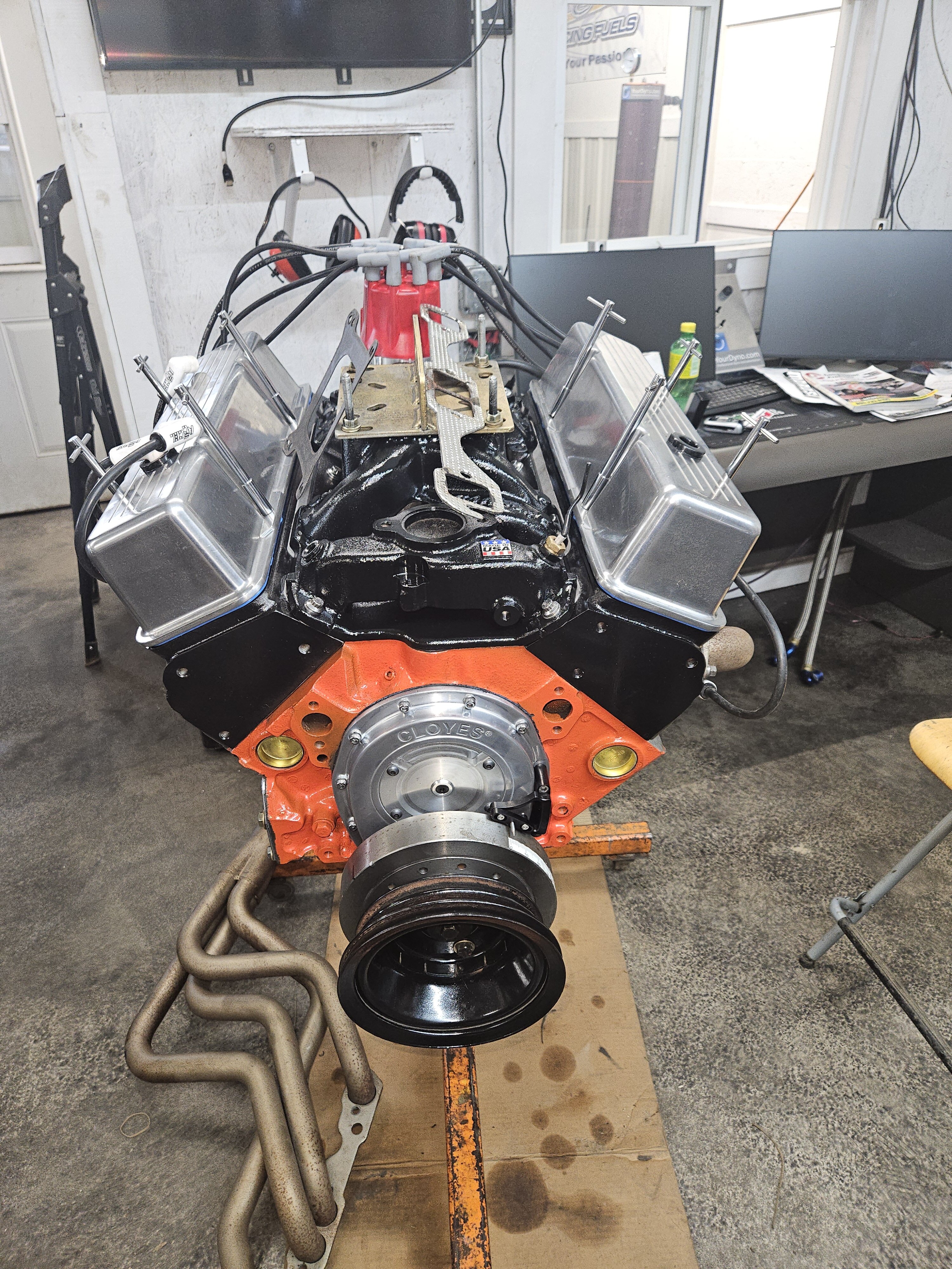

Ok scott so maybe is a cursed block. Warming it up doin break in on dyno. 3 times of course all three inbetween and waiting for motor goto cold then warm up. Prolly 6ish hours. Motor shows decent power at 3900 rpm thats all weve done so far started at 354 hp and 418 tq and by 3rd run 3900 still is now at 380 and 438 tq. Should be a decent motor timing at 35 right now carb still not adjusted ..so should be better than 355. But heres the cursed block deal..we soaked and cleaned out the block of course before build lots of rust came out turns out that build up was sealing 2 small pin holes. So the water jacket is leaking  fml...still movin on tommorow should be broken in enough to see what she does...proper timing...carb..maybe cam..adjustment. so thinkin can weld or use that block putty [censored] and do all the bottom if doesnt work gonna have to get new block.  Could of had a bbc for money wouldnt of been a built one so well see
Edited by jbird72
  • Sad 1
Here we go. Got er dialed in. Pretty happy again flat tappet cam makin great power on pump gas according to sheet runnin rich but she wants  more fuel. Weird
2 hours ago, Scott S. said:
More fuel, or more air ???
Might think about a higher CFM carb.
Its 750 dp...i put 850 qf for giggles my buddies got like 7 more hp.and 8 ish lbs tq more. Nothin real noticable  in car. So gonna stay with 750 i think. It was also in a controlled environment with humidity. So on a cooler day, it might not matter
You run what you have on the street. They always do more on the dyno. It's the street that matters. Looks good to me running rich as you say, nothing wrong about that. Nice SBC!!
Yeah, I think I'm gonna stop fighting for one more horsepower. I think we're good if I go to the roller cam. It's gonna cost an extra 1000 bucks. I'm gonna have to take it apart and I think I'm okay with what I got. You know, it's a great street motor and at the strip, it might be kind of fun, just to kind of see what it will do

Im done. Pretty happy with it out of car so far respectful with a flat tappet and iron heads...the 3500 stall  and 373 rear should pair nicely
