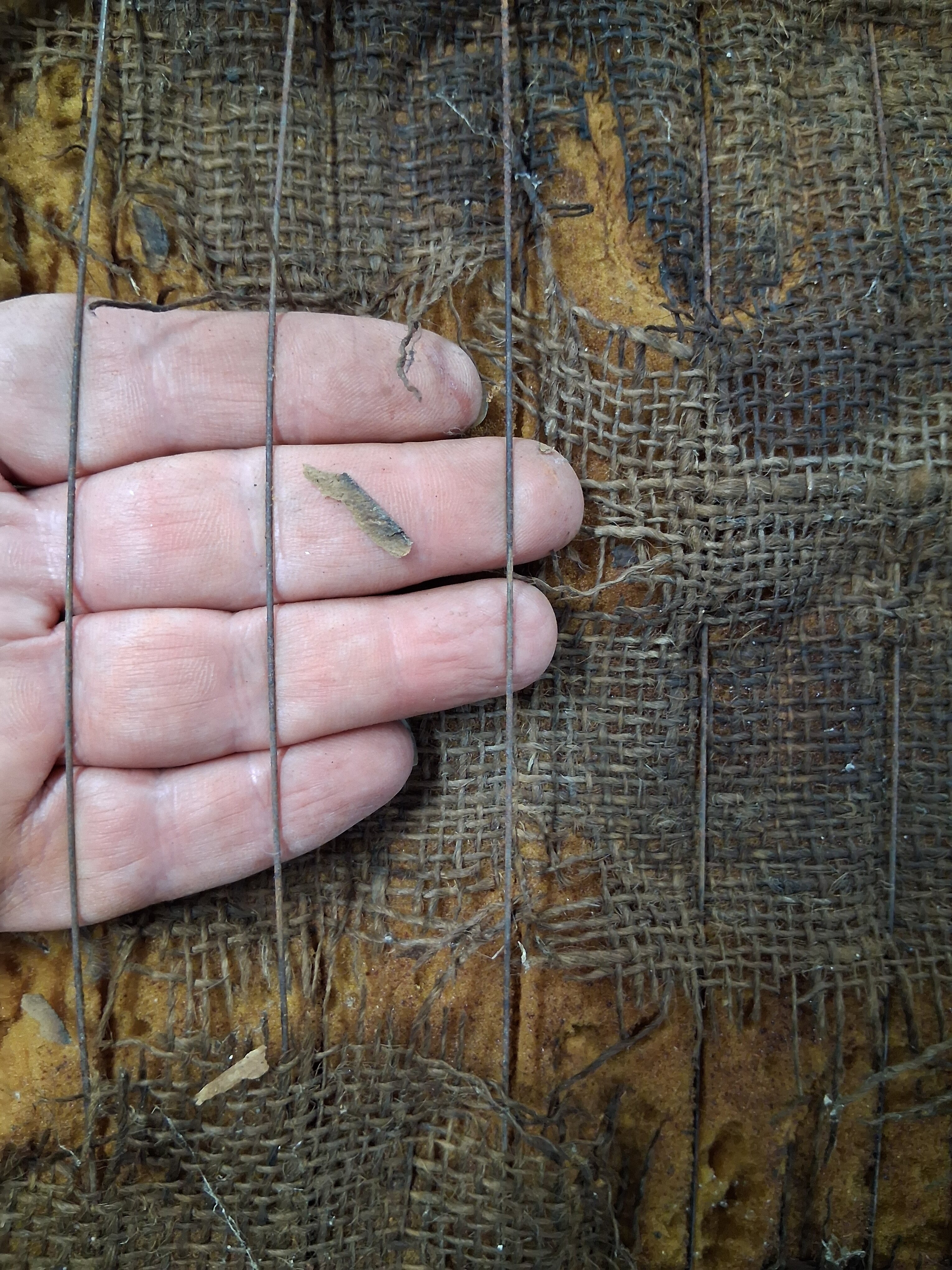

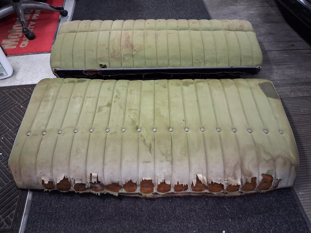

Bigfeetny Posted August 20 Posted August 20 So I have learned that a Chevelle rear seat will not fit a 1971 Monte Carlo, yes I'm using my Chevelle as a donor vehicle. I have striped the seats, however there are fine metal rods through the burlap. They are toast!! How important are they, and can they be replaced? Thanx Quote
cny first gen 71 Posted August 20 Posted August 20 I don't remember mine having them in there. I did put new burlap and also used canvas on them too. I did put extra springs in drivers side front seat too, that helped a lot. I did think the Chevelle frames were the same though. Hog rings are a real pain get a good set of hog ring plyers not a cheep set. 1 Quote
cny first gen 71 Posted August 20 Posted August 20 54 minutes ago, Scott S. said: Is it a 4 door Chevelle ? Oh I didn't think of that Quote
FrankOC Posted August 21 Posted August 21 A 68 Chevelle doesn’t have full arm rests that extend to the floor in the back if I remember correctly so the rear seat is wider. Quote
Bigfeetny Posted August 21 Author Posted August 21 14 hours ago, FrankOC said: A 68 Chevelle doesn’t have full arm rests that extend to the floor in the back if I remember correctly so the rear seat is wider. 19 hours ago, Scott S. said: Is it a 4 door Chevelle ? It is a 2 door. The interiors I have came from a 68 & 69, back in the day when they were a dime a dozen. I will measure the second one to see if it is different. The seat I measured was wider. 3 Quote
Canuck Posted August 22 Posted August 22 On 8/21/2025 at 9:23 AM, Bigfeetny said: It is a 2 door. The interiors I have came from a 68 & 69, back in the day when they were a dime a dozen. I will measure the second one to see if it is different. The seat I measured was wider. 1970-72 Chevelle seats fit. I believe the 68-69 had a different rear seat and armrest. 1 Quote
Bigfeetny Posted August 24 Author Posted August 24 On 8/22/2025 at 3:12 PM, Canuck said: 1970-72 Chevelle seats fit. I believe the 68-69 had a different rear seat and armrest. That is what I learned. Back to redoing the original seats. Quote
