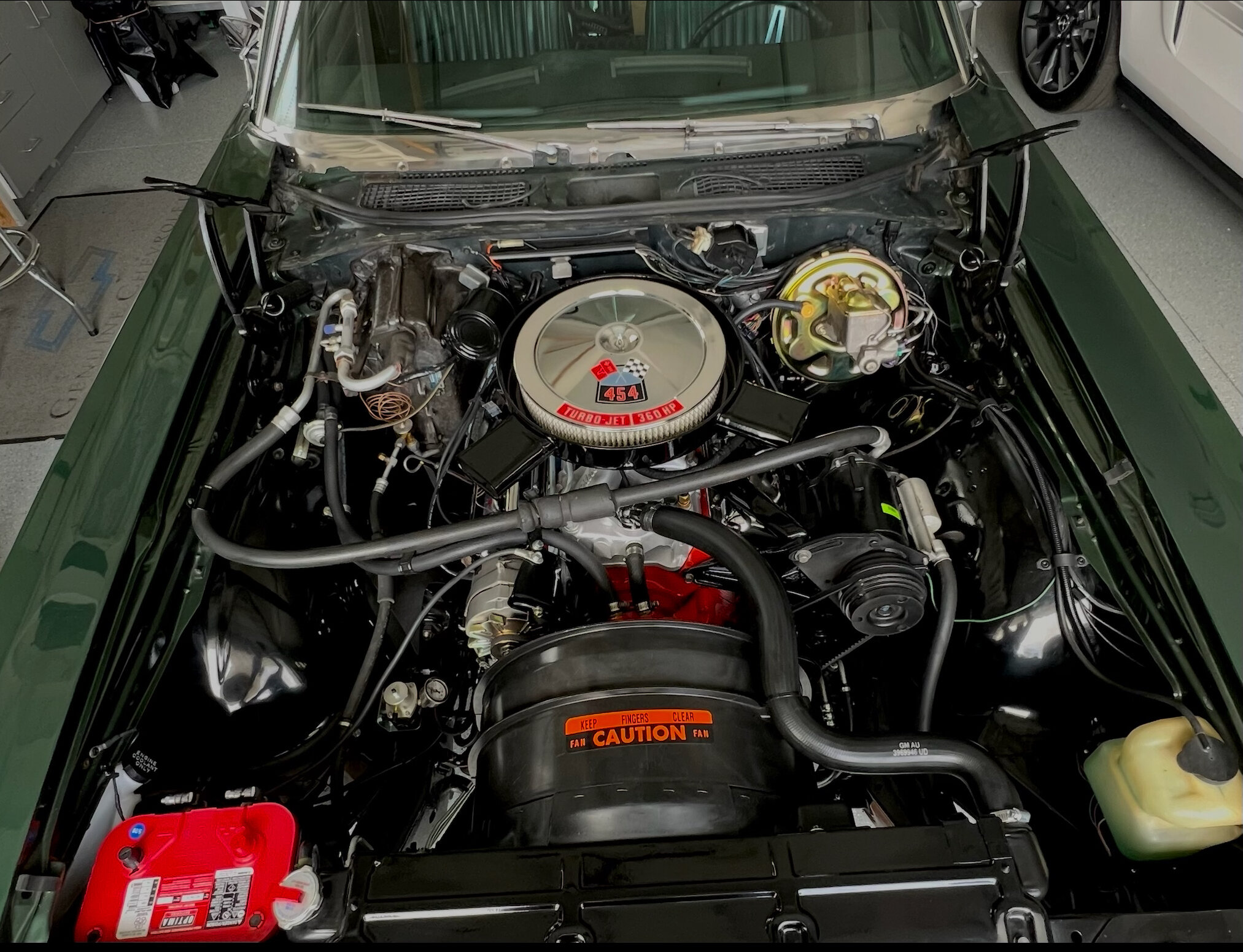

I think it was like a 73/74 nova. A lot of us tucked the on the passenger side of the battery inside the fender so you can barely tell that they are there.
