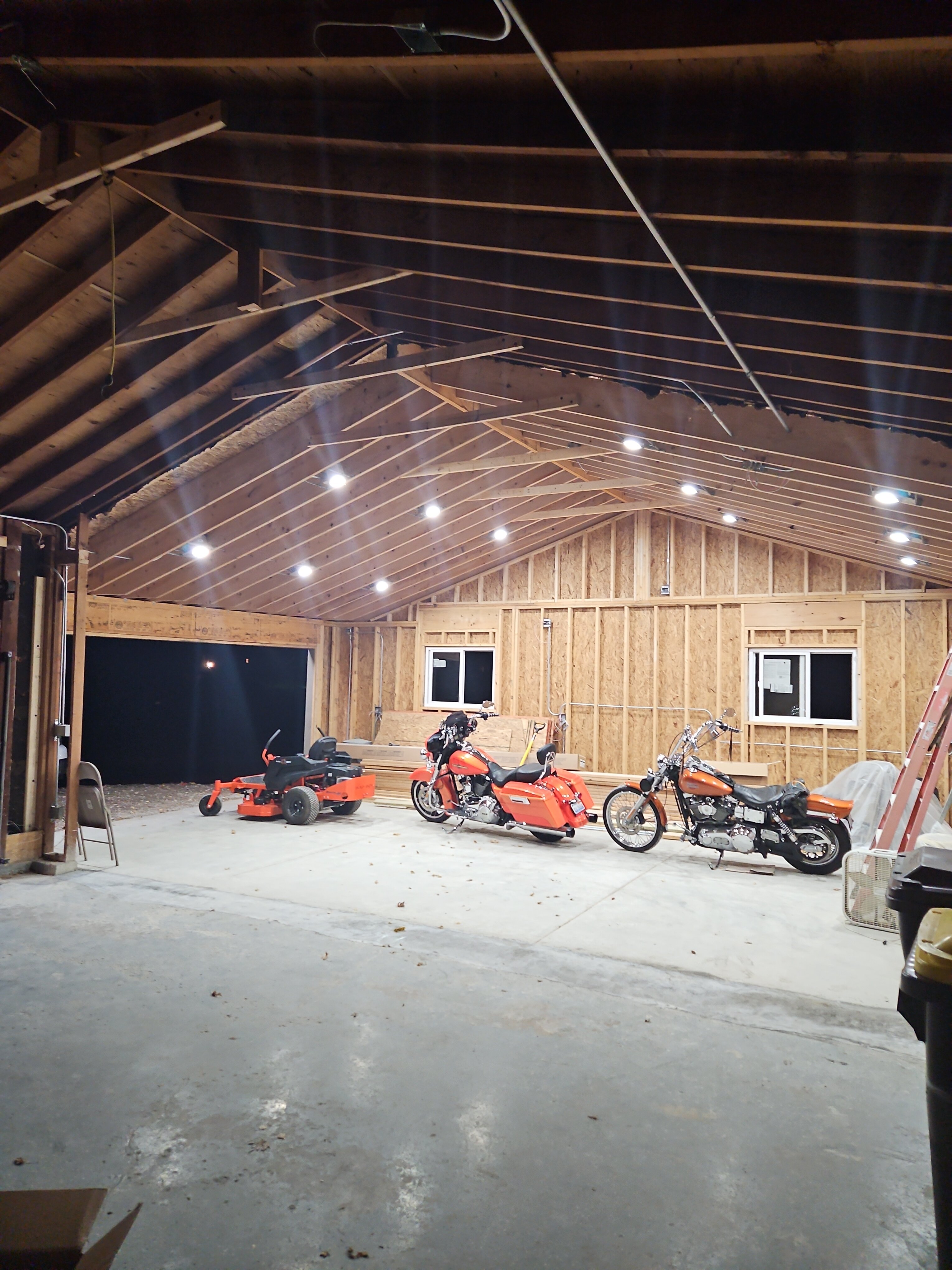

jbird72 Posted yesterday at 02:27 AM Author Posted yesterday at 02:27 AM 1 minute ago, Marks71 said: I’ve got the Bendpak HDS14X. It’s not bolted and rock solid. The Monte is the heaviest vehicle I’ve put on it, which is less than a third of its rated capacity. I’d probably bolt it down if I was lifting over 10000# which is never going to happen. If you’re considering a 2 post, how thick is your floor? Brand new garage edition. Like 6 in plus 4500 psi concrete and heavy rebar ..been planning this. Also vaulted ceiling so mid is 12 ft ..and garage door angles up not low 2 Quote

Marks71 Posted yesterday at 02:53 AM Posted yesterday at 02:53 AM I paid around 7 for it about 4 years ago with the caster kit and a couple other options. Everything has gone up a lot. Nice building. You’re right on the 2 post if you’re doing brakes or suspension work, or even separating the body and frame. In about 2 months or so I’m ordering a rolling bridge jack for my lift. This will add some versatility. Living in California with “the big one” always around the corner, I’d never use it for storage. I park the Monte on it which offsets the space it takes up, but it’s always down. 1 Quote

jbird72 Posted yesterday at 03:14 AM Author Posted yesterday at 03:14 AM 7 minutes ago, Marks71 said: I know it’s overkill but I’ve got an 84 GMC crew cab dually so I needed 20’ on the length plus the extra width, which forced me into the 14000#. The truck is probably around 6400#. Gotcha. ....better over kill than not...i love me a square body btw. Gmc made i wanna say 1989 right before thy stopped the square body. Wich had the newer interior with double lights ...think that was like a half year deal. Hard to find them any way found a halo 10000 lb 2 post 129 inches wide only. Seams to be the one ill go with great reviews..the building isnt as big as looks the half were lift is goin is 18 ft gar door and 20 ft wide unless angle in a second vehicle. Thats why hopin 2 post cause only one post be in way. Thats the theory anyway. Quote
Marks71 Posted yesterday at 03:32 AM Posted yesterday at 03:32 AM Sounds good. Your lift should come with the anchors. If possible try to get 5” of embedment in the floor which will depend on how thick the plate on your lift is. It’s very important that you don’t accidentally drill through the concrete and expose the anchors to the soil beneath. If they supply 6” anchors then you may only end up with around 4”. Quote
