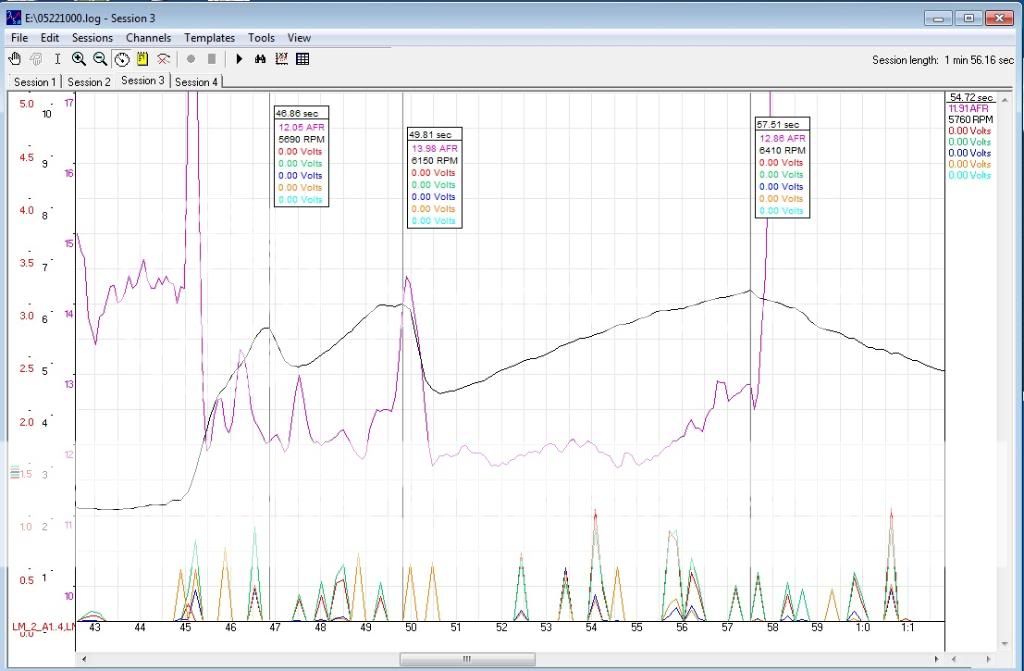

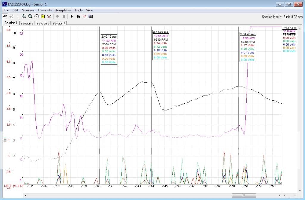

Winston Wolf Posted May 17, 2010 Author Posted May 17, 2010 Thanks for those articles. I had stumbled across them. Looking more at my dyno sheets, looks like peak HP is 385 and the peak is long, from 5400 to 6000, then drops hard after 6250. In this article Edelbrock manifold testing, ported vs stock They are seeing the ported RPM air gap at 6400 rpms down only 4 hp from the ported victor jr and more power all over than an as-cast victor. I feel getting this monster rolling off the line is going to ET faster than trying to scream it at the end of the quarter. Plus, I just don't think giving up the 20 HP at 3800 RPM is going to make it fun on the street. My biggest conflict is that as you roll on that throttle going 60 mph you want it to move. It's still only running 2500 at 70 with the converter locked... It's going to be a battle of compromise, but I'm leaning towards porting a RPM air gap, and running the 3/8" open heat spacer to even it out. I don't have any more room than that, a 1" spacer won't fit with the 4" element. Quote
Winston Wolf Posted May 23, 2010 Author Posted May 23, 2010 Well, Got to Wisc today to test out the new stuff. Not too impressive. Best time of the day with the new engine was a 12.04 @ 113.5 Best time on the other heads/cam was 12.02 @114.06 I did have one run that would have been in the 11's, but the timer did not record my 1/4 mile et or speed. That was a 7.673 @ 90.54 1/8th with a 1.701 60 ft. Drag strip doesn't lie, I had more power before. The new converter did help a little on the 60 ft times. I was averaging 1.73ish and before it was almost 1.8's with the 2400 stall. Played with the timing. Looks like it wants 37 deg. I am assuming this is from the lower compression. I am still getting a miss on the top end, the same as with the other combo. I'm thinking it may be in the distributor, I'm just not sure. You will be able to hear it on the video below. On the last run it is really noticable. That is the 12.04 run. As I think back, I have fighting it on and off for years. I don't think it valve springs anymore. The car actually ran so terribly on the first run, I couldn't believe it. Seemed like it missed in every gear. Ran a 12.356 @ 110.76 You will also see the logs from a few runs. I can't seem to get this Edelbrock carb to put down a good a/f curve. I am done fighting it. I also see some leaning out at the top end rpms. I'm crossing my fingers that it is my fuel pump setup and stock lines. The trans is still giving me a bit of fits too. I'm having a tough time getting my lockup timing correct. You will see some flat spots in the revs on the charts, that is the converter locking up. Everything happens so fast, it's tough to shift, lock up conterter, shift all in a second, I'm still working on that. I guess the bottom line is I will be blowing some more cash this week: new intake, carb, distributor, fuel pump, and lines. For those who haven't see logs before, the top line is the RPM's during the run and the bottom line is the air/fuel ratio. Quote
