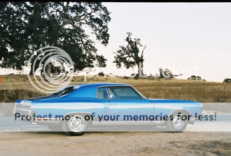

Here are some pictures of my and monte420's I believe her exhaust is stock. 003-15.jpg Now my on the other hand you only see the headers and in the rear wheel well 2.5" exhaust. 010-5.jpg008-6.jpgd9f5d083.jpg Are your tail pipes on the rear hanger at the rear?
