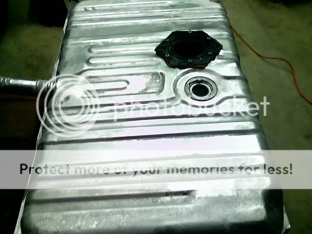

As for the tank you can run an extrenal fuel pump but I would recommend an in-tank pump with baffels. Some people use the B Body tanks from late Caprices, Road Masters etc, but that requires some trimming on the frame and cutting the trunck floor.You can get an after market tank with the baffles and pump but they are not cheap. There is also a shop that makes an retro-fit option, look up tanks.inc for that one. Me I took the tanks inc concept and madified my tank awith some parts I traded.

Here is how I modified my tank;
The pump setup is actually out of a Turbo couple T-Bird.
And here is a shot of mine.
