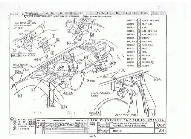

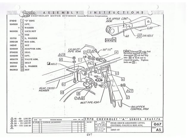

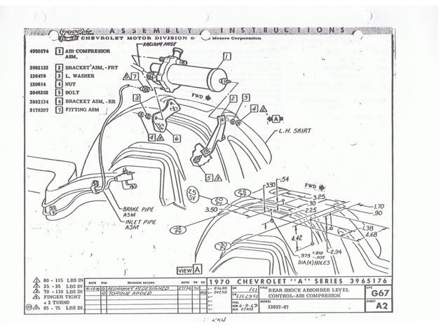

Pic # 1 air ride pump....
Pic # 2 air ride rear end details..
Pic # 3

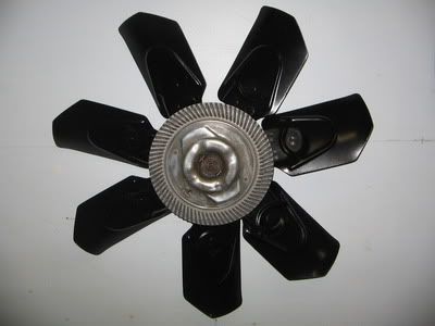

anyone know what the correct fan is for the 454 I found three in my part boxes Im also missing the fan clutch I'm assuming these cars had the clutch.Also in the boxes were two rochester quadrajet carburetor how would I identify the correct one.

I believe my stock fan is 7 blades and it does have a clutch.

Hey Al, Jake is right it is a 7 Blade and is suppose to look like this in the picture with the clutch as well, My part number ends in 772 and it is 17-7/8ths across or 18 inches for all intense purposes I guess....

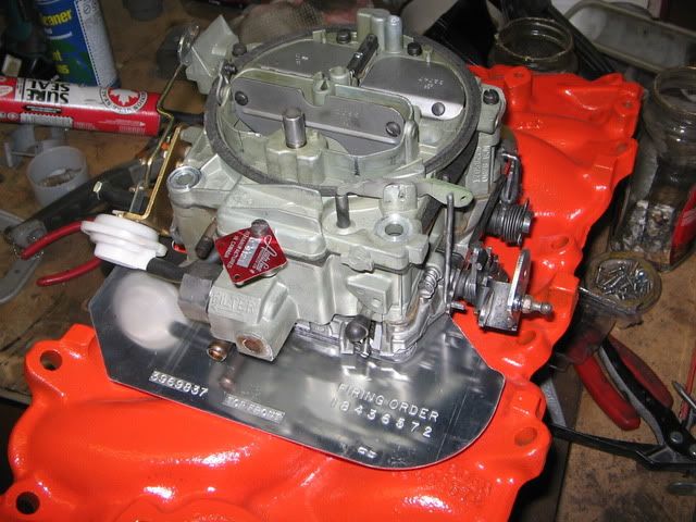

and also as well Aaron related to the Carbs. it will denote the date as he mentioned and where to find the numbers...It will also let you know in the numbers if it is for a Automatic Car or a 4spd Car too...on the right hand side on the Back Flank by the throttle linkage there sideways...this is the one out of my 454 car..

The two quadrajets used on 1970 SS454's were 7040200 and 7040500.
The only difference being where the car was built. Since emissions started in California in 1970 and then spread to rest of country in 1971, any car built in Van Nuys plant had a different Carburetor than the rest of the country due to emissions.
7040500 was the Rochester Quadrajet code for a Van Nuys built car
7040200 was the code for the rest of the country.
