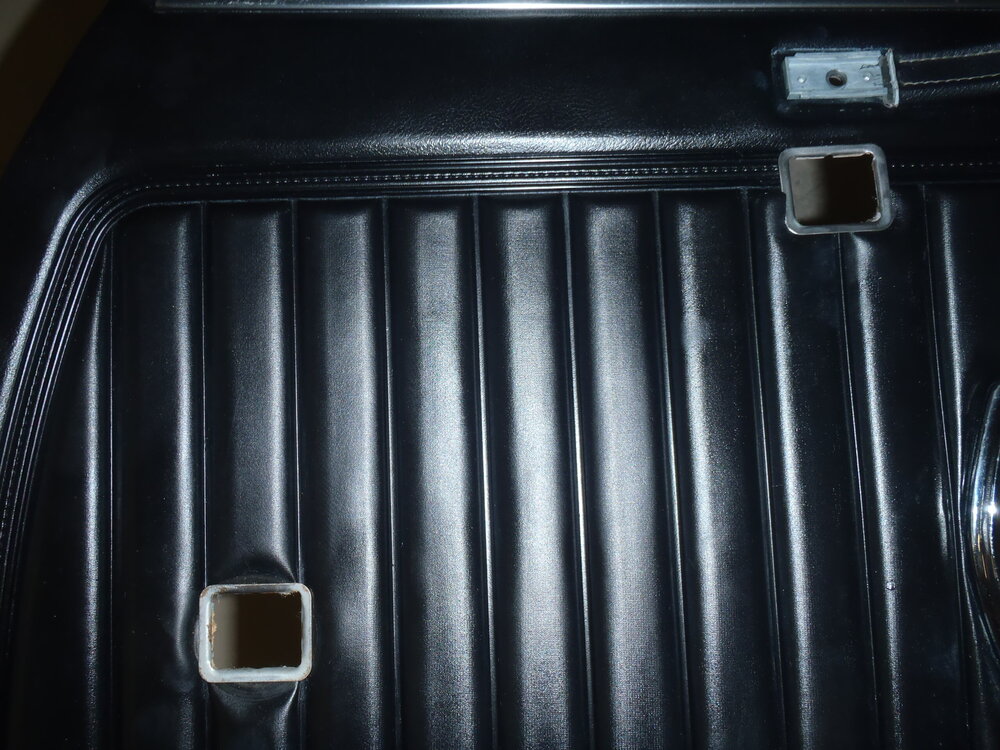

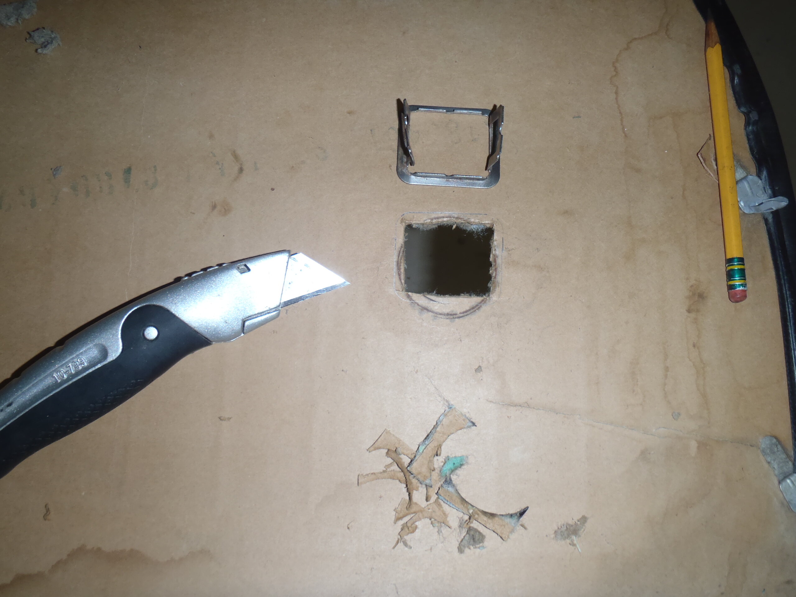

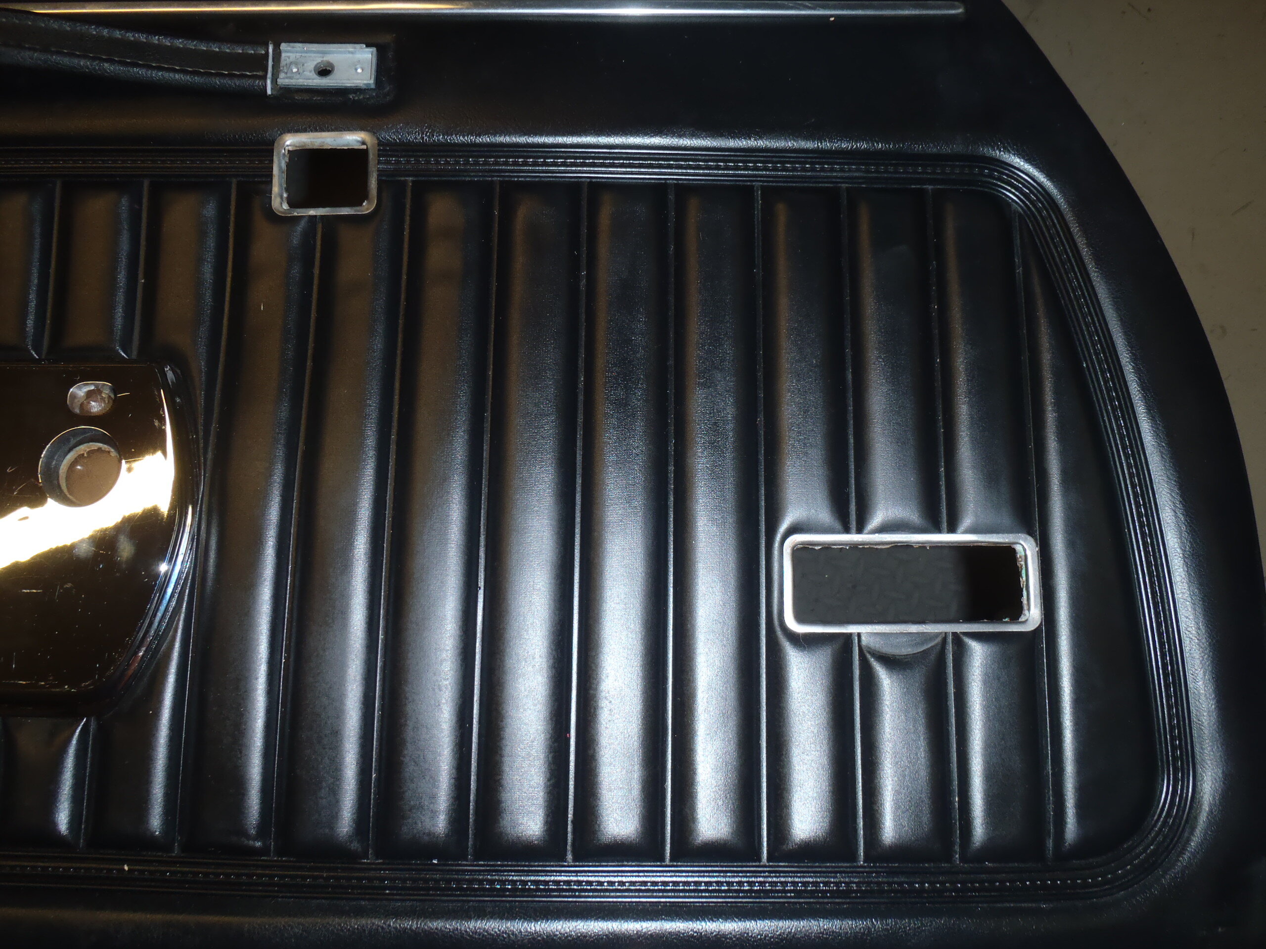

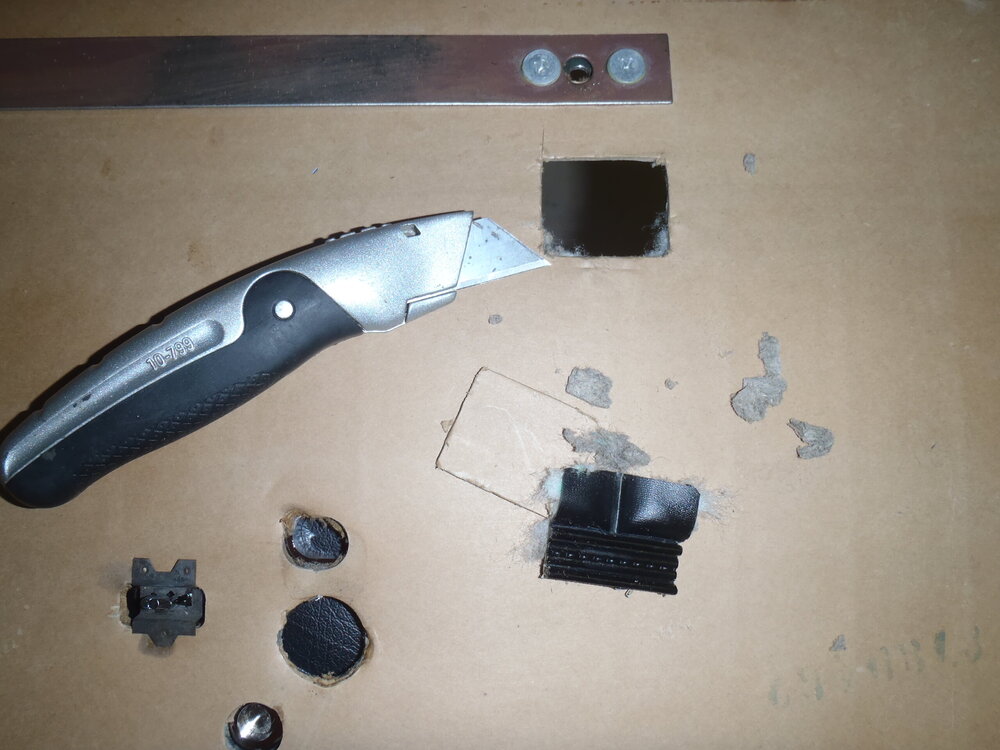

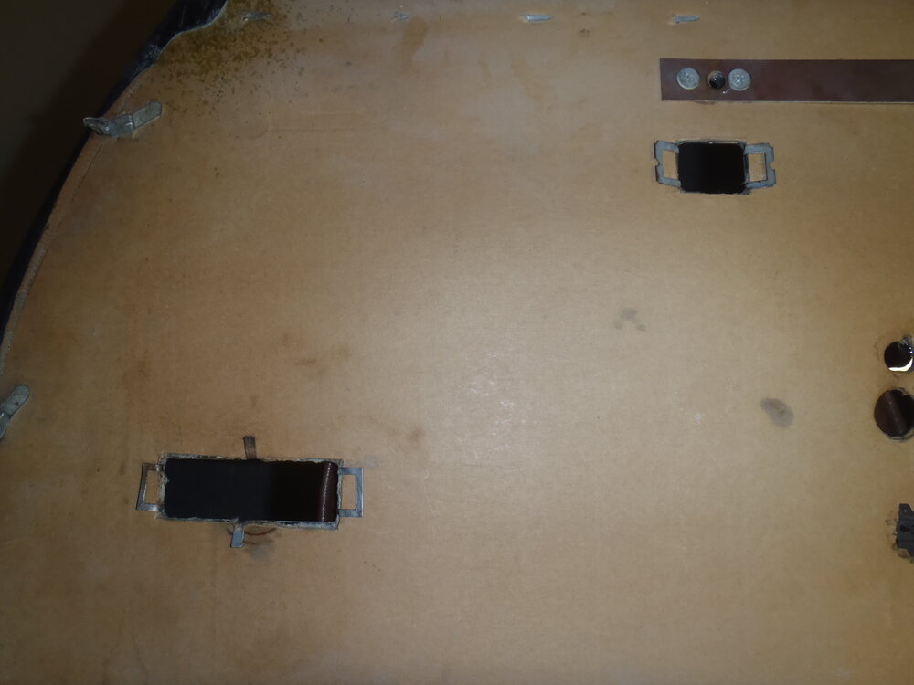

Bad Wolf racing Posted March 2, 2022 Posted March 2, 2022 Quick question, if I decide to change from manual to electric window / locks on my 72, would I need new door panels or do the switches go in the same location as the manual window crank? I just replaced my door panels but have been thinking that mayyyyybe I should have gone with electric... Quote
MC1of80 Posted March 2, 2022 Posted March 2, 2022 The power window switches are in the same place as the manual cranks. On the back of your new door panels should be the marks where you would cut for the window switches to square out the round manual holes and the outline of where the power lock switch should go. I know they were marked out on my legendary panels. Quote
jft69z Posted March 2, 2022 Posted March 2, 2022 I converted my old Monte years ago from manual to power, no big deal as Tom said. The square switch covered up the round holes just fine. 1 Quote
MCfan Posted March 3, 2022 Posted March 3, 2022 The power window and power door lock switch locations were also marked on the inside of my original '70 door panels when I converted from manual systems ten years ago. Just cut out the square (or rectangular) holes where indicated and install the switch housings in your door panel, the switches will then snap into the housings. Easy peasy ... 1 Quote
