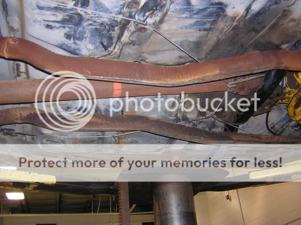

Monte7071 Posted June 14, 2012 Posted June 14, 2012 Glad you asked. I have wondered this myself my 71 SS has what looks to be pink or light red on it. My car was built in Van Nuys.
LS5 Posted June 15, 2012 Posted June 15, 2012 Hey Shawn it shows Pink and Blue for the SS 454 LS-5 car in Van Nuys and Joseph's to be Blue and Black for a TH400 and Brown and Pink for TH350 cars... Maybe that BK Joseph is suppose to be a PK ???? Darren.
Monte7071 Posted June 15, 2012 Posted June 15, 2012 I dont remember seeing blue but never looked real close here is a picture of the drive shaft.
